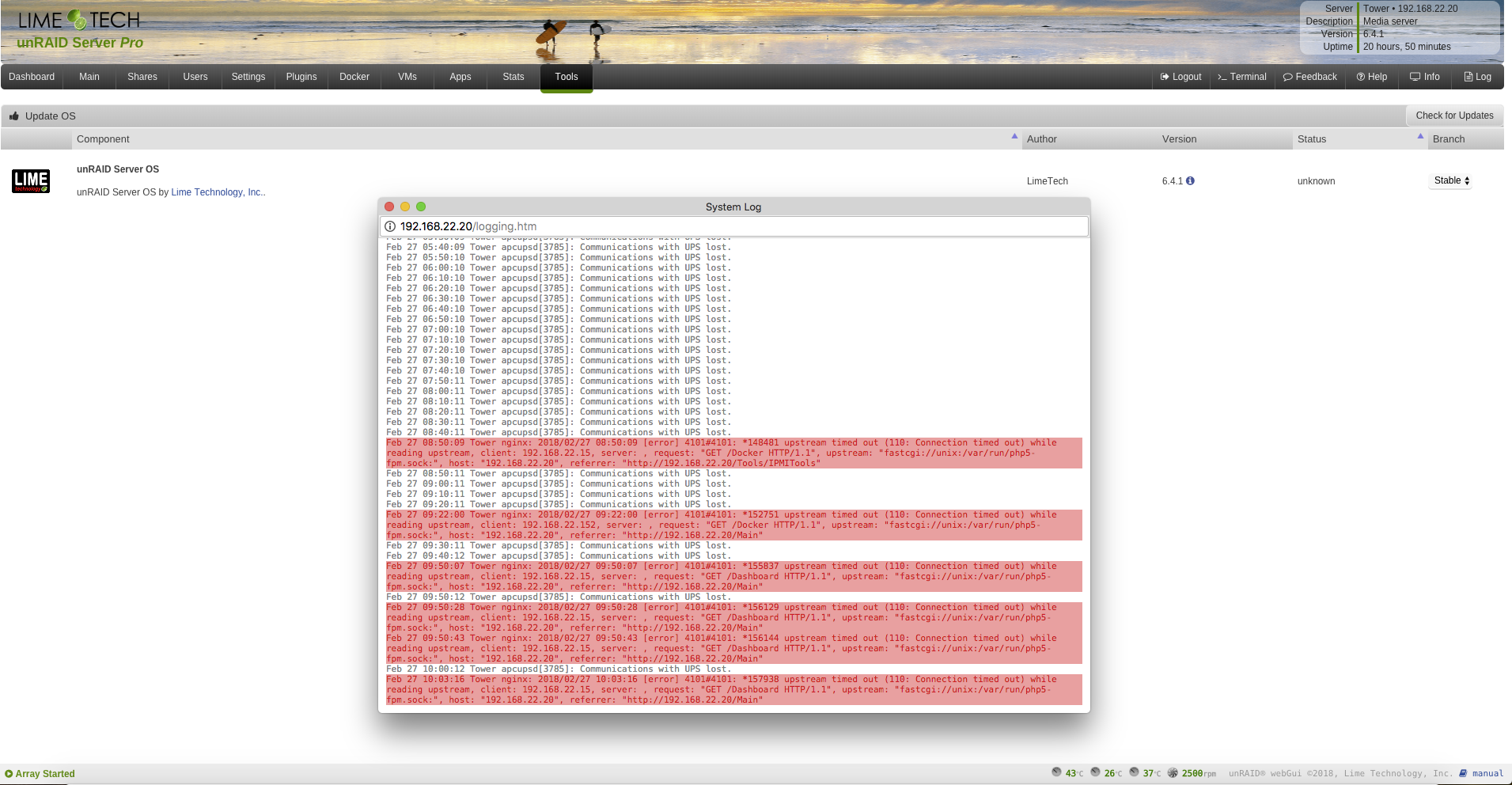

Restored USB cable for UPS, and below it would appear to be an issue with timeout... but only on the tabs listed above... everything else functions correctly.

Feb 27 10:27:35 Tower nginx: 2018/02/27 10:27:35 [error] 4101#4101: *165349 upstream timed out (110: Connection timed out) while reading response header from upstream, client: 192.168.22.15, server: , request: "POST /plugins/community.applications/include/exec.php HTTP/1.1", upstream: "fastcgi://unix:/var/run/php5-fpm.sock", host: "192.168.22.20", referrer: "http://192.168.22.20/Apps"
Feb 27 10:27:41 Tower emhttpd: req (4): csrf_token=****************&title=System+Log&cmd=%2FwebGui%2Fscripts%2Ftail_log&arg1=syslog
Feb 27 10:27:41 Tower emhttpd: cmd: /usr/local/emhttp/plugins/dynamix/scripts/tail_log syslog
Feb 27 10:27:42 Tower sSMTP[22896]: Unable to locate smtp.gmail.com
Feb 27 10:27:42 Tower sSMTP[22896]: Cannot open smtp.gmail.com:465
Feb 27 10:28:19 Tower emhttpd: req (5): csrf_token=****************&title=System+Log&cmd=%2FwebGui%2Fscripts%2Ftail_log&arg1=syslog
Feb 27 10:28:19 Tower emhttpd: cmd: /usr/local/emhttp/plugins/dynamix/scripts/tail_log syslog
Feb 27 10:32:04 Tower nginx: 2018/02/27 10:32:04 [error] 4101#4101: *166577 upstream timed out (110: Connection timed out) while reading upstream, client: 192.168.22.15, server: , request: "GET /Docker HTTP/1.1", upstream: "fastcgi://unix:/var/run/php5-fpm.sock:", host: "192.168.22.20", referrer: "http://192.168.22.20/Settings"
Feb 27 10:59:07 Tower emhttpd: req (6): cmd=/plugins/dynamix.plugin.manager/scripts/plugin&arg1=checkall&csrf_token=****************
Feb 27 10:59:07 Tower emhttpd: cmd: /usr/local/emhttp/plugins/dynamix.plugin.manager/scripts/plugin checkall
Feb 27 11:09:20 Tower emhttpd: req (7): csrf_token=****************&title=System+Log&cmd=%2FwebGui%2Fscripts%2Ftail_log&arg1=syslog
Feb 27 11:09:20 Tower emhttpd: cmd: /usr/local/emhttp/plugins/dynamix/scripts/tail_log syslog
Feb 27 11:09:22 Tower nginx: 2018/02/27 11:09:22 [error] 4101#4101: *177267 upstream timed out (110: Connection timed out) while reading response header from upstream, client: 192.168.22.15, server: , request: "POST /plugins/community.applications/include/exec.php HTTP/1.1", upstream: "fastcgi://unix:/var/run/php5-fpm.sock", host: "192.168.22.20", referrer: "http://192.168.22.20/Apps"
Feb 27 11:10:22 Tower nginx: 2018/02/27 11:10:22 [error] 4101#4101: *177687 upstream timed out (110: Connection timed out) while reading response header from upstream, client: 192.168.22.15, server: , request: "POST /plugins/community.applications/include/exec.php HTTP/1.1", upstream: "fastcgi://unix:/var/run/php5-fpm.sock", host: "192.168.22.20", referrer: "http://192.168.22.20/Apps"

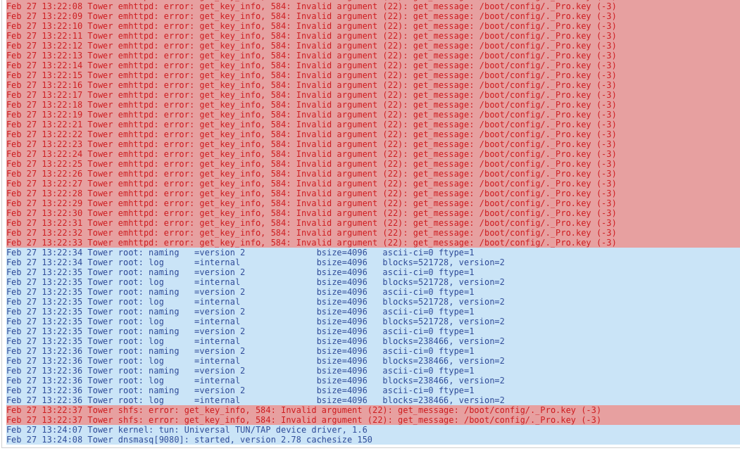

this is border line comical... are the logs now telling me my registration key isn't valid?
Diagnostics area for registration says it's registered... so now outside of the dashboard and docker tabs not working, I'm not sure what is going on.
