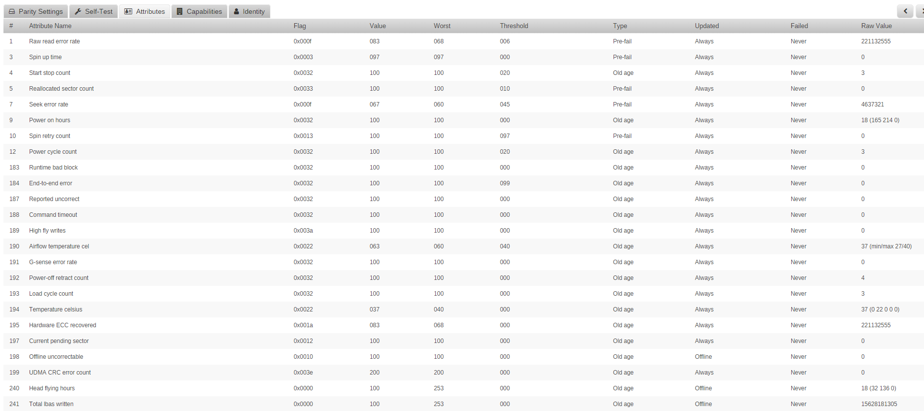

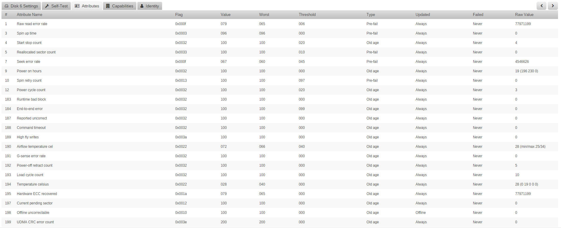

Both of these drives are brand new yet have huge numbers for raw read error rate????  Is this normal / a by  product of adding a new drive? I find it unlikely that both drives are bad  (2 days old)

raw value for that attribute is useless for Seagates.

The most important SMART Attributives which are setup for automatic notification are #5, 187, 188, 197, 198, and 199.  Occasionally, you may get an attribute that says:   FAILING NOW.  Obviously, you should attend to that as soon as possible.  Google and/or a post to the forum would be your friend.  The others can be pretty much ignored...

On 2/28/2018 at 1:09 PM, pyrater said:
I would draw your attention to the 3 columns named "Value", "Worst", "Threshold" in your screenshots above.
These are called "normalized values".
The Value is the current normalized value.
The Worst is the lowest (worst) value the attribute has ever been at.
The Threshold has nothing to do with your specific disk. It is the level at which the drive itself will start reporting it is failing.
If you look at the smart reports, the raw read error rates show
        Value  Worst Threshold
D1:     79      65        6
D2:     83      68        6
So this means both disks have gone down into the 60s, but it isn't until they get down to 6 would the drive would consider itself failed.
Generally the nominal "normal" is 100. These are below that. But every manufacturer and even model has different rules, and your values of 79/83 for value and 65/68 for worst might be perfectly normal for these disks.
My experience is that the smart values themselves are not that useful. It is really the delta in smart values that are interesting. For example, if you told me that 2 days ago, the value was 100 and worst was 98, and now the value is 79 and worst is 65, I'd be concern with a rapid drop and closely monitor. If you kept this as a baseline and looked at the attributes from time to time for sudden drops, you would be able to more closely track the health of the drive across the various attributes.
The attributes Frank mentions above are the ones we typically associate with failing drives. And we look more closely at the Raw values than the normalized ones for those specific attributes. And we are pickier than the drive manufacturers when some of the Raw attributes start to increment.
Hope this helps.
Enjoy your array!
