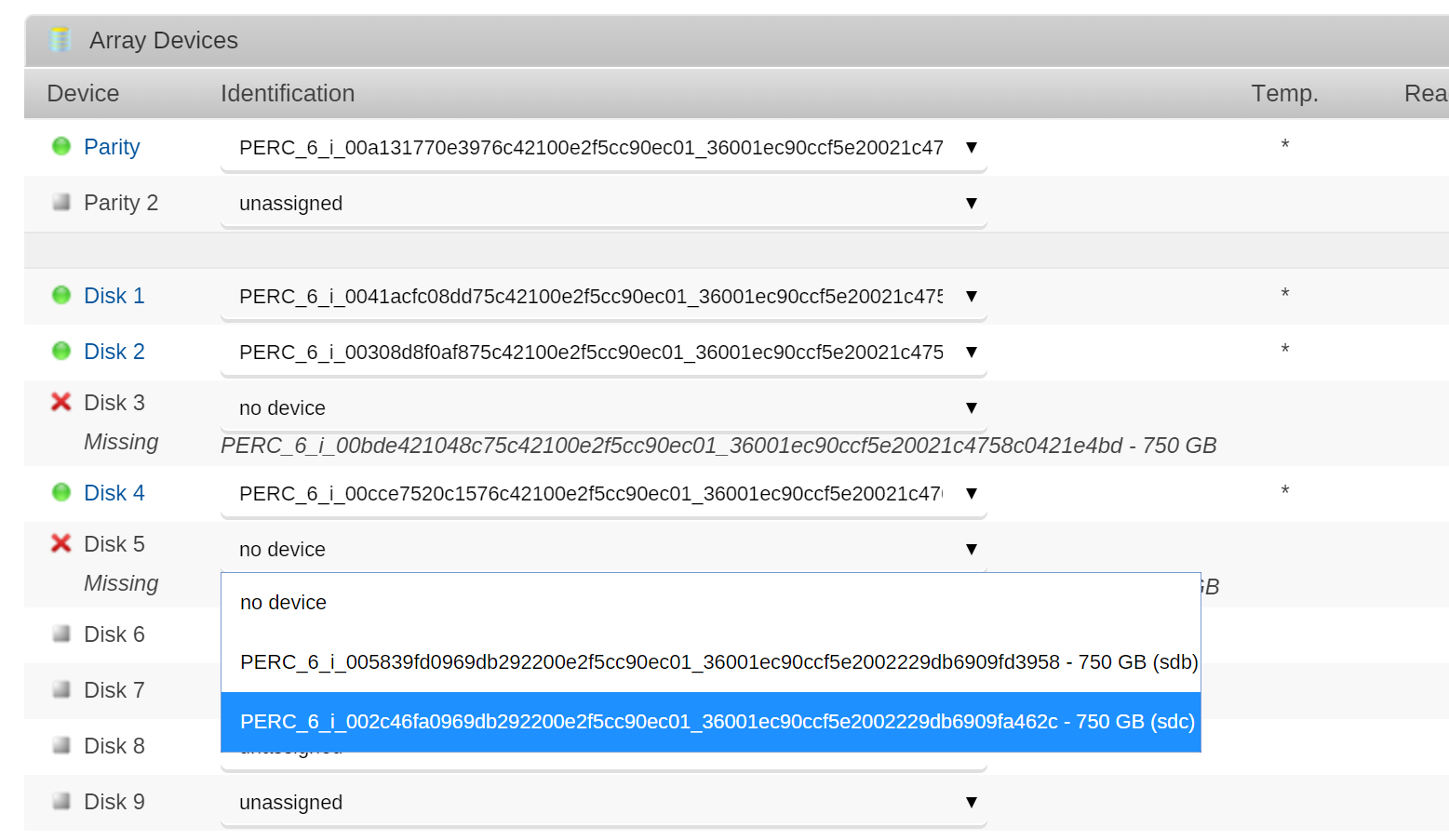

Thanks for answering so quickly, work got busy and I haven't had time to look at this till now. Attached are the 2 things you asked for. I went into the raid controller and named the VD but that name is not present in unraid. As you can see it assigns them random names. You can see the full name of one of the missing disks and the new names for both the disks I took out. Since they do not line up I assume my best shot here is to take the 50/50 chance, do a new config, and guess at where those 2 drives go. If I guess wrong will it just error out and I can do another new config with the 2 drives switched or will it automatically start overwriting?

Since it's 2 data drives and you're using single parity disk order isn't important, so you can just do a new config, keep all assignments and just assign the new disks to the missing slots, then check "parity is already valid", as long as the raid firmware didn't touch the data they should mount normally, you should still run a parity check after.
All good to go. Thanks for walking me through that. Where is your donate button?
