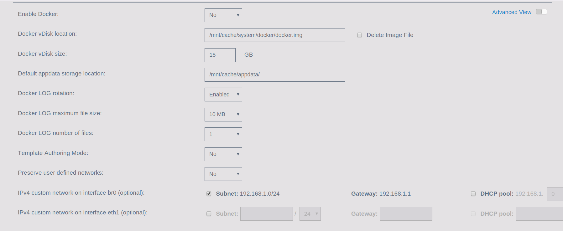

I just updated my main server and now I can't specify br0 on dockers to set the IP address.  How do I do that now?

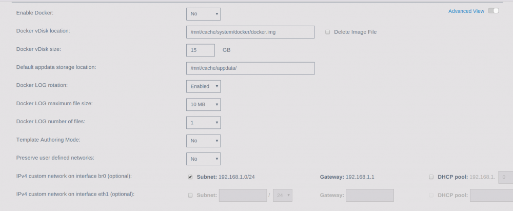

Can you post a screenshot of the Docker settings page (with Docker stopped and advanced on)
Here you go:
br0 never shows up in the docker network choices.
Looks like it failed to create 'br0' under Docker. A quick workaround is:
rm /var/lib/docker/network/files/local-kv.db
/etc/rc.d/rc.docker restart
For my understanding: did you make any setting modifications or it failed right away after upgrading?
local-kv.db does not exist.
I updated with the array not starting on reboot, made some changes to the network gateway address, then started the array.
That's weird. Docker creates this file immediately after it is started (if not present). It holds all docker network assignments.
If you do a "rc.docker restart" from CLI, still this db file isn't there?
Can you post your docker.cfg file, it is under /config on your flash device.
I rolled back and now 6.4.1 has the same problem.  What do I need to do to get out of this problem on either version?
With docker started :)
I decided to stay on 6.5.0 and sort through this issue.
10 minutes ago, bonienl said:
rm /var/lib/docker/network/files/local-kv.db /etc/rc.d/rc.docker restart
This did not resolve the problem.
docker.cfg:
DOCKER_ENABLED="yes"
DOCKER_IMAGE_FILE="/mnt/cache/system/docker/docker.img"
DOCKER_IMAGE_SIZE="15"
DOCKER_APP_CONFIG_PATH="/mnt/cache/appdata/"
DOCKER_APP_UNRAID_PATH=""
DOCKER_AUTHORING_MODE="no"
DOCKER_LOG_ROTATION="yes"
DOCKER_LOG_SIZE="10m"
DOCKER_LOG_FILES="1"
DOCKER_CUSTOM_NETWORKS="eth1"
DOCKER_USER_NETWORKS="remove"
Appreciate the help.  I need to get my ownCloud working.
Try to add br0 manually
docker network create -d macvlan --subnet=192.168.1.0/24 --gateway=192.168.1.1 -o parent=br0 br0
That did it.  Is this a bug, or is it my setup?
I am not sure what went wrong for you. For me it is working and can't reproduce this error.

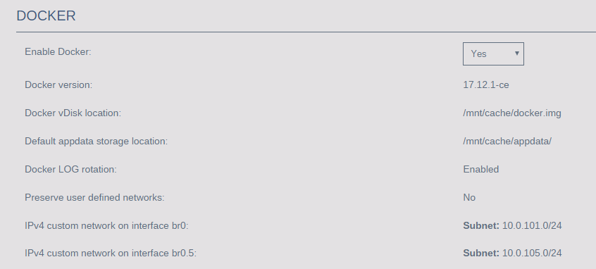

root@vesta:~# docker network ls
NETWORK ID          NAME                DRIVER              SCOPE
24d7006fca22        br0                 macvlan             local
a55a2930f25f        br0.5               macvlan             local
09e57f65a472        bridge              bridge              local
2e0d5b0ce86b        host                host                local
5b5cd0378f3a        none                null                local
On my test server.
