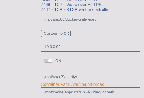

2 hours ago, dlandon said:
That did it.  Is this a bug, or is it my setup?
dlandon and myself went into closed debug session and found out that the root cause is a single host (/128) IPv6 assignment, which doesn't allow an IPv6 gateway to be set.
An update to the docker script is made to cope with this situation and will be available in the next release. If you have a similar issue as dlandon, temporary set "IPv4 only" for the interface as a workaround.
I updated my smaller server and use two dockers with br0 so they get their own ip and didn't have this issue...perhaps it was a corrupted docker config?
No.  It looks like my router is not handing out a proper IPv6 gateway address.  I've been messing with the latest Merlin firmware on my ASUS router, and I'm sure it has an issue.
