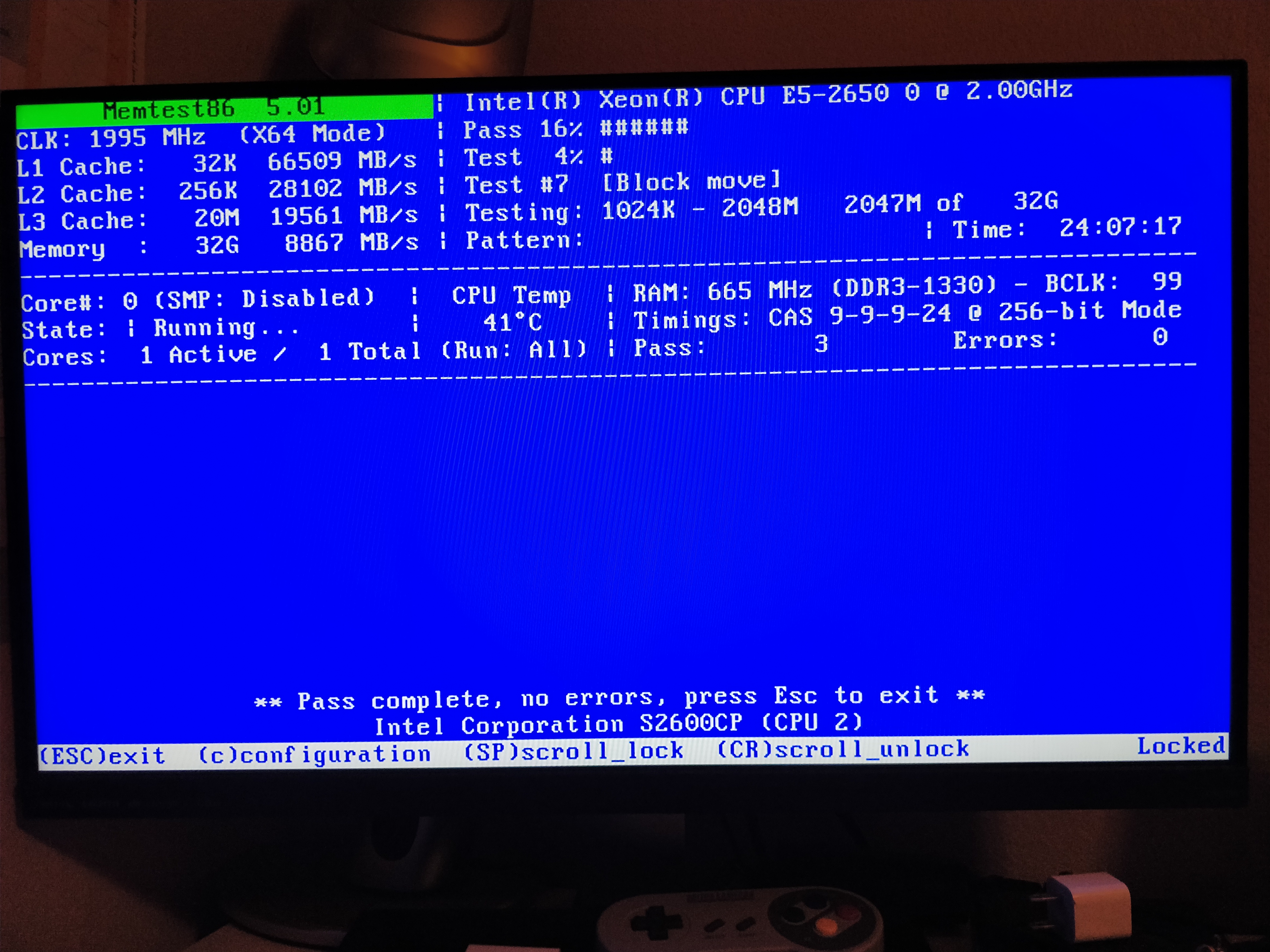

On 3/3/2018 at 4:58 AM, John_M said:
I'd give it at least 24 hours but I think it might well throw up some errors before then.
Well, this was genuinely surprising.  I was finally able to shut down the server and run MemTest86+ for 24 hours.  Not a single error (see screen shot attached).
Next steps?
Memtest won't detect ECC corrected errors, check the board's system event viewer in the bios/ipmi, it should have more info.
