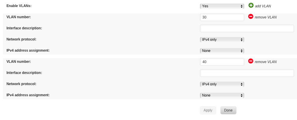

With this release you create your VLANs without IP assignment (see network settings), this prevents unRAID participating directly. Next on the docker settings page (with docker stopped and advanced view) you set the network assignments for each VLAN you want to use for your docker containers.
The above approach will allow a container to talk to the unRAID host system, but keep in mind that communication runs via your router and this device must ensure the proper routing.

I saw in settings how I no longer have to assign IP Addresses in the network settings (see picture below "network.png")

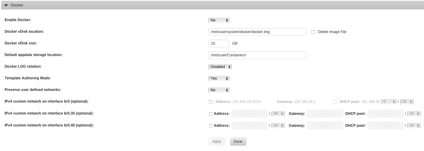

As far as the docker settings, I'm a bit confused. Do I want to enable custom networks or no? My goal is to have all of these containers behave like mini-VMs and work through the router and only live on unRAID. (see picture below "docker.png")
Thank you.
If you want to use VLAN 30 for your docker containers, you would need to enable it (br.30) under Docker settings and assign a network + gateway, optionally you can set a DHCP pool.
E.g.  address = 192.168.30.0/24,  gateway = 192.168.30.1,  DHCP pool = 192.168.30.128/25
The above will hand-out IP addresses 192.168.30.128 and up for containers with automatic assignments, or if you can specify a static IP address,  use 192.168.30.2  up to .127
Do the same for VLAN 40, but use a different network, e.g. 192.168.40.0/24
