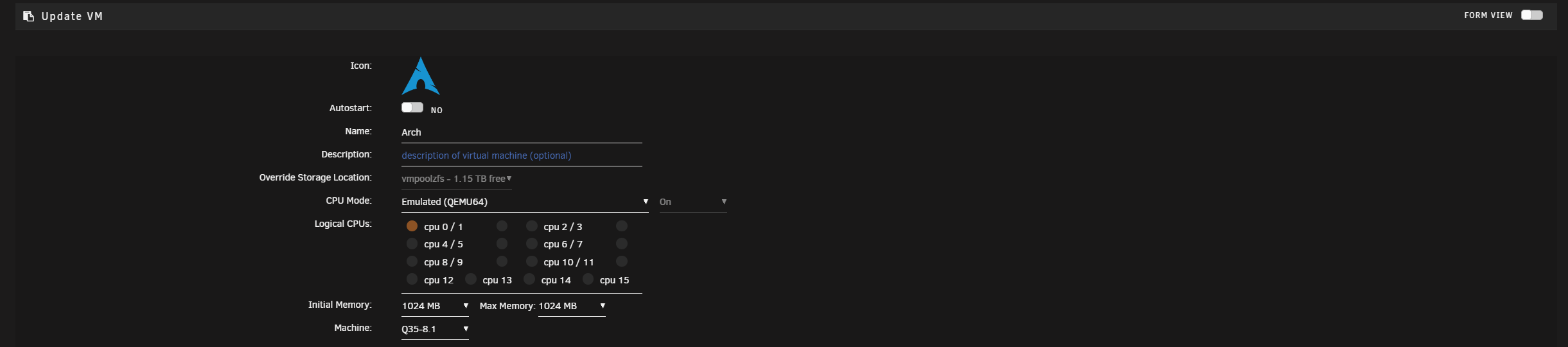

3 minutes ago, Farbod said:
Hi, Thank you for your response. I have the same issue here but I'm trying to install ubuntu on eve-ng. I'm getting the same error but I can't find any xml file. Can you please tell me where the xml file is?
Use the slider top right to change from Form to XML
Thank you. but is this eve-ng? I can't find such page.(sorry for being so noob)

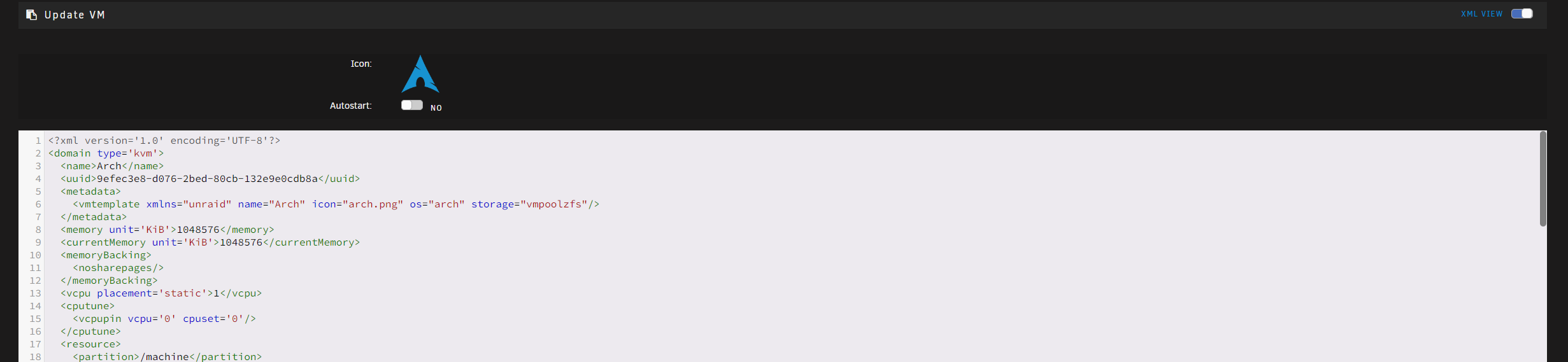

I had the same problem and finally figured it out. I had some trouble with the explanation in this thread earlier so I thought I would write it out so people could understand it better:
When you select a driver, it needs to run on a bus, and then a slot on that bus.  For virtual drivers, it should be running on bus=00x0.  Then each VM has a slot.  so if you spin up the 8th vm, it should get bus 00x0 and slot 0x08.  For whatever reason The VM can end up using/detecting incorrect PCI graphics bus for its VM Console video driver.  This can occur when you make a change a VMs video driver (Selecting QXL, Cirrus, passthgough, etc) or just by starting and stopping the vm, and creating a new one
So to fix it we need to edit the template of the vm.  the GUI does not show us these advance options, so we need to edit the xml file that the template is made from.  Right click you VM and select Edit.  On the edit page, select the "FORM VIEW" button at the top right, and toggle it to "XML VIEW".  Now you can edit the xml of the VM
Look for the <video> section of code.  You can see mine below, and for some strange reason it was on bus 0x08, slot 0x01.
<video>
      <address type='pci' domain='0x0000' bus='0x08' slot='0x01' function='0x0'/>
    </video>
I then checked the XML files of my other 2 VMs and they were set to
bus='0x00', slot='0x01'
And
bus='0x00', slot='0x02'
Which is accurate because the VM video driver should be on bus 0x00.  So I changed my xml for my non working vm to be bus='0x00', slot='0x03' (Giving it its own slot that is unused by the other Vms).  This solves the issue.
