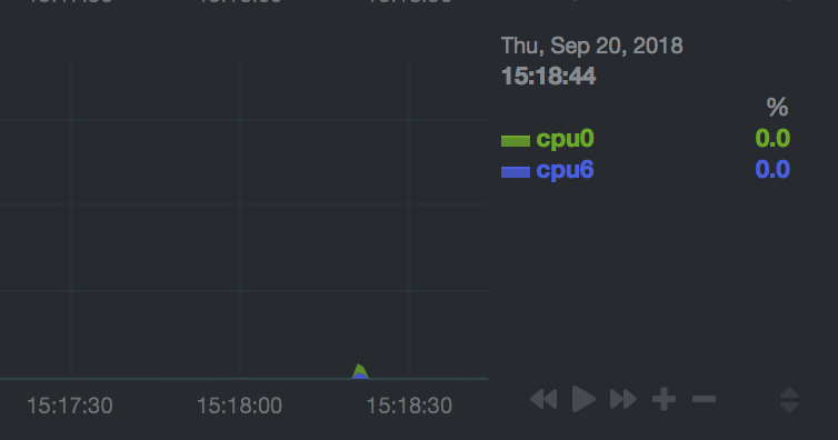

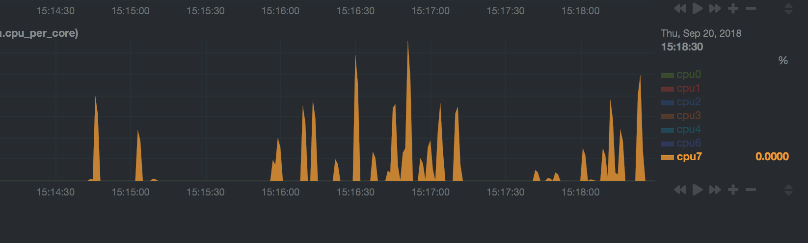

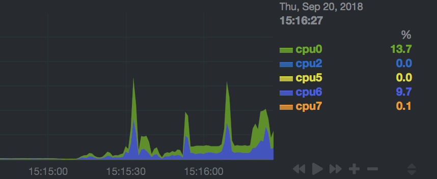

I have 12 threads, isolating 1-6,7-11, leaving 0,6.
netdata has has time on cpu 7 even though it shouldn't, and shows access to more cores than just 0,6
1065512207_ScreenShot2018-09-20at3_18_27PM.thumb.png.2dc444bae780a920408aaa6b5fbebe41.png
zero tier only has 0,6
next cloud, marinadb, lets encrypt, and duck dns all also only report usage on 0,6.
but cloudberry has also snuck time in on cpu7, and also shows usage on 2 and 5.
there is no cpu pinning specified for any of these dockers. so clearly, something is allowing them to move outside of the isolated cpu set.

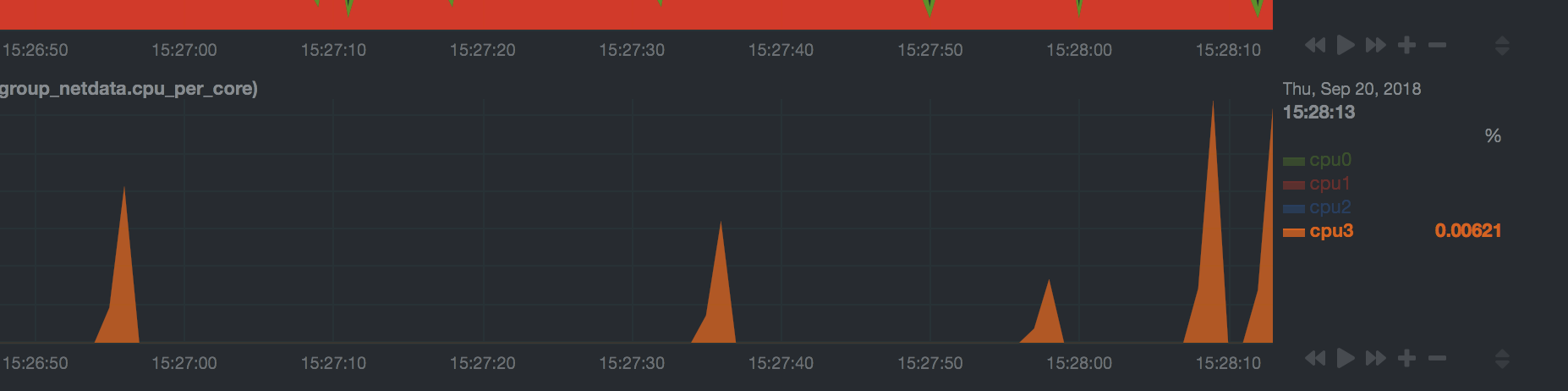

to verify it isn't just a problem with 1 server, I checked another, and sure enough, cpu3 which is isolated in the syslinux.cfg is getting used by net data again
1329331312_ScreenShot2018-09-20at3_28_09PM.thumb.png.b14403a37700943d660fb29cea7d66a8.png
I have plex on this server, but it appears to only have access to the cores it should.
now, these amounts of usage are not enough to impact my performance/usability, but so support the idea that some dockers seem to be finding their way onto other threads.
