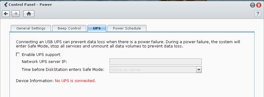

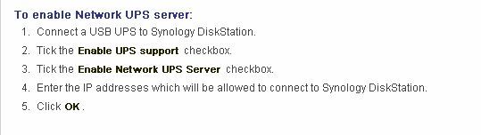

I recently purchased the APC Back-UPS ES 550.  Downloaded and installed the appropriate packages for unRAID and it works fine.  I also have a Synology NAS that supports the same UPS. They Synology will also shutdown when connected with the supplied RJ-45/USB cable.
But what I would like to do is the following:
(1) Have the syno monitor the unRAID server and shutdown accordingly
      ipkg apcupsd on the Synology and following these instructions?
http://lime-technology.com/forum/index.php?topic=1528.msg27123#msg27123
(2) Have the unRAID monitor the Synology and shutdown accordingly.
      http://lime-technology.com/forum/index.php?topic=3226.msg27310#msg27310
(3) Or is it as simple as plugging the USB into the Synology and inserting the towerip:3551 in the attached setup screen (Syno UPS)??
What is the best way to accomplish this?
