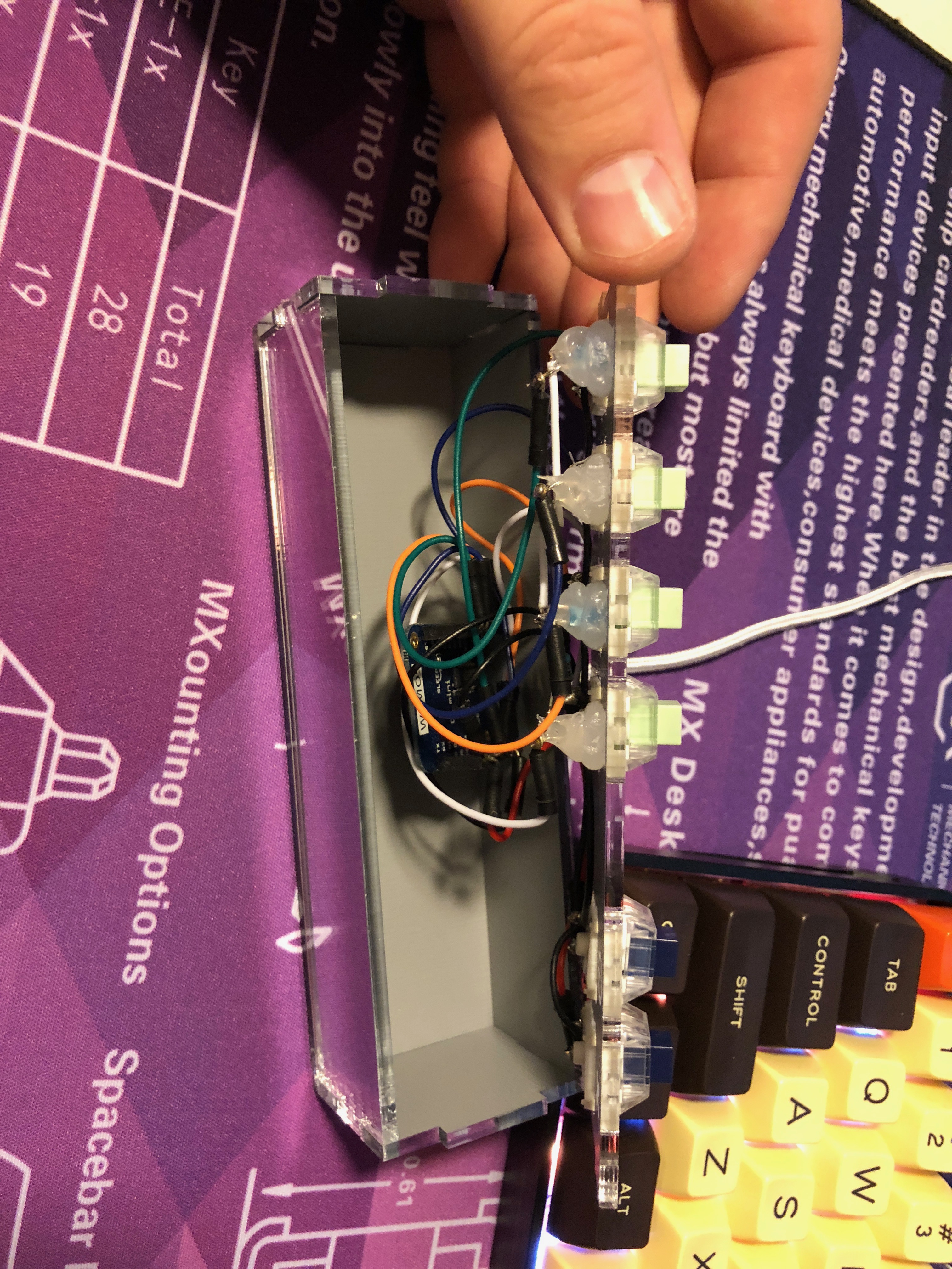

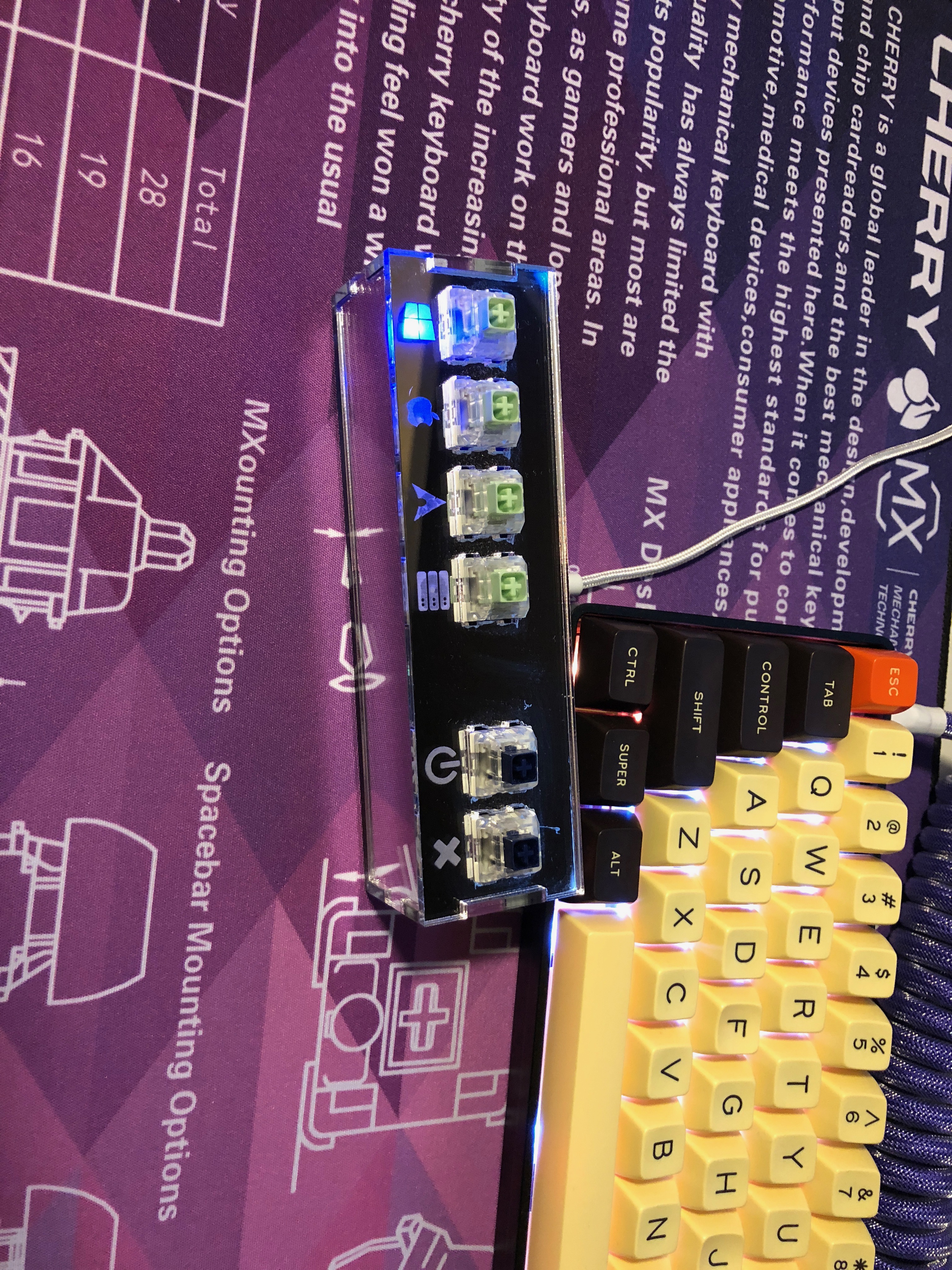

March 4, 20188 yr Hiya guys! I wanted to quickly share a project i've been working on and see if there is any interest in me releasing all the files and maybe writing a build guide for others to use. I love unRAID and the flexibility of the VM system. I quickly replaced the need of having two machines at home by just having a unRAID server that i can game on by passing through my graphics card to a VM. I'm quite lazy though and having to go into the webUI each time i wanted to start a VM quickly became a big enough hazzle so that i had to do something about it. What i came up with is a small controller using a D1 mini together with some switches for mechanical keyboards (i'm quite addicted to mechanical keyboards and even build my own custom boards). The D1 mini has one button per VM i want to be able to control plus one button for shutting a VM down and one button for destroying a VM. The D1 mini connects over Wi-Fi and only needs power over USB. It does not have to be connected to the servers USB ports. I designed the case to be glued together kinda like a puzzle and ordered it from a company here in europe that cut it for free with a lasercutter and they raster engrave the OS icon on the mirrored backside so that i can put a activity led behind it that shines through. The VM is started by pressing the button for the VM which then sends a WOL signal to the server where i've installed the "Virtual Machine Wake On Lan". There is also a companion docker app running written in ruby which exposes a super simple API that the controller use to find the state of all the VMs but also to issue a shutdown or destroy command to libvirt. When the button is pressed the VM is started and the activity led flashes slowly. If you press a button for a started VM the VM is selected and the activity led flashes in a quicker rate and you can then press either the shutdown or destroy button. All in all the whole project is pretty cheap. The D1 mini i just a couple of bucks on aliexpress. The case is not needed but makes it a bit prettier on your desk. I used the service available at http://cotter.co to cut the case in acrylic. At the time i ordered they offered free cutting time and material in silver mirrored acrylic, but they calculate the price live when you upload your design.
