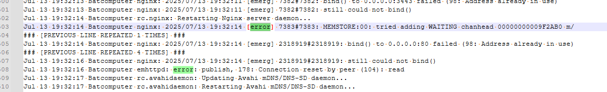

I had a few unclean shutdowns lately, are these errors any issues to be worried about? image.png

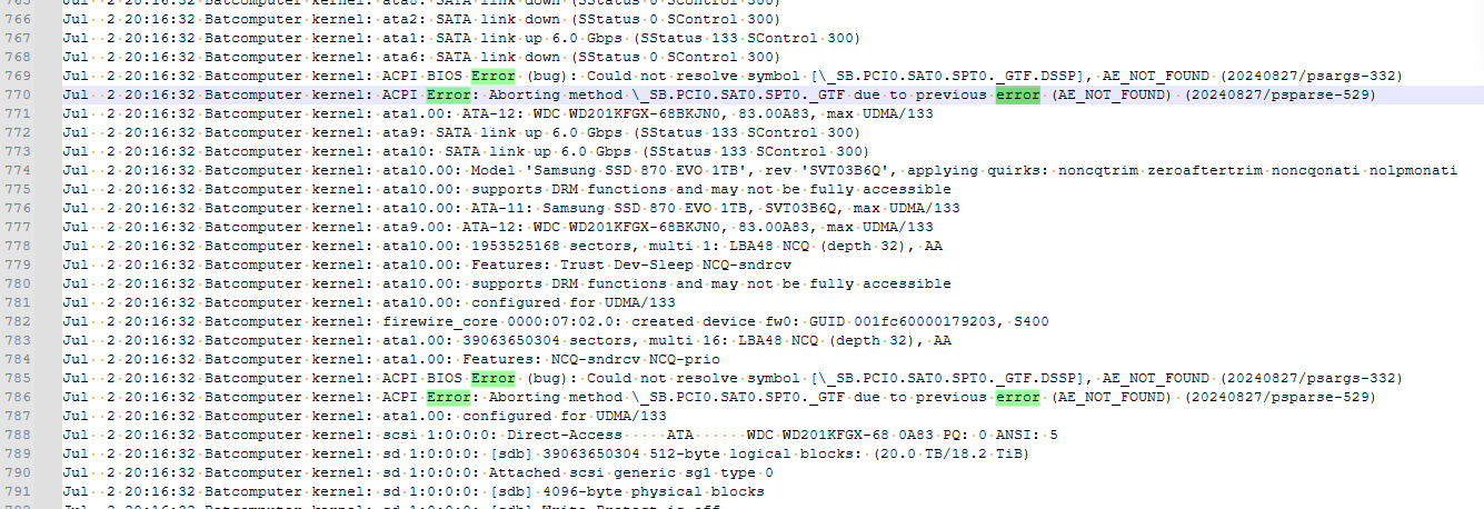

also attached the full diagnostics zip.
Any help is greatly appreciated. I would like to figure out what the issue is so I can resolve it.
Thanks,
Deerow
batcomputer-diagnostics-20250714-2201.zip
