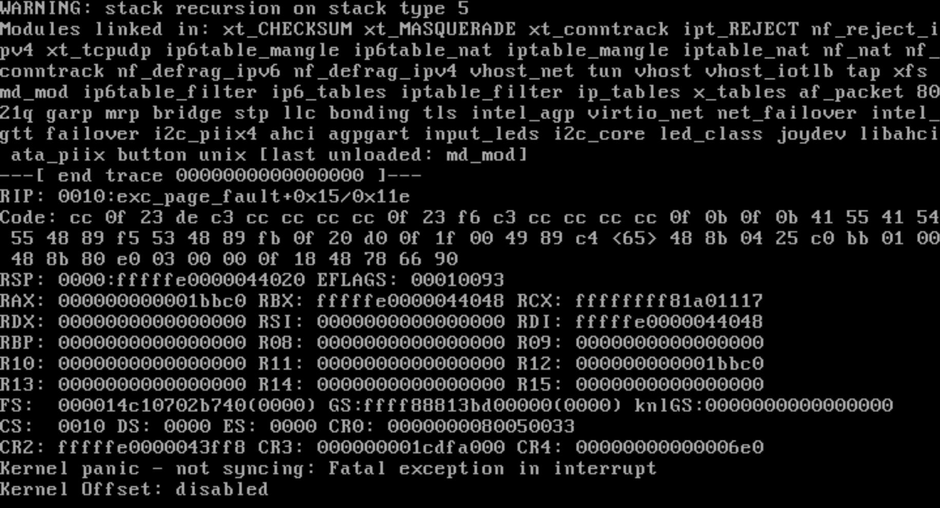

Today I had a weird one. I am on 6.12-rc2 after being on 6.9.X for almost a year.
In the morning I realized that pihole must be gone beacuse of no DNS solving. Wanted to open the Unraid GUI to look up, it wasn't available. Looked at the router in terms of sudden change of IP adress or something. Nothing changed there, instead the unraid server was off it said.
Running down stairs to take a look: PC was running. But neither could I make it display the local terminal nor was I able to just write 'reboot'/'power off' to shutdown safely. Nothing happened after more than 10 mins after the initial command input.
I also wan't able to WOL, press the usual power button for graceful shutdown. It simply didn't react at all to any inputs.
So I made a hard-reboot via the reset switch. Turned back on nicely, but of course wanted to do parity check first. Since there were no connections to the array from any kind of PC, I don't think I have to do it immediately.
I thought there would be a diagnose folder/entry made by Unraid, but it didn't.
A) Is there anything I can make and post here to investigate the already occurred problem after having already rebooted?
B) Mirroring the log to a Flash drive is the only thing to do now to investigate any kind of repetition of the same problem, right?
Not after a hard reset, you can enable the syslog server in case it happens again.

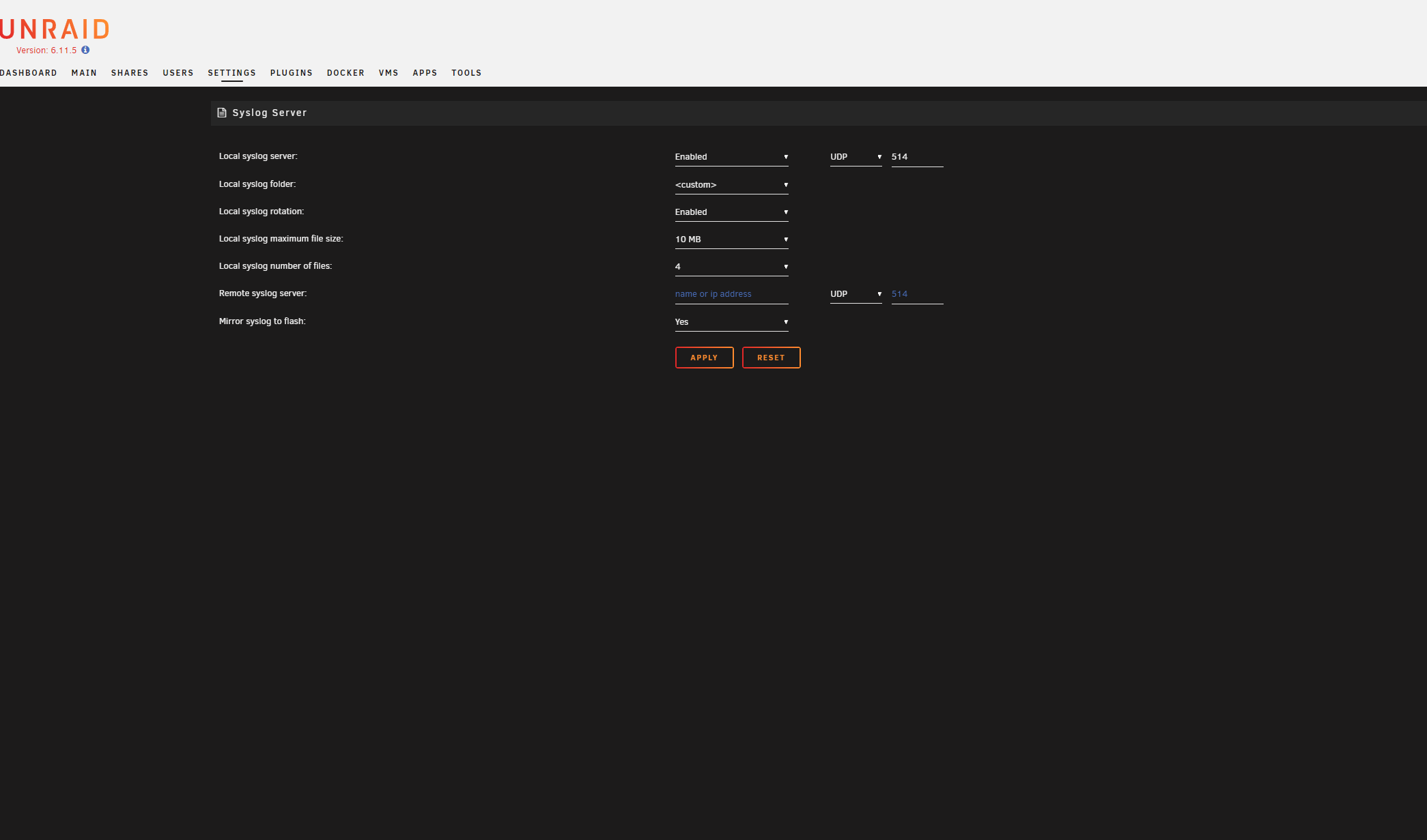

Hello. My server is shutting down all the time now. It can even happen multiple times a day. Where can I find the files containing the error logs so I can post it here and maybe get some fresh ideas on what to troubleshoot?
By default you will not have one as the logs are in RAM and thus lost on reboot.   To get persistent logs you need to use the syslog server.
I followed your link, but I didn't manage to set it up. Because after the server crashed again there was still no files recorded. Is this the correct setup?
Thank you so far!
Since you have the Mirror to Flash option set you should be getting a file in the 'logs' folder on the flash drive.  Is that where you looked for the file?
How do i Access that? Just stick the usb in another pc?
That is one option.
If you have the Dynamix File Manager plugin installed (or an equivalent for file managing) then you can use that to access the flash drive.
You can also click on the Boot device on the Main tab and go to the SMB settings to make it visible as the 'flash' share over the network.  By default it is not shared for security reasons.
