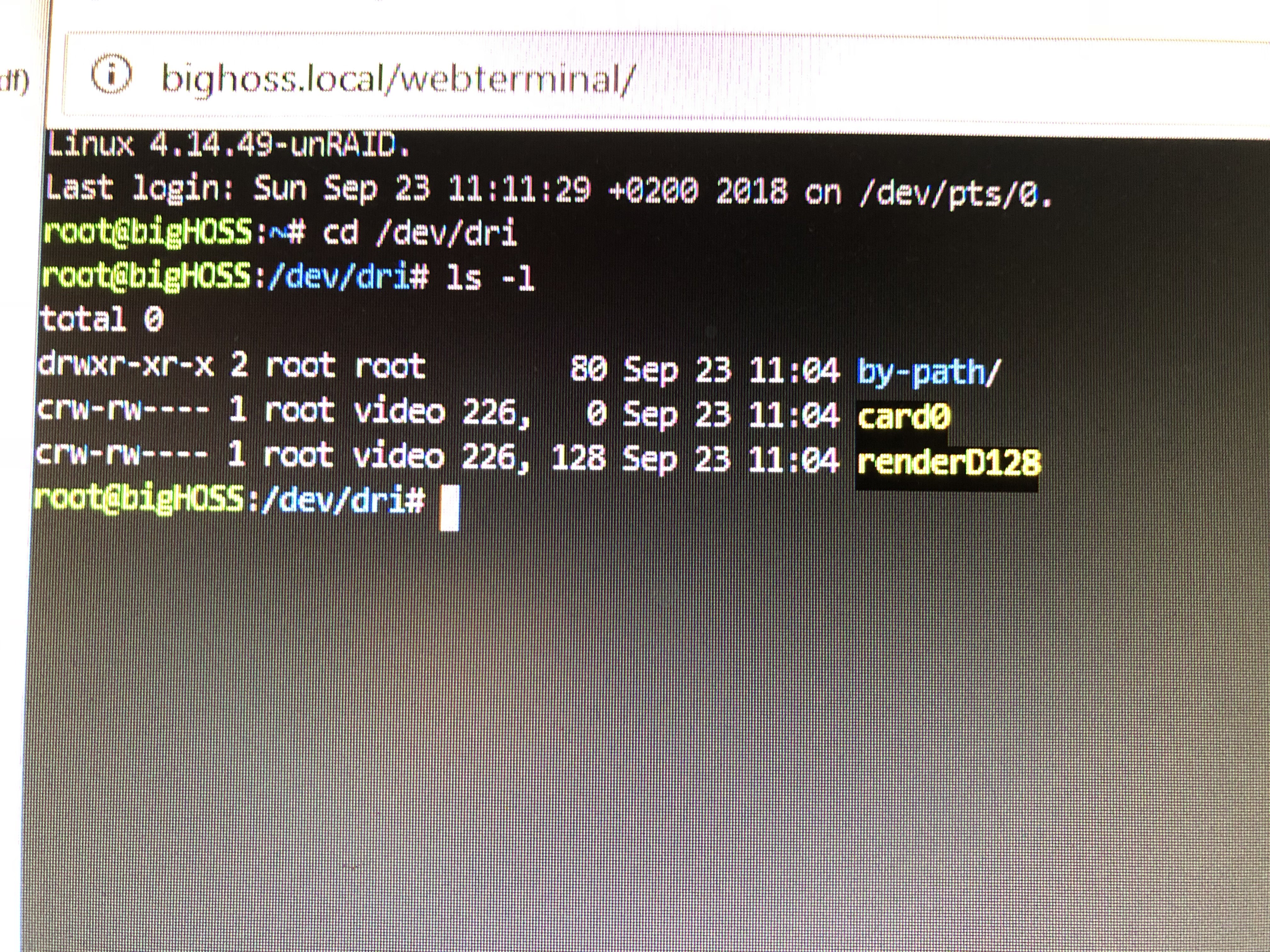

I'm pretty new to Plex, but I just updated my server to a i5 2500K that shall be able to do hw encoding for Plex. I signed up for a Plex Pass and I've added "--device /dev/dri:/dev/dri" where I should, but the other commands I've only runned in the terminal, not added to some "go" file.
Anyhow, I get "hw" when I check in dashboard in Plex. But I also got friend that only became Plex Pass users and then got that check mark in settings to activate hw encoding. I wonder if this still is up to date info or what am I missing? Is this some kind of unraid thing to get the hw?
Thanks.
/Söder
Is your friend running Plex on Windows, Mac or some other non-Docker/unRAID platform?
The "go" file edits are required to load the video drivers when your unRAID server is rebooted since anything you do at the unRAID command line is only modifying the OS in RAM.  If you do not add "modprobe i915" and the "chmod..." commands to the go file, the next time you reboot your server, you will no longer have hardware encoding enabled.
The --device /dev/dri:/dev/dri is required to pass the iGPU video device through to Plex running in a docker under Linux.
