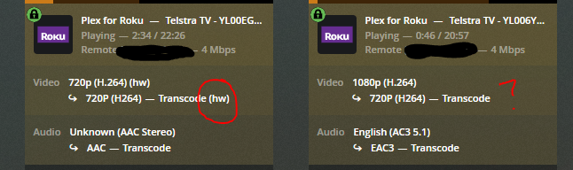

can any one shed some light on why one is transcoding with HW and the other isnt? making my server work real hard lol i have never seen it not use HW since i enabled the P2000 to HW with the nvidia driver in unraid
