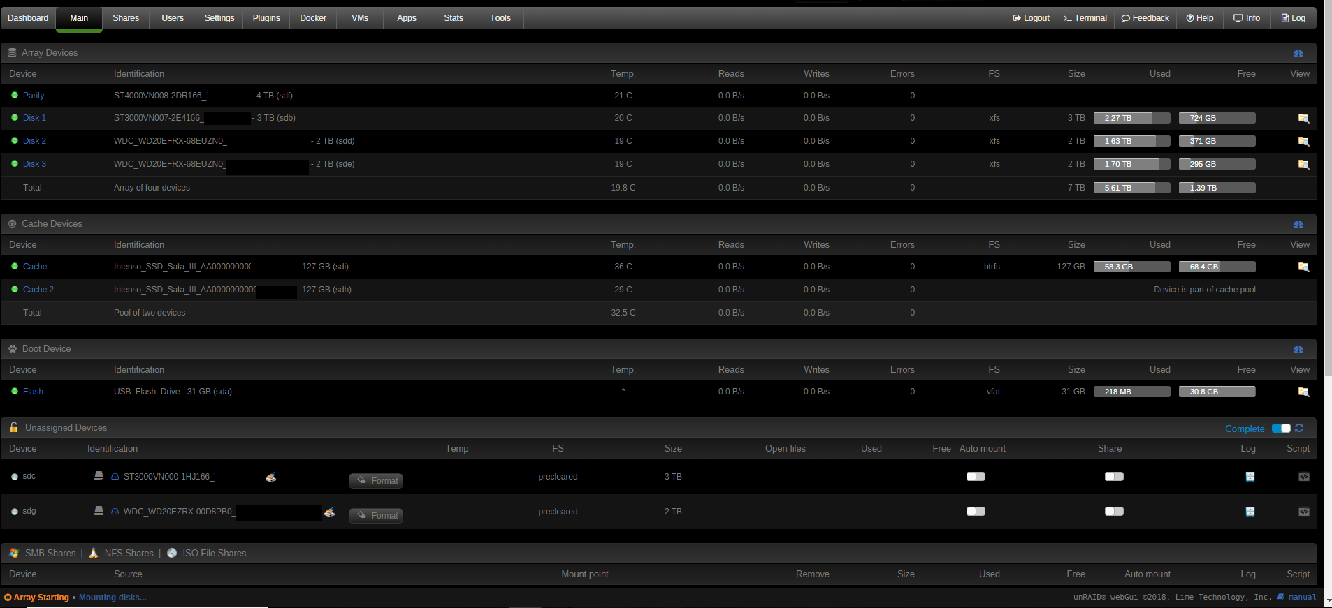

All disks are mounted on that screenshot.
yeah but no shares are up, no vms and docker tab says "Array must be started to view Docker containers."
Please post new diags since disks weren't mounted on the ones you posted.
