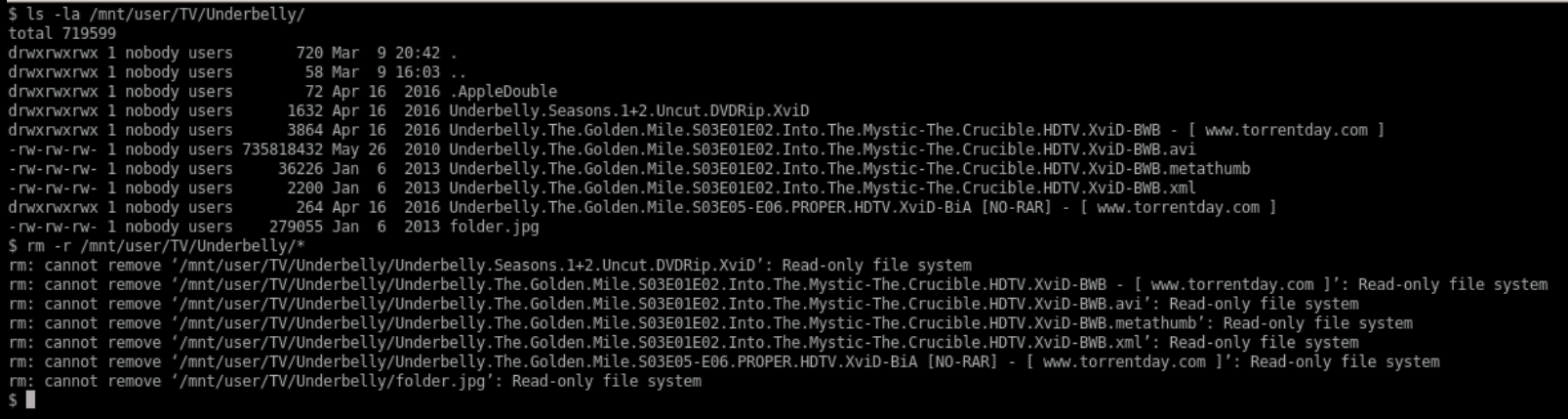

Hi everyone and thanks in advance.
I have some old TV show files that cause issues with PLEX because they are read-only it seems. They are always in the 'recently added' section and cannot be marked as watched/unwatched etc.
I've tried deleting them with Dolphin, Windows and from terminal (as per screenshot attached) with no luck. I've tried again after running Docker Safe New Permissions... nope. I can see that it's not permissions, it's a read-only problem but I can't find how to tackle it.
With my limited knowledge, I considered moving all other files off the disk, making the disk unmountable and formatting then moving everything else back but that seems like shooting sparrows with cannons. Any better suggestions?

There's filesystem corruption on disk2:
Mar  9 00:48:11 NAS kernel: REISERFS error (device md2): vs-5150 search_by_key: invalid format found in block 450590991. Fsck?
Mar  9 00:48:11 NAS kernel: REISERFS (device md2): Remounting filesystem read-only
run reiserfsck.
run reiserfsck.

Is this corruption something that is avoidable through maintainance?
Filesystem corruption doesn't usually happen (or it shouldn't) without a reason, like unclean shutdown, memory issues, etc, you might also want to look into converting to xfs as reiserfs is no longer recommended.

Filesystem... I was already converting disks to XFS but skipped disk2 as I had trouble getting the data off (suprise suprise). 3 out of 13 disks to go!
Cache floor, i think I've got the cache free space set to about 20GB which is about where it is sitting. I have appdata set to 'preferred' so that apps (mainly plex) just use the array for metadata once the cache is full. I plan to add a third cache disk when time allows, just in raid 0 aswell seen as most of the cache is backed-up weekly at worse (the VMs everyday).
Corruption... I only recently replaced my UPS and had a power outage recently (caused by my wife pointing a hose at a powerpoint out the back lol). This did cause issues and to restore backups of the vms and appdata. Not totally suprising that there is corruption. Thanks for finding which disk! I'll do some reading and see if I can clean it up.
