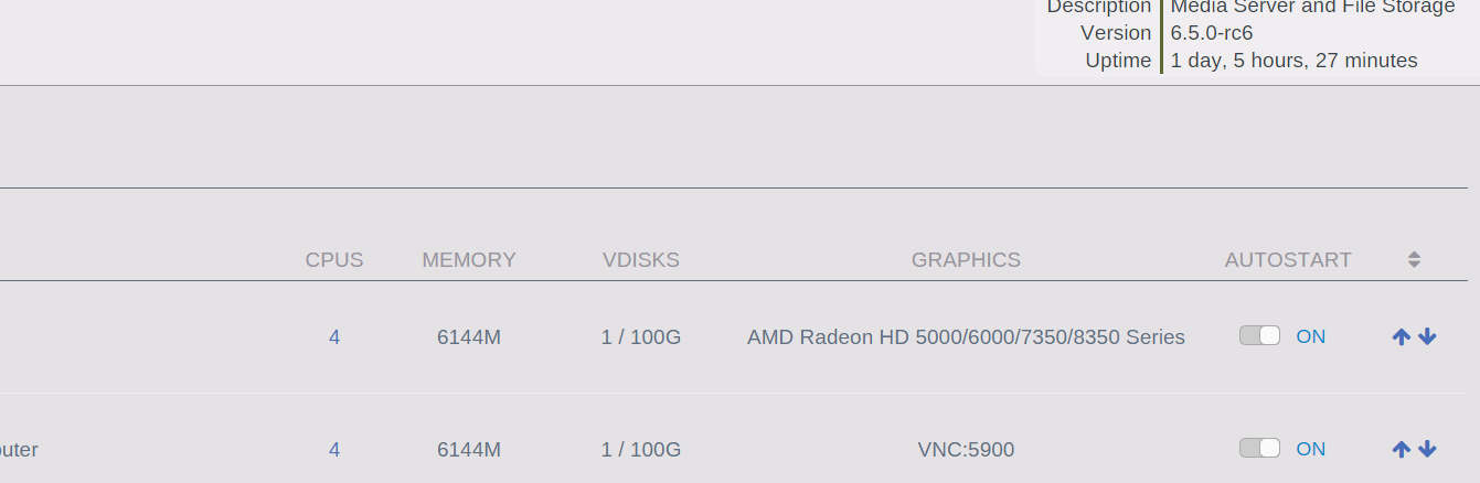

i'm not on the 6.5RC train yet, so correct me, if this was added already – but in case it's not, maybe there's still time for it:
in the light of VM management changes to the GUI – wouldn't it be good, to have an easy way of 'unmounting' the virtio.iso from the virtual cd/dvd drive?
usually it stays connected to the VM at all times, but why? and… if somebody didn't install all necessary drivers immediately after the creation of the VM it could be mounted at any time back again.
maybe it could be considered as an improvement of managing VMs. thx.
There is a detach button if you click on the VM name. It's on the right side.
If you turn on advanced view, you can delete the file path for the virtio.iso.

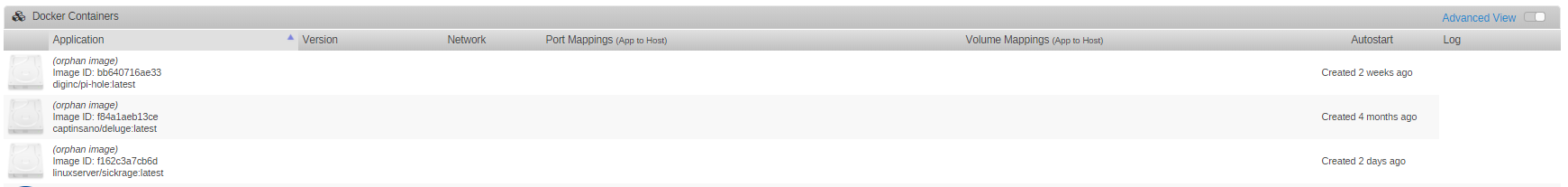

I just updated the names of my docker containers and now I am getting (orphan image)
Version: 6.5.0-rc6
Edited by ThornburyWN
