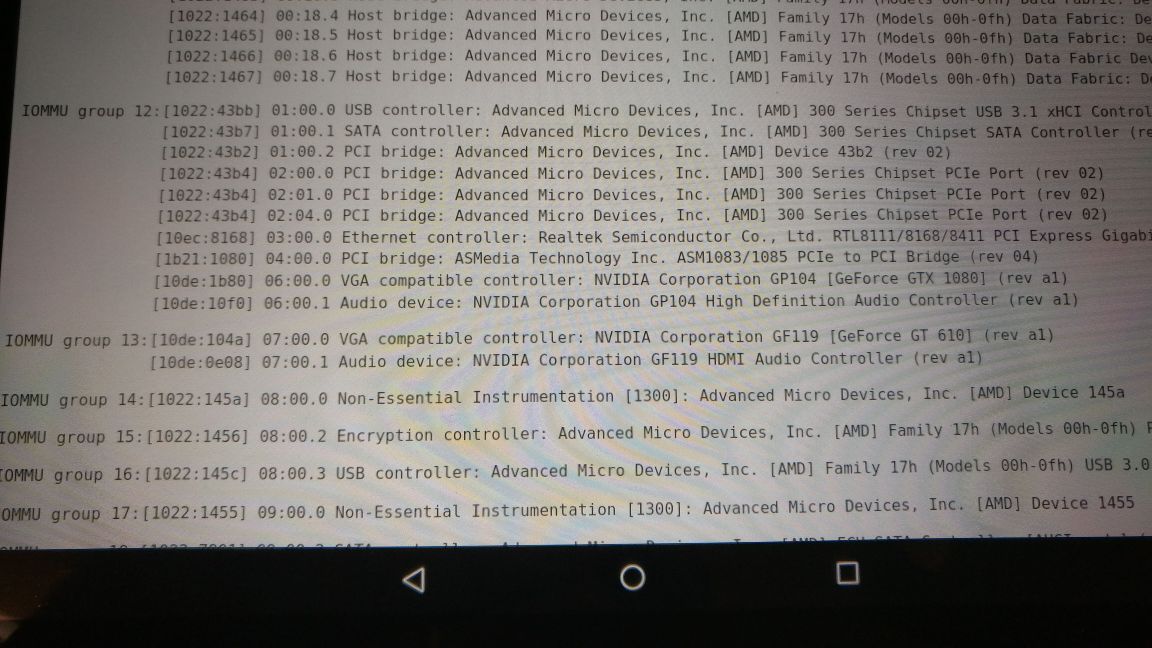

Hey guys,
this is with ACS overrides enable :(

Multi-function different from override?  Good luck with new board, hope it works out.
Edit the syslinux config.
Sent from my SM-G955U using Tapatalk

[1022:43b4] 02:07.0 PCI bridge: Advanced Micro Devices, Inc. [AMD] 300 Series Chipset PCIe Port (rev 02)
[1b21:1343] 06:00.0 USB controller: ASMedia Technology Inc. Device 1343
[8086:1539] 07:00.0 Ethernet controller: Intel Corporation I211 Gigabit Network Connection (rev 03)
IOMMU group 14:	[10de:104a] 09:00.0 VGA compatible controller: NVIDIA Corporation GF119 [GeForce GT 610] (rev a1)
[10de:0e08] 09:00.1 Audio device: NVIDIA Corporation GF119 HDMI Audio Controller (rev a1)
IOMMU group 15:	[10de:1b80] 0a:00.0 VGA compatible controller: NVIDIA Corporation GP104 [GeForce GTX 1080] (rev a1)
[10de:10f0] 0a:00.1 Audio device: NVIDIA Corporation GP104 High Definition Audio Controller (rev a1)
IOMMU group 16:	[1022:145a] 0b:00.0 Non-Essential Instrumentation [1300]: Advanced Micro Devices, Inc. [AMD] Device 145a
IOMMU group 17:	[1022:1456] 0b:00.2 Encryption controller: Advanced Micro Devices, Inc. [AMD] Family 17h (Models 00h-0fh) Platform Security Processor
IOMMU group 18:	[1022:145c] 0b:00.3 USB controller: Advanced Micro Devices, Inc. [AMD] Family 17h (Models 00h-0fh) USB 3.0 Host Controller
IOMMU group 19:	[1022:1455] 0c:00.0 Non-Essential Instrumentation [1300]: Advanced Micro Devices, Inc. [AMD] Device 1455
IOMMU group 20:	[1022:7901] 0c:00.2 SATA controller: Advanced Micro Devices, Inc. [AMD] FCH SATA Controller [AHCI mode] (rev 51)
IOMMU group 21:	[1022:1457] 0c:00.3 Audio device: Advanced Micro Devices, Inc. [AMD] Family 17h (Models 00h-0fh) HD Audio Controller
IOMMU (ASUS Prime X370 PRO, with bios version 3803 and all ACS VM setting enabled):
IOMMU group 0:	[1022:1452] 00:01.0 Host bridge: Advanced Micro Devices, Inc. [AMD] Family 17h (Models 00h-0fh) PCIe Dummy Host Bridge

IOMMU (ASUS Prime X370 PRO, with bios version 3803 and all ACS VM setting enabled WITH MULTIFUNCTION):
IOMMU group 1:	[1022:1453] 00:01.3 PCI bridge: Advanced Micro Devices, Inc. [AMD] Family 17h (Models 00h-0fh) PCIe GPP Bridge
IOMMU group 2:	[1022:1452] 00:02.0 Host bridge: Advanced Micro Devices, Inc. [AMD] Family 17h (Models 00h-0fh) PCIe Dummy Host Bridge
IOMMU group 3:	[1022:1452] 00:03.0 Host bridge: Advanced Micro Devices, Inc. [AMD] Family 17h (Models 00h-0fh) PCIe Dummy Host Bridge
IOMMU group 4:	[1022:1453] 00:03.1 PCI bridge: Advanced Micro Devices, Inc. [AMD] Family 17h (Models 00h-0fh) PCIe GPP Bridge
IOMMU group 5:	[1022:1453] 00:03.2 PCI bridge: Advanced Micro Devices, Inc. [AMD] Family 17h (Models 00h-0fh) PCIe GPP Bridge
IOMMU group 6:	[1022:1452] 00:04.0 Host bridge: Advanced Micro Devices, Inc. [AMD] Family 17h (Models 00h-0fh) PCIe Dummy Host Bridge
IOMMU group 7:	[1022:1452] 00:07.0 Host bridge: Advanced Micro Devices, Inc. [AMD] Family 17h (Models 00h-0fh) PCIe Dummy Host Bridge
IOMMU group 8:	[1022:1454] 00:07.1 PCI bridge: Advanced Micro Devices, Inc. [AMD] Family 17h (Models 00h-0fh) Internal PCIe GPP Bridge 0 to Bus B
IOMMU group 9:	[1022:1452] 00:08.0 Host bridge: Advanced Micro Devices, Inc. [AMD] Family 17h (Models 00h-0fh) PCIe Dummy Host Bridge
IOMMU group 10:	[1022:1454] 00:08.1 PCI bridge: Advanced Micro Devices, Inc. [AMD] Family 17h (Models 00h-0fh) Internal PCIe GPP Bridge 0 to Bus B
IOMMU group 11:	[1022:790b] 00:14.0 SMBus: Advanced Micro Devices, Inc. [AMD] FCH SMBus Controller (rev 59)
[1022:790e] 00:14.3 ISA bridge: Advanced Micro Devices, Inc. [AMD] FCH LPC Bridge (rev 51)
IOMMU group 12:	[1022:1460] 00:18.0 Host bridge: Advanced Micro Devices, Inc. [AMD] Family 17h (Models 00h-0fh) Data Fabric: Device 18h; Function 0
[1022:1461] 00:18.1 Host bridge: Advanced Micro Devices, Inc. [AMD] Family 17h (Models 00h-0fh) Data Fabric: Device 18h; Function 1
[1022:1462] 00:18.2 Host bridge: Advanced Micro Devices, Inc. [AMD] Family 17h (Models 00h-0fh) Data Fabric: Device 18h; Function 2
[1022:1463] 00:18.3 Host bridge: Advanced Micro Devices, Inc. [AMD] Family 17h (Models 00h-0fh) Data Fabric: Device 18h; Function 3
[1022:1464] 00:18.4 Host bridge: Advanced Micro Devices, Inc. [AMD] Family 17h (Models 00h-0fh) Data Fabric: Device 18h; Function 4
[1022:1465] 00:18.5 Host bridge: Advanced Micro Devices, Inc. [AMD] Family 17h (Models 00h-0fh) Data Fabric: Device 18h; Function 5
[1022:1466] 00:18.6 Host bridge: Advanced Micro Devices, Inc. [AMD] Family 17h (Models 00h-0fh) Data Fabric Device 18h Function 6
[1022:1467] 00:18.7 Host bridge: Advanced Micro Devices, Inc. [AMD] Family 17h (Models 00h-0fh) Data Fabric: Device 18h; Function 7
IOMMU group 13:	[1022:43b9] 01:00.0 USB controller: Advanced Micro Devices, Inc. [AMD] Device 43b9 (rev 02)
IOMMU group 14:	[1022:43b5] 01:00.1 SATA controller: Advanced Micro Devices, Inc. [AMD] Device 43b5 (rev 02)
IOMMU group 15:	[1022:43b0] 01:00.2 PCI bridge: Advanced Micro Devices, Inc. [AMD] Device 43b0 (rev 02)
IOMMU group 16:	[1022:43b4] 02:00.0 PCI bridge: Advanced Micro Devices, Inc. [AMD] 300 Series Chipset PCIe Port (rev 02)
IOMMU group 17:	[1022:43b4] 02:02.0 PCI bridge: Advanced Micro Devices, Inc. [AMD] 300 Series Chipset PCIe Port (rev 02)
IOMMU group 18:	[1022:43b4] 02:03.0 PCI bridge: Advanced Micro Devices, Inc. [AMD] 300 Series Chipset PCIe Port (rev 02)
IOMMU group 19:	[1022:43b4] 02:04.0 PCI bridge: Advanced Micro Devices, Inc. [AMD] 300 Series Chipset PCIe Port (rev 02)
IOMMU group 20:	[1022:43b4] 02:06.0 PCI bridge: Advanced Micro Devices, Inc. [AMD] 300 Series Chipset PCIe Port (rev 02)
IOMMU group 21:	[1022:43b4] 02:07.0 PCI bridge: Advanced Micro Devices, Inc. [AMD] 300 Series Chipset PCIe Port (rev 02)
IOMMU group 22:	[1b21:1343] 06:00.0 USB controller: ASMedia Technology Inc. Device 1343
IOMMU group 23:	[8086:1539] 07:00.0 Ethernet controller: Intel Corporation I211 Gigabit Network Connection (rev 03)
IOMMU group 24:	[10de:104a] 09:00.0 VGA compatible controller: NVIDIA Corporation GF119 [GeForce GT 610] (rev a1)
IOMMU group 25:	[10de:0e08] 09:00.1 Audio device: NVIDIA Corporation GF119 HDMI Audio Controller (rev a1)
IOMMU group 26:	[10de:1b80] 0a:00.0 VGA compatible controller: NVIDIA Corporation GP104 [GeForce GTX 1080] (rev a1)
IOMMU group 27:	[10de:10f0] 0a:00.1 Audio device: NVIDIA Corporation GP104 High Definition Audio Controller (rev a1)
IOMMU group 28:	[1022:145a] 0b:00.0 Non-Essential Instrumentation [1300]: Advanced Micro Devices, Inc. [AMD] Device 145a
IOMMU group 29:	[1022:1456] 0b:00.2 Encryption controller: Advanced Micro Devices, Inc. [AMD] Family 17h (Models 00h-0fh) Platform Security Processor
IOMMU group 30:	[1022:145c] 0b:00.3 USB controller: Advanced Micro Devices, Inc. [AMD] Family 17h (Models 00h-0fh) USB 3.0 Host Controller
IOMMU group 31:	[1022:1455] 0c:00.0 Non-Essential Instrumentation [1300]: Advanced Micro Devices, Inc. [AMD] Device 1455
IOMMU group 32:	[1022:7901] 0c:00.2 SATA controller: Advanced Micro Devices, Inc. [AMD] FCH SATA Controller [AHCI mode] (rev 51)
IOMMU group 33:	[1022:1457] 0c:00.3 Audio device: Advanced Micro Devices, Inc. [AMD] Family 17h (Models 00h-0fh) HD Audio Controller
Whew multifunction, sure packs a punch i would say :D, while ACS off and ACS on without multifunction are according to notepad++ compare identical.
Are you guys sure it doesnt make things more unstable?
@Donach @david279 @Jcloud
Edited by jammsen
Updated iommu tables, multiple times
@jammsen
What you may be forced to do, is to passthrough whole PCI group to one VM. Although this allows you to pick the groups specifically, not to use one huge group.
For example, Groups 31-33 may have to be passed to the same VM to make it working.
However, I would still try to pass just the Audio (Group 33) and see what happens, try a few restarts etc.
