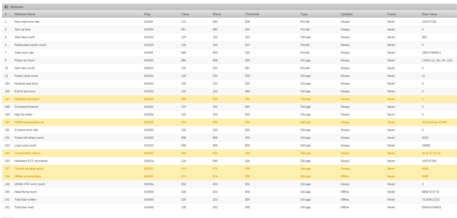

Is this drive toast?
Array was fine.  Drive dropped out overnight. Parity was confirmed 2 days ago.  Rebuilding now with hot spare while i analyse the drive.  The bad drive dropped completely out of unraid.  had to reboot to get it to register again.
5:57 AM (6 hours ago)
Subject: Alert [UNRAID] - Disk 4 in error state (disk dsbl)

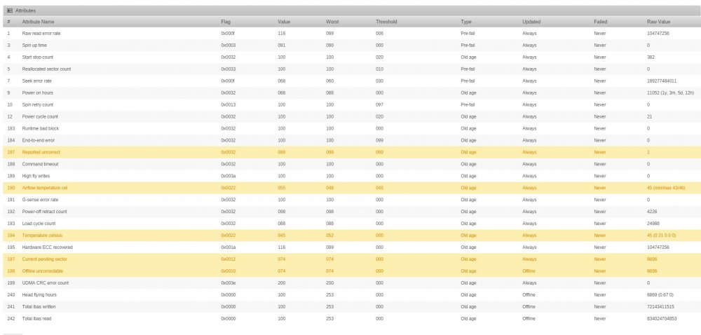

Drive is reporting:
# Attribute Name Flag Value Worst Threshold Type Updated Failed Raw Value
1 Raw read error rate 0x000f 116 099 006 Pre-fail Always Never 104747256
3 Spin up time 0x0003 091 090 000 Pre-fail Always Never 0
4 Start stop count 0x0032 100 100 020 Old age Always Never 382
5 Reallocated sector count 0x0033 100 100 010 Pre-fail Always Never 0
7 Seek error rate 0x000f 068 060 030 Pre-fail Always Never 189277484011
9 Power on hours 0x0032 088 088 000 Old age Always Never 11052 (1y, 3m, 5d, 12h)
10 Spin retry count 0x0013 100 100 097 Pre-fail Always Never 0
12 Power cycle count 0x0032 100 100 020 Old age Always Never 21
183 Runtime bad block 0x0032 100 100 000 Old age Always Never 0
184 End-to-end error 0x0032 100 100 099 Old age Always Never 0
187 Reported uncorrect 0x0032 099 099 000 Old age Always Never 1
188 Command timeout 0x0032 100 100 000 Old age Always Never 0
189 High fly writes 0x003a 100 100 000 Old age Always Never 0
190 Airflow temperature cel 0x0022 055 048 045 Old age Always Never 45 (min/max 43/46)
191 G-sense error rate 0x0032 100 100 000 Old age Always Never 0
192 Power-off retract count 0x0032 098 098 000 Old age Always Never 4226
193 Load cycle count 0x0032 088 088 000 Old age Always Never 24988
194 Temperature celsius 0x0022 045 052 000 Old age Always Never 45 (0 21 0 0 0)
195 Hardware ECC recovered 0x001a 116 099 000 Old age Always Never 104747256
197 Current pending sector 0x0012 074 074 000 Old age Always Never 8696
198 Offline uncorrectable 0x0010 074 074 000 Old age Offline Never 8696
199 UDMA CRC error count 0x003e 200 200 000 Old age Always Never 0
240 Head flying hours 0x0000 100 253 000 Old age Offline Never 6869 (0 67 0)
241 Total lbas written 0x0000 100 253 000 Old age Offline Never 72143411515
242 Total lbas read 0x0000 100 253 000 Old age Offline Never 834024704853
I like to pull drives from 8tb seagate externals, I have 10 of these in my system with 2 parity, 6 data, 2 hot spare.  They are all ST8000AS0002 drives, meaning not the greatest drives.  I have seen this happen 5 time in the last 2 years to drives.  I warranted them 3 of them.  The other 2 I have also had this happen on a smaller scale, only 1 or 2 uncorrectable offline sectors and simply removed them from the array.  Ran a SMART test.  A few preclears and then used them again.
I am not sure what constitutes a through it away.  Warranty is almost over on many of these.  I may start replacing with better quality drives.
Does anyone have an opinion on whether better drives are worth it?  With dual parity and hot sparse at the ready.  Do I need to look at higher quality drives?
I suspect the NAS type drive might not drop out of the system in this scenario.  Any opinions?
Yes - your pending sectors are very high. Would look to replace ASAP.
If in doubt, you could try to run a SMART extended test or play with preclear. But I would not bother.
Your choice of drives is up to you. Parity is pretty good protection from a failed drive if you are keeping up with drive maintenance. But I would be wary to put weak drives in a server. I think HGSTs are the best, most reliable drives. Price is not always the best indicator of drive longevity.
With so many failures I wonder if you are having issues with heat (I like to keep drives under 45C, and looks like you are pretty good there). Excessive vibration could be an issue. Or high temperature variation. Or maybe just bad luck.
