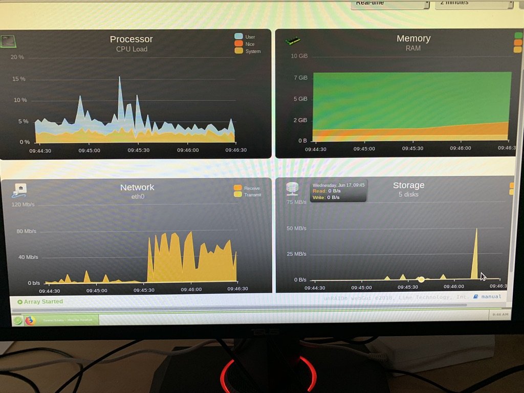

AFP still active:

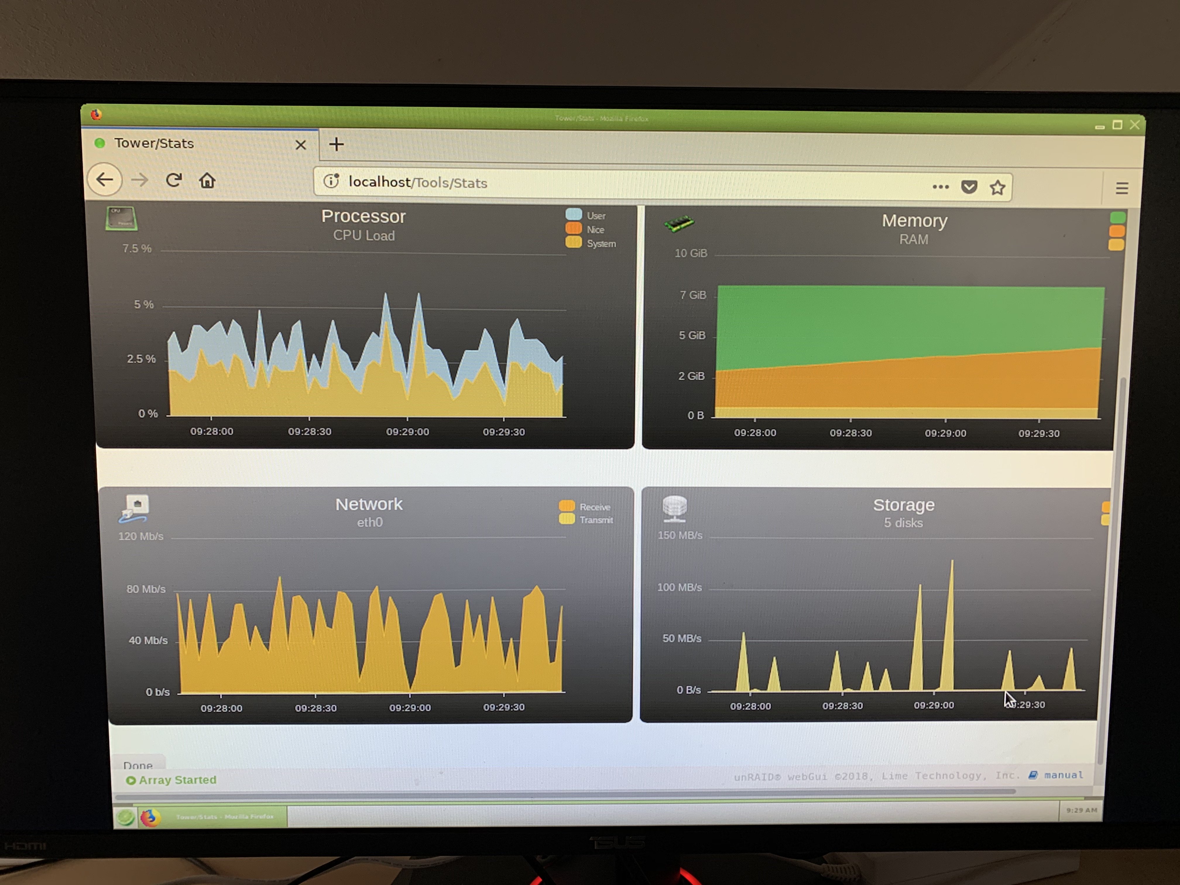

With AFP deactivated completely:
6F34AD86-B857-4FC9-8C83-0061D16E383E_1_105_c.thumb.jpeg.4f8597fd6734732a5750a29c0794b66f.jpeg
What I don't get is that it takes 1,5 hours to copy a 30gb file. The computer reports to have sent already 10gb over the network while the progress is at 5gb of 30gb.
I've also noticed that the spikes of the storage get bigger with time. Largest one was 300 MB/s
I don't know if I'm expecting to much...
