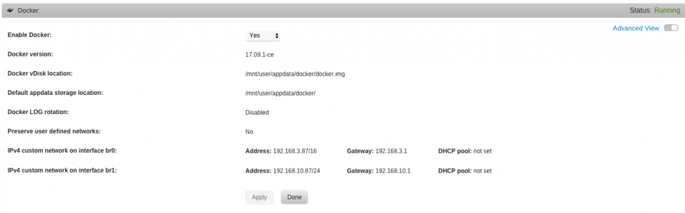

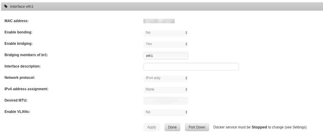

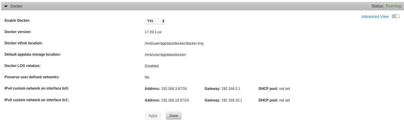

I'm trying on a different unraid box to assign dockers to eth1 (br1) to slap on a vlan and do not see it as an option in the "Network Type:" drop down.
In network settings, I have both tried to assign eth1 a static address and without and it did not work. I also tried to delete the docker image and the following commands to no avail:

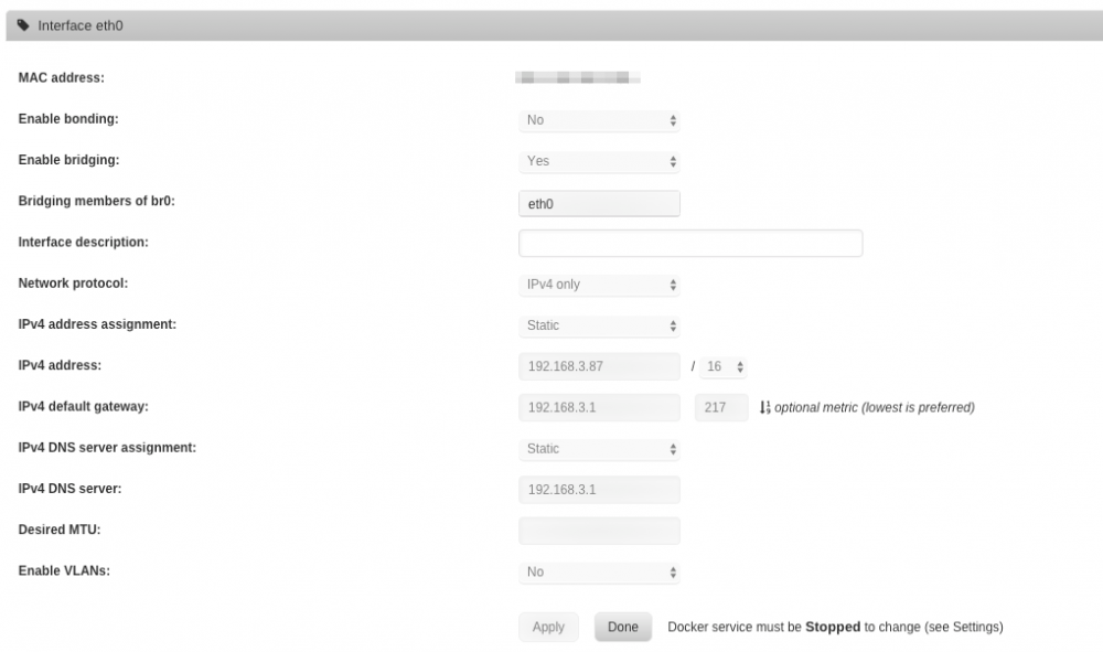

Configuration wise everything looks alright. What happens if try to add manually.
Ah,  I see the problem...
Your br0 is defined as 192.168.3.87/16 which overlaps with br1. Change br0 to 192.168.3.87/24

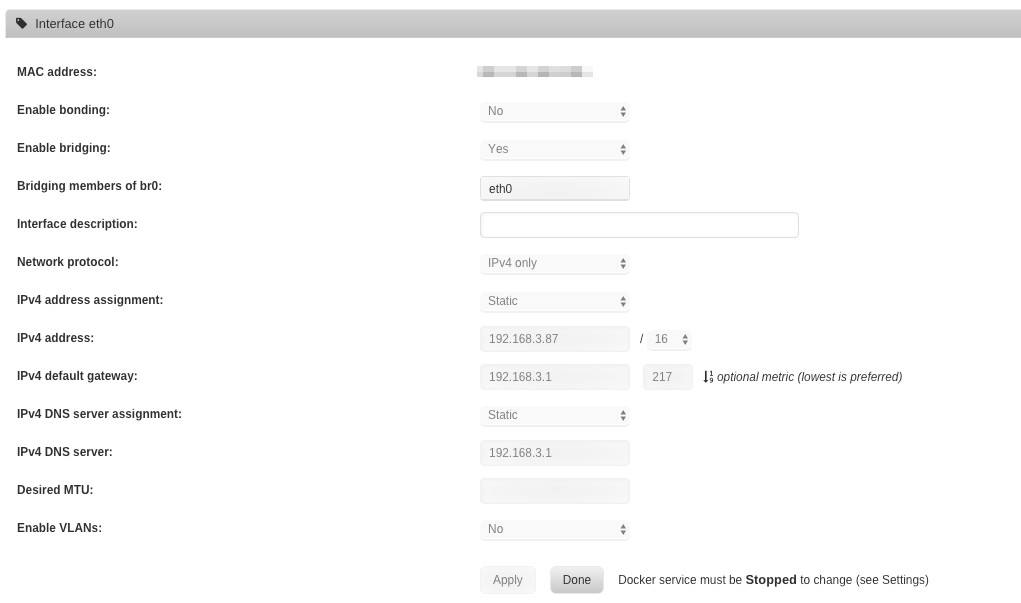

I updated my response, because I saw a little later why it is not working.
You need to stop the docker (and VM) service, then change your network settings for eth0 and put the mask on 24.
Thanks.
Yeah not sure how that got there. I was going to change it but I'm doing a netcat from another unraid box and was scared changing it would kill the network.
