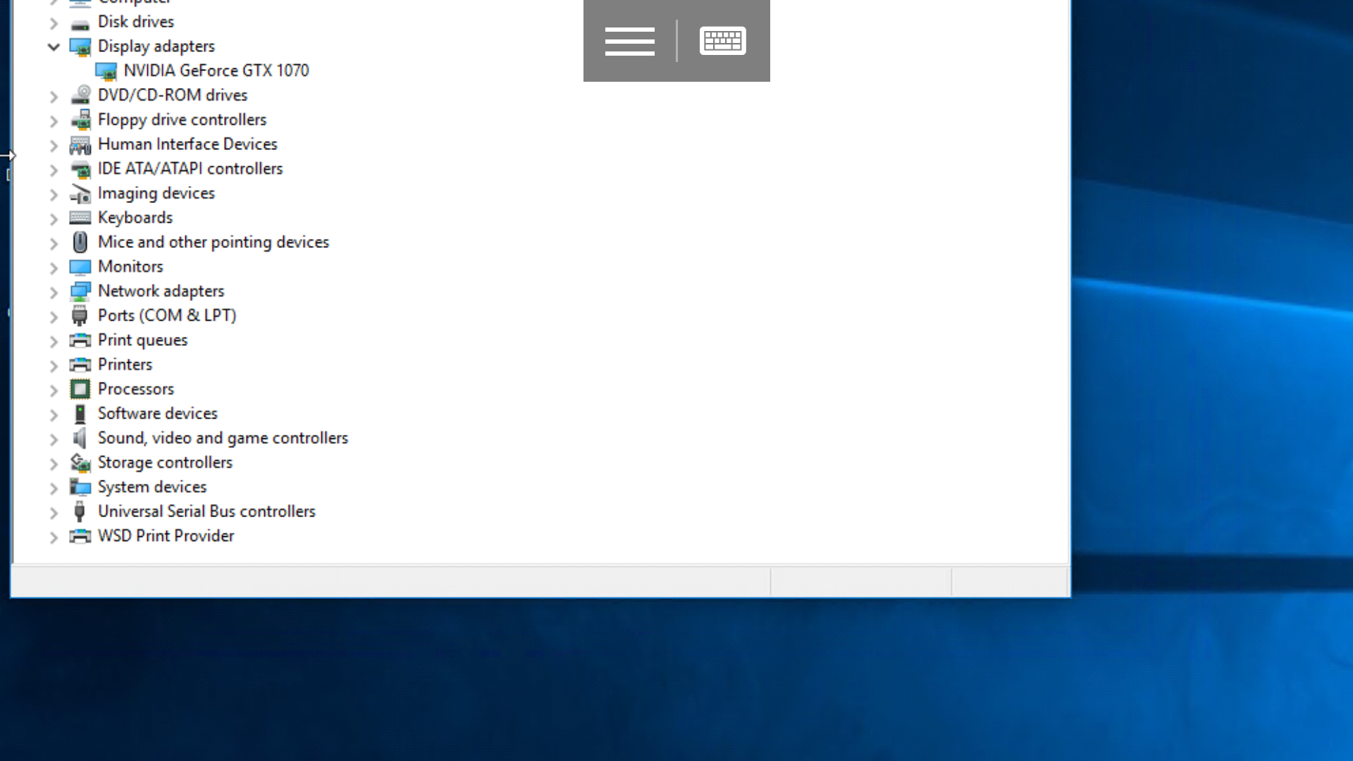

Everything is running really smooth except for the gpu passthru, I keep getting the error 43 when I look at the display adapter in device manager.
I have tried the fix listed here, twice:
I have also tried 6 different v bios, each with the same result.. My system sees the gtx 1070, but I am still getting that 43 error code.
any tips or suggestions? this is causing quite the headache :(

w00t.. i was finally able to pull the vbios with this method, thank you..
also updated to unraid 6.5, which seems to have eliminated the edit xml and added a path option for gpu vbios :) got that going great now, thank you guys again :)

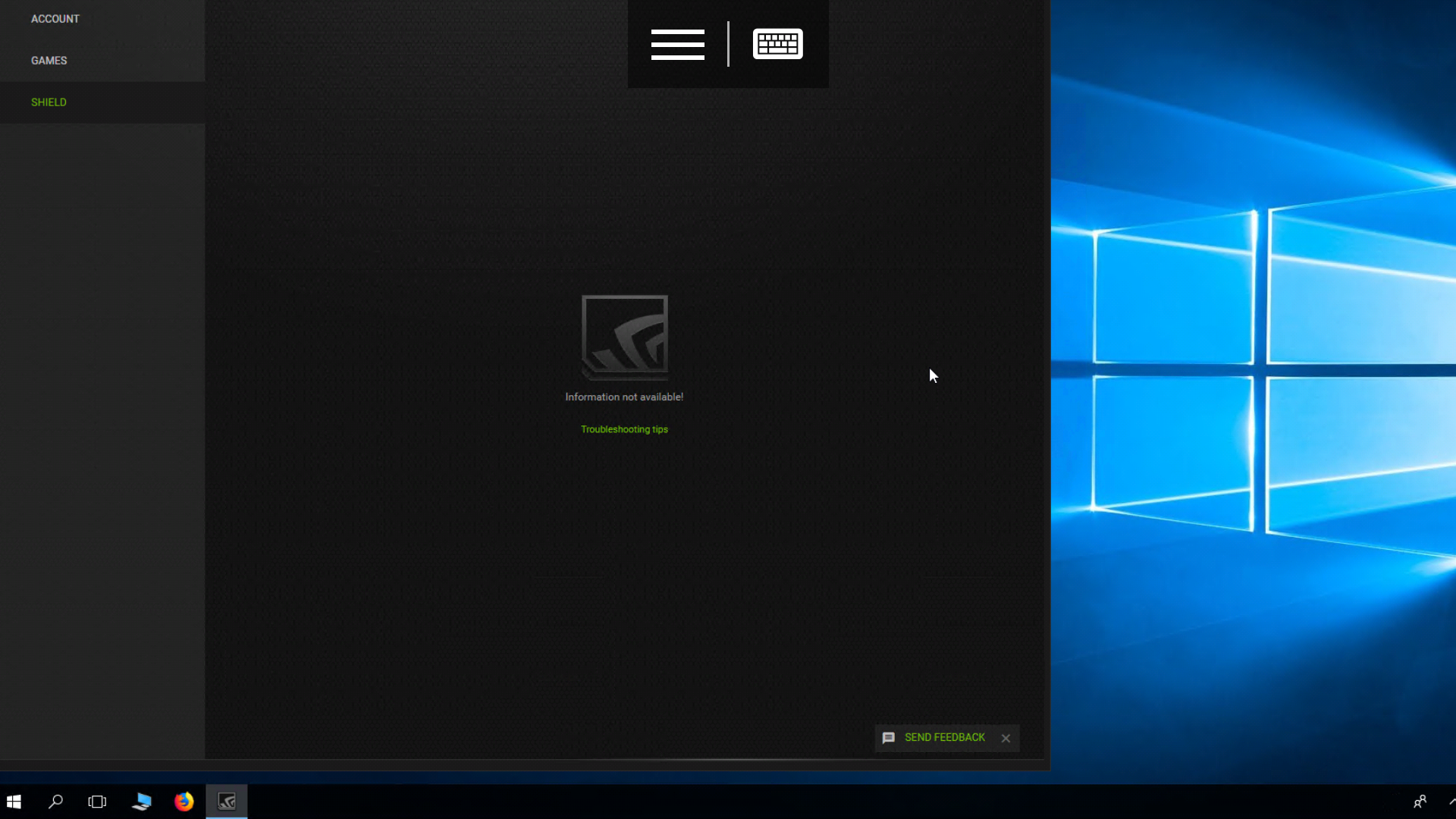

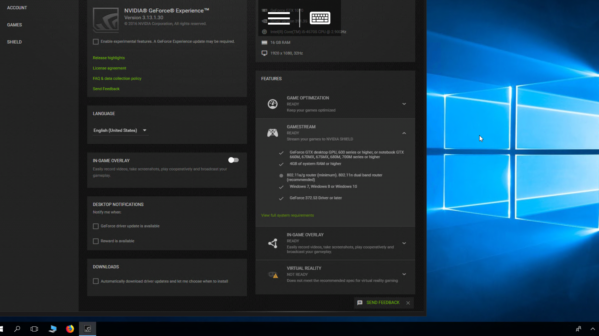

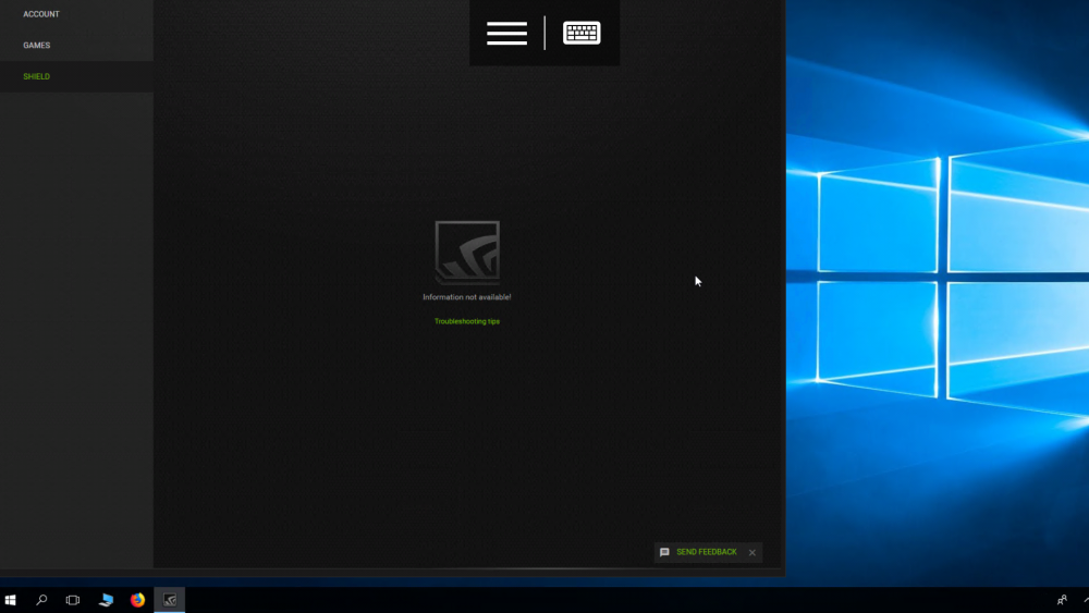

Well, my gpu appears to be working, as I can remote in and play games, however I cannot get game stream to work.
I have disabled the firewall, anti virus, reinstalled geforce driver's several times, and followed the user trouble shooter guide on Nvidia, and still no luck. ☹️
Geforce experience shows that my system is capable, so not sure what I'm missing.
Also have tried plugging a monitor into it and the headless dongle, but only get a black screen.
Any thoughts or suggestions?
