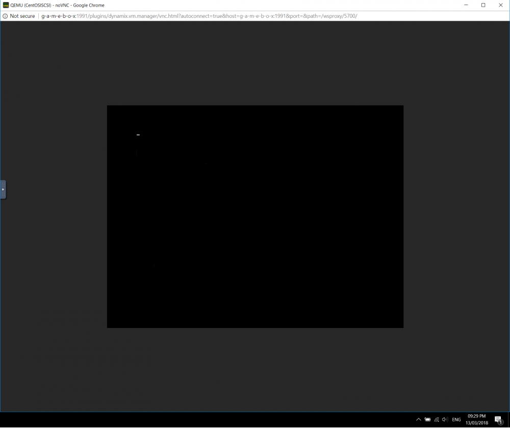

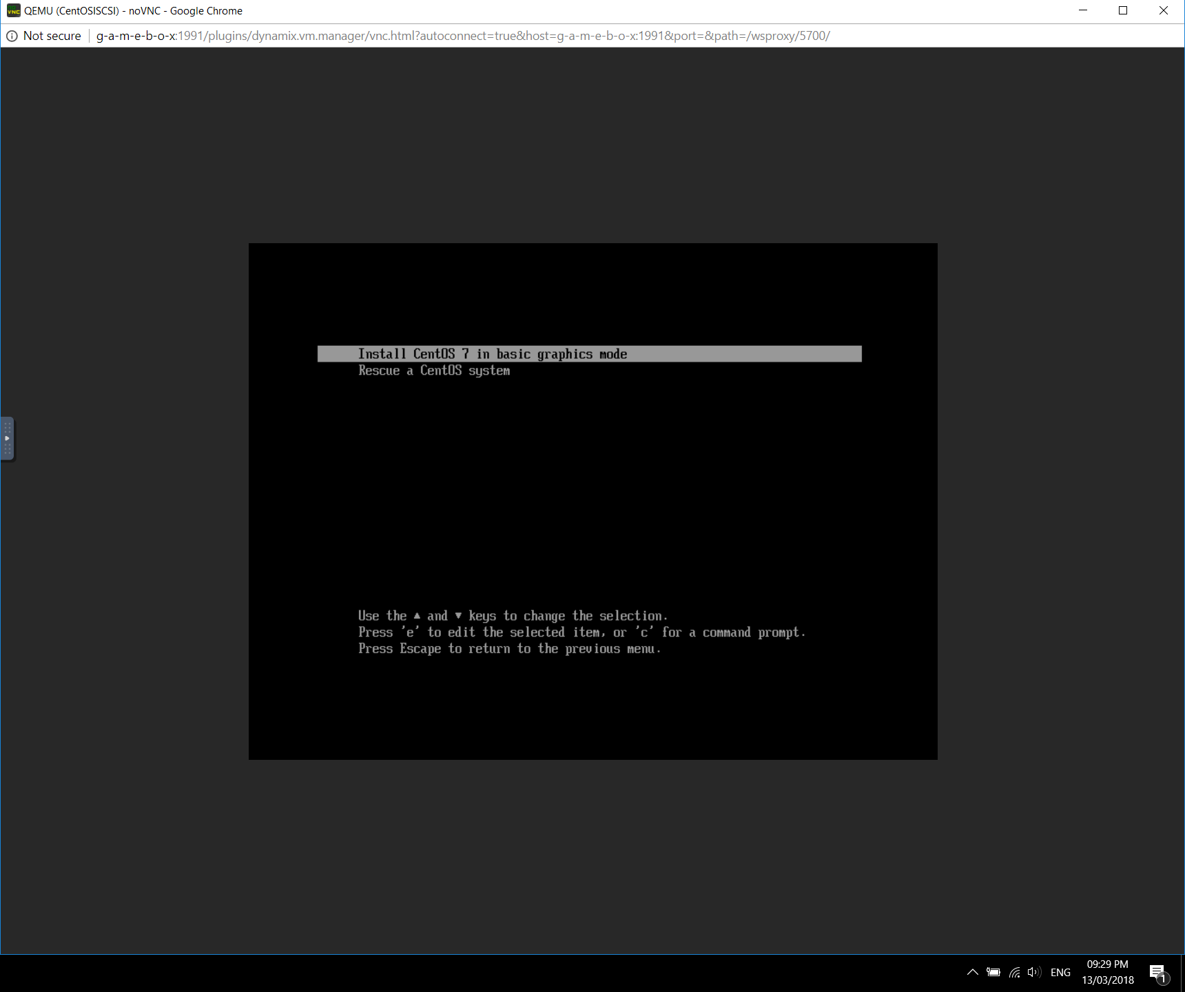

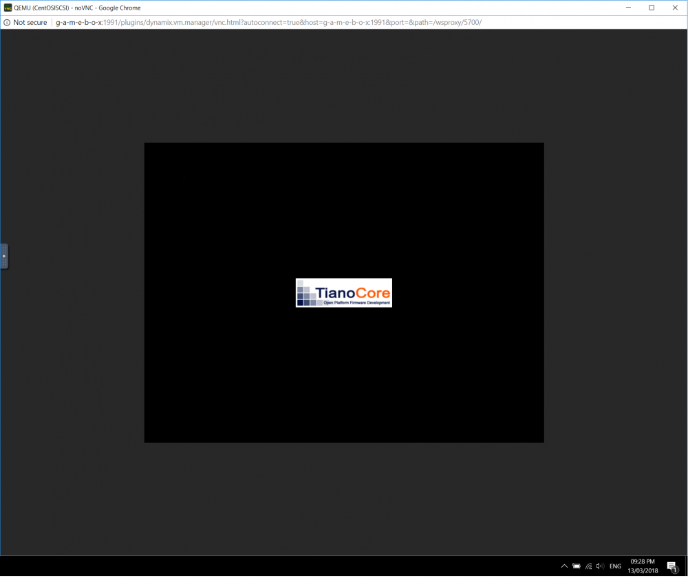

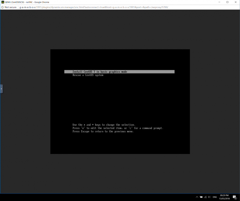

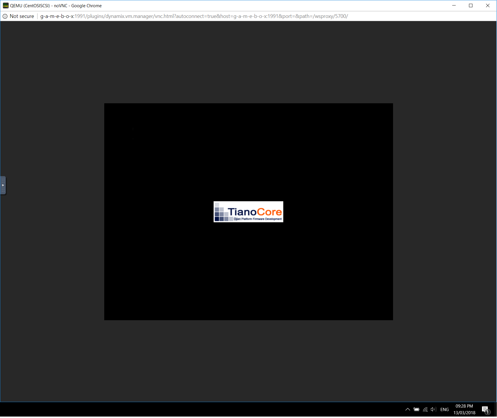

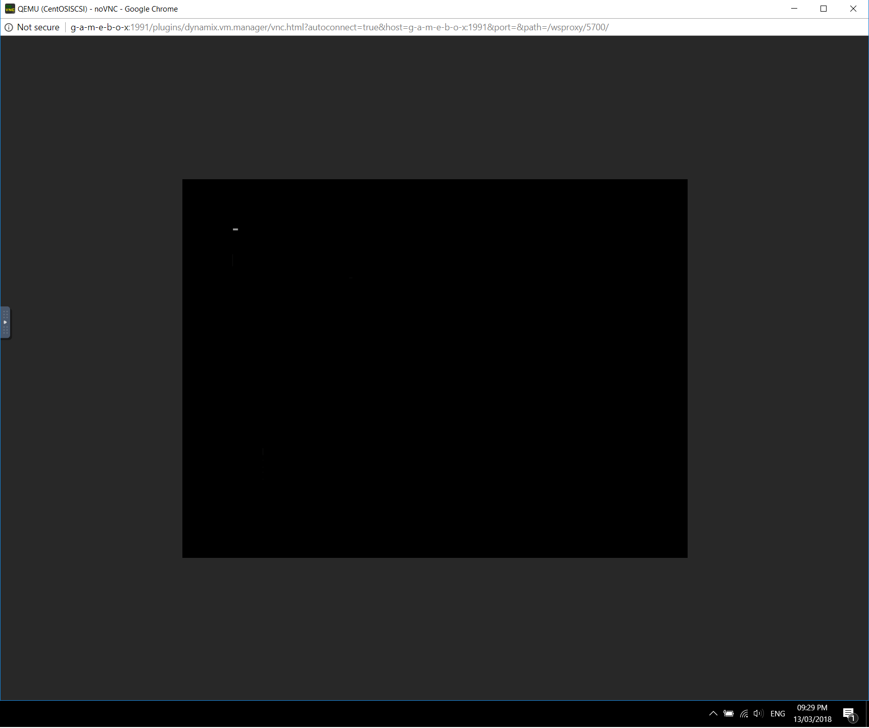

1.png - VM Boots
2.png - installer askes me to select option, i select install
3.png - all i get in the top right corner is a _  and crash.

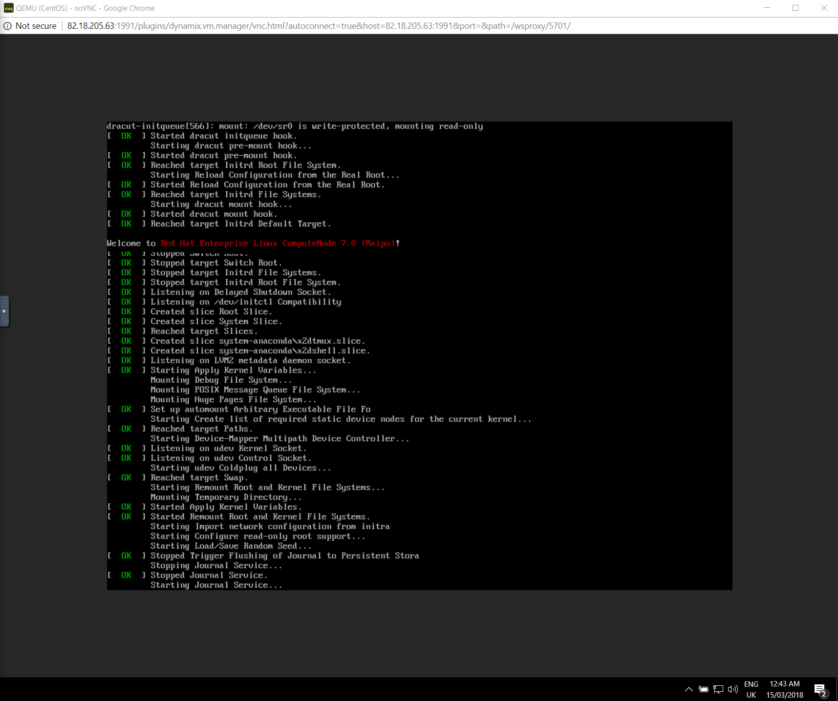

I have tries with all of the Q35's .. same result ... i have also tries SeaBios .. all i keep getting there is kernal panic.. if i try with x440 if i loose my keyboard in VNC
--EDIT--
If i emulate the CPU i get it to boot to the point where it starts the Journal Service then it hangs...
--Config File--

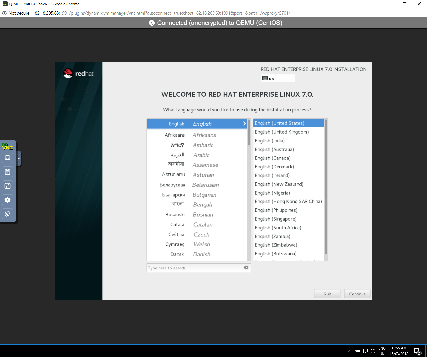

--EDIT-2.0 / 3.0--
fiddling round putting everything back how i have it i have found tha the system boots into the installer if i remove VirtIO from both bus adapters ....
this also hapens with the Bus set to sata .... Setting all buses to usb the system functions

    <nvram>/etc/libvirt/qemu/nvram/9694b0ae-215d-849f-83c5-9fd245e86896_VARS-pure-efi.fd</nvram>
  </os>
  <features>
    <acpi/>
    <apic/>
  </features>
  <cpu>
    <topology sockets='1' cores='1' threads='1'/>
  </cpu>
  <clock offset='utc'>
    <timer name='rtc' tickpolicy='catchup'/>
    <timer name='pit' tickpolicy='delay'/>
  </clock>
  <on_crash>restart</on_crash>
  <devices>
      <source file='/mnt/user/Software/Operating Systems/Linux/Redhat/rhel-server-7.0-x86_64-dvd.iso'/>
      <backingStore/>
      <target dev='hda' bus='usb'/>
      <readonly/>
      <boot order='2'/>
      <alias name='usb-disk0'/>
    </disk>
      <driver name='qemu' type='qcow2' cache='writeback'/>
      <source file='/mnt/user/system/Virtual/CentOS/vdisk1.img'/>
      <backingStore/>
      <target dev='hdc' bus='usb'/>
      <boot order='1'/>
      <alias name='usb-disk2'/>
      <address type='usb' bus='0' port='2'/>
    </disk>
      <alias name='usb'/>
    </controller>
      <alias name='usb'/>
      <master startport='0'/>
    </controller>
      <alias name='usb'/>
      <master startport='2'/>
    </controller>
      <alias name='usb'/>
      <master startport='4'/>
    </controller>
      <alias name='ide'/>
      <address type='pci' domain='0x0000' bus='0x00' slot='0x1f' function='0x2'/>
    </controller>
    <controller type='pci' index='0' model='pcie-root'>
      <alias name='pcie.0'/>
    </controller>
    <controller type='pci' index='1' model='pcie-root-port'>
      <model name='pcie-root-port'/>
      <target chassis='1' port='0x10'/>
      <alias name='pci.1'/>
      <address type='pci' domain='0x0000' bus='0x00' slot='0x02' function='0x0' multifunction='on'/>
    </controller>
    <controller type='pci' index='2' model='pcie-root-port'>
      <target chassis='2' port='0x11'/>
      <alias name='pci.2'/>
      <address type='pci' domain='0x0000' bus='0x00' slot='0x02' function='0x1'/>
    </controller>
    <controller type='pci' index='3' model='pcie-root-port'>
      <target chassis='3' port='0x12'/>
      <alias name='pci.3'/>
      <address type='pci' domain='0x0000' bus='0x00' slot='0x02' function='0x2'/>
    </controller>
    <controller type='pci' index='4' model='pcie-root-port'>
      <target chassis='4' port='0x13'/>
      <alias name='pci.4'/>
      <address type='pci' domain='0x0000' bus='0x00' slot='0x02' function='0x3'/>
    </controller>
    <controller type='pci' index='5' model='pcie-root-port'>
      <target chassis='5' port='0x14'/>
      <alias name='pci.5'/>
      <address type='pci' domain='0x0000' bus='0x00' slot='0x02' function='0x4'/>
    </controller>
      <alias name='virtio-serial0'/>
      <address type='pci' domain='0x0000' bus='0x03' slot='0x00' function='0x0'/>
    </controller>
    <filesystem type='mount' accessmode='passthrough'>
      <source dir='/mnt/user/'/>
      <target dir='UNRAID'/>
      <alias name='fs0'/>
      <address type='pci' domain='0x0000' bus='0x01' slot='0x00' function='0x0'/>
    </filesystem>
    <interface type='bridge'>
      <mac address='52:54:00:af:39:69'/>
      <source bridge='br0'/>
      <target dev='vnet0'/>
      <model type='virtio'/>
      <alias name='net0'/>
      <address type='pci' domain='0x0000' bus='0x02' slot='0x00' function='0x0'/>
    </interface>
    <serial type='pty'>
      <source path='/dev/pts/1'/>
        <model name='isa-serial'/>
      </target>
      <alias name='serial0'/>
    </serial>
    <console type='pty' tty='/dev/pts/1'>
    </console>
    <channel type='unix'>
      <source mode='bind' path='/var/lib/libvirt/qemu/channel/target/domain-51-CentOS/org.qemu.guest_agent.0'/>
      <target type='virtio' name='org.qemu.guest_agent.0' state='disconnected'/>
      <alias name='channel0'/>
    </channel>
      <alias name='input0'/>
      <address type='usb' bus='0' port='3'/>
    </input>
    <input type='mouse' bus='ps2'>
      <alias name='input1'/>
    </input>
    <input type='keyboard' bus='ps2'>
      <alias name='input2'/>
    </input>
    <graphics type='vnc' port='5901' autoport='yes' websocket='5701' listen='0.0.0.0' keymap='en-gb'>
    </graphics>
    <video>
      <alias name='video0'/>
      <address type='pci' domain='0x0000' bus='0x00' slot='0x01' function='0x0'/>
    </video>
    <memballoon model='virtio'>
      <alias name='balloon0'/>
      <address type='pci' domain='0x0000' bus='0x04' slot='0x00' function='0x0'/>
    </memballoon>
  </devices>
  <seclabel type='dynamic' model='dac' relabel='yes'>
    <label>+0:+100</label>
    <imagelabel>+0:+100</imagelabel>
  </seclabel>
</domain>
