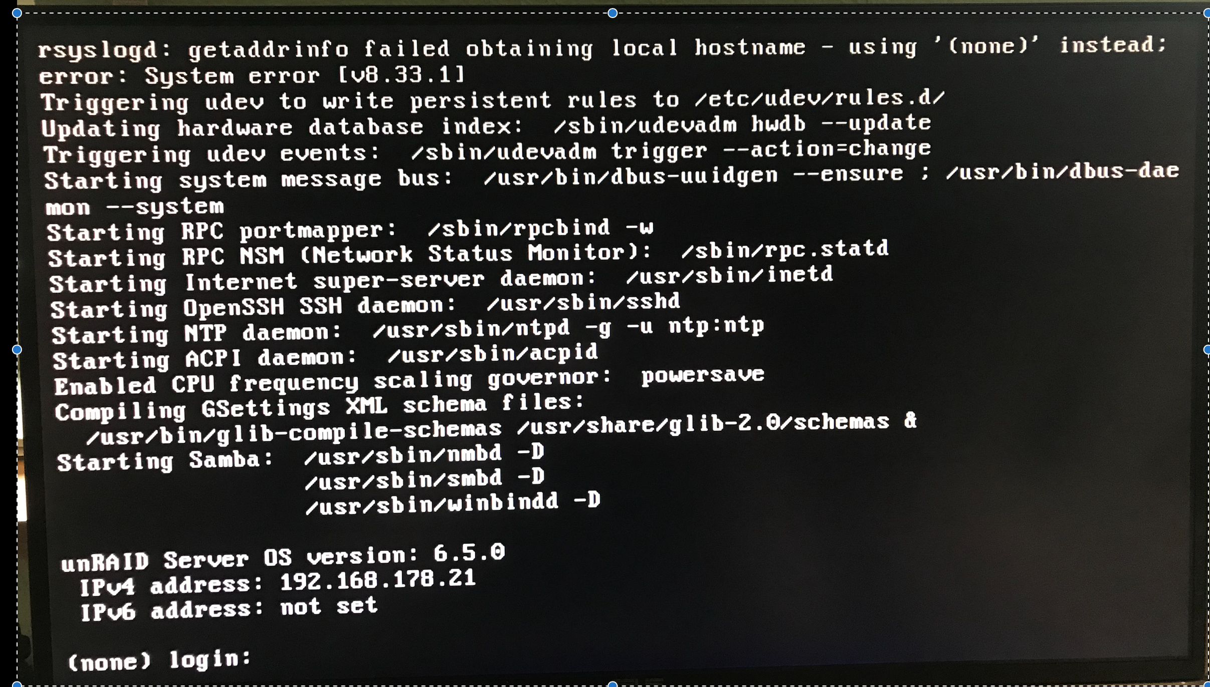

I can ping. But i cant enter Webgui
unRAID Server OS version 6.5.0
IPv4 adress: 192.168.178.21
IPv6 adress: not set
(none) login:
(before updating it called Gaming NAS Login)

Please take photographs of the screens that you have discussed in your posts.  (Note to @trurl and @Cessquill, OP is in Europe and I suspect, English is not his first language.)

The embedded space character is likely the problem. From that link Frank1940 pointed you to earlier:
On 1/16/2018 at 11:38 PM, ljm42 said:
Ensure your server name does not include invalid characters, or you will have problems in 6.5.x. Only 'A-Z', 'a-z', '0-9', dashes ('-'), and dots ('.') are allowed, and the name must be 15 characters or less. To fix this, go to Settings -> Identification and change the "Server name". (see this)

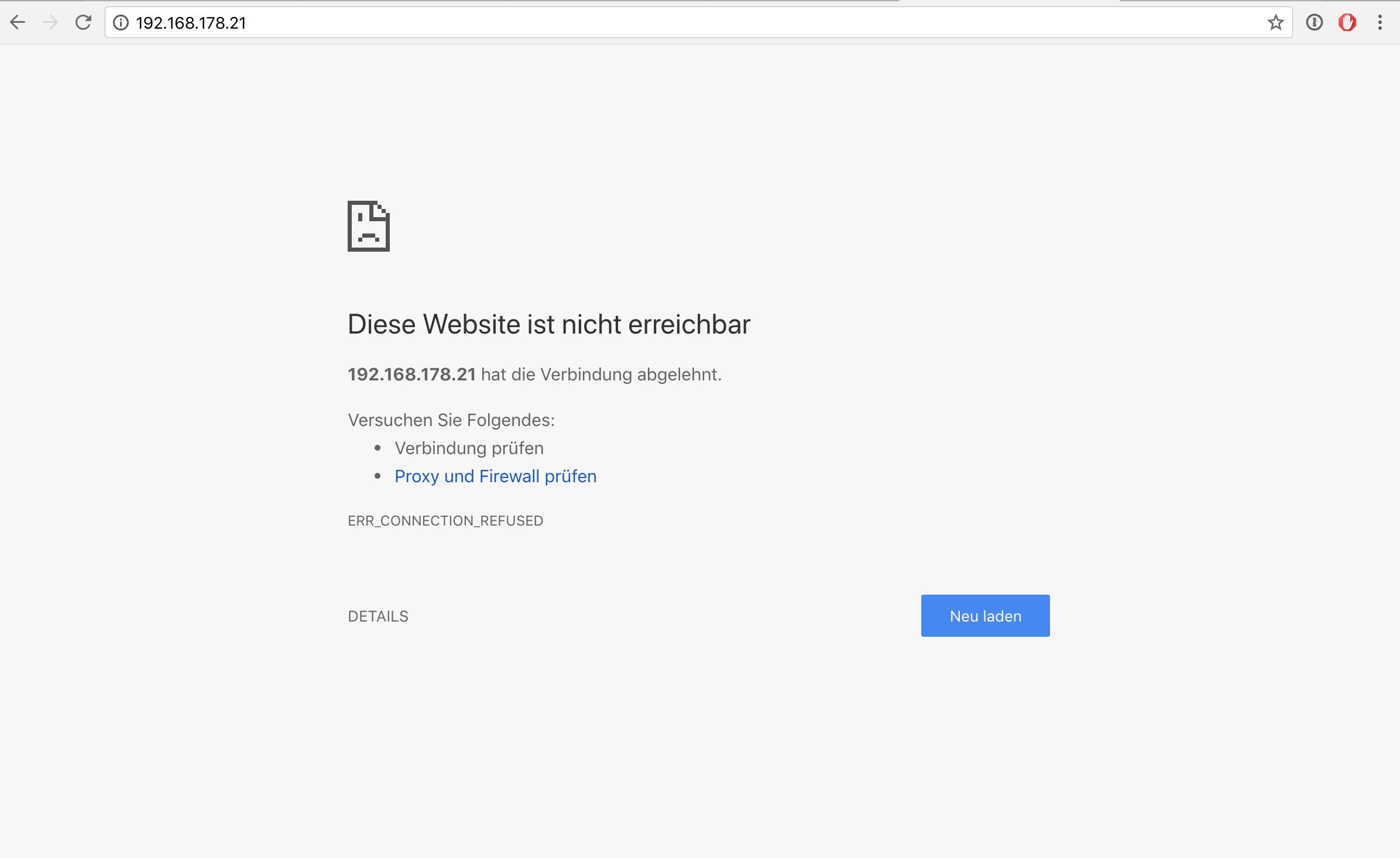

No i cant enter. This is the problem.

13 minutes ago, unknown said:
On my display (unraid console)
One more thing to try if you haven't solved it yet.   Shutdown the server and pull your flash drive out.  Plug it into a another computer (perferably a Windows computer) and open up the file indent.cfg   in the config  folder/directory.    Find the line that starts with     USE_SSL=    and change  the parameter so it reads      USE_SSL="no"
In that same file, find the line that begins with  NAME=  and change the parameter to one that does not contain a space.  For example,  "My Server"  is  not allowed, but "MyServer" or "My_Server" are good.
I’m currently texting with OP in German.
Seems to be that there could be spaces in the Hostname.
According to the above, underscore is not a valid character though hyphen is. So "My_Server" is not allowed but "My-Server" is good.
After rename to "gaming" it works. Thanks :)

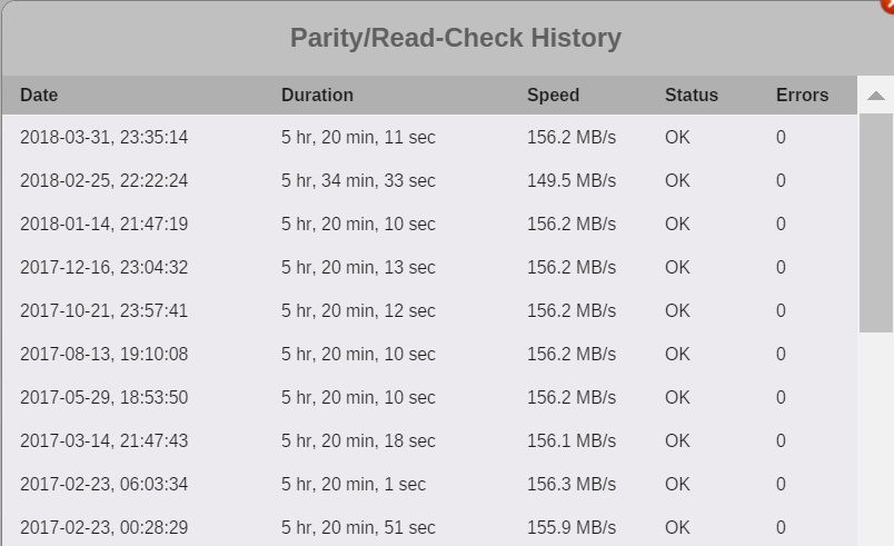

Two pages back:
Very nice to see that the Parity Check speed lost between 6.4.0 and 6.4.1 was regained in 6.5.0.
