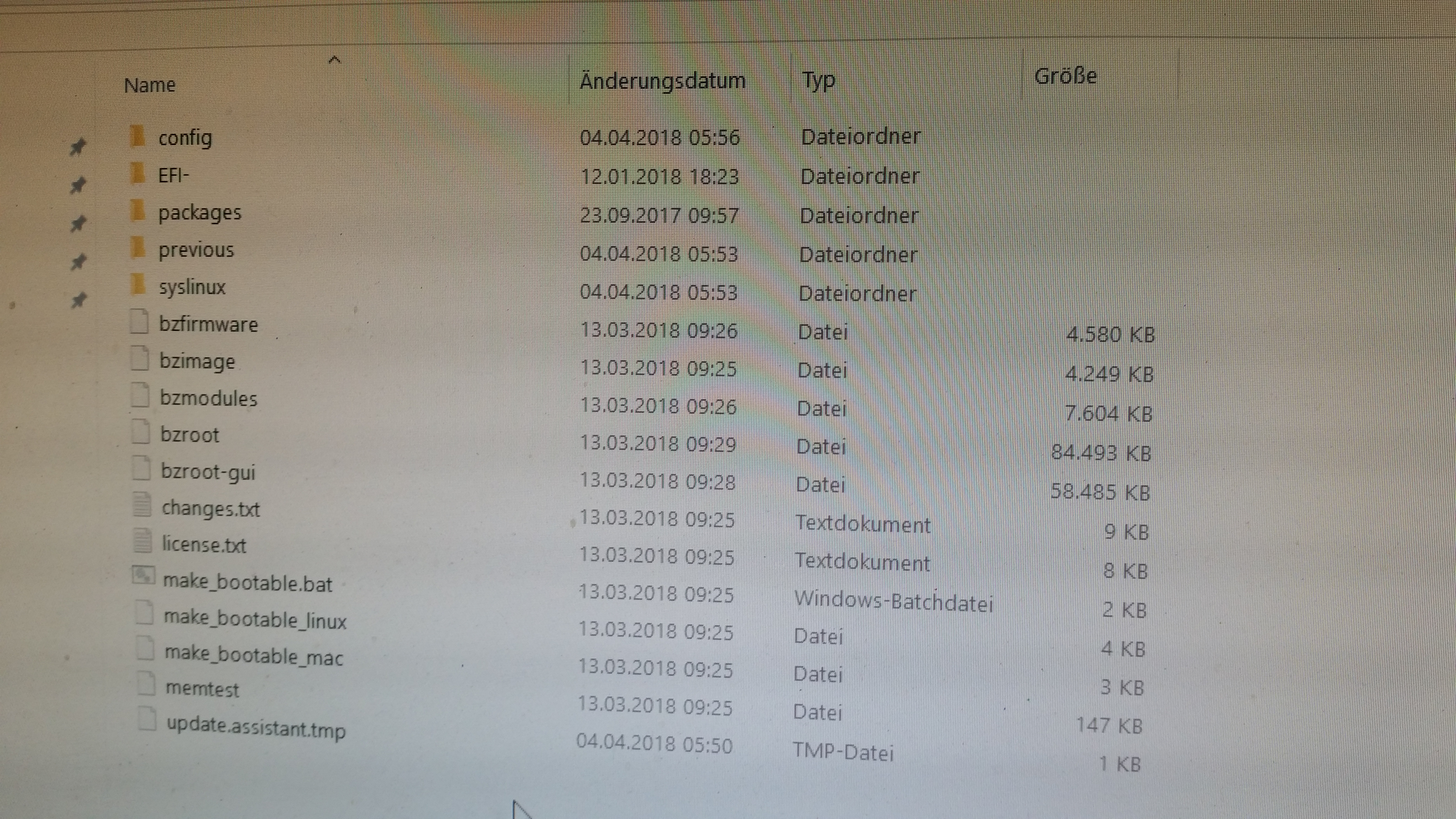

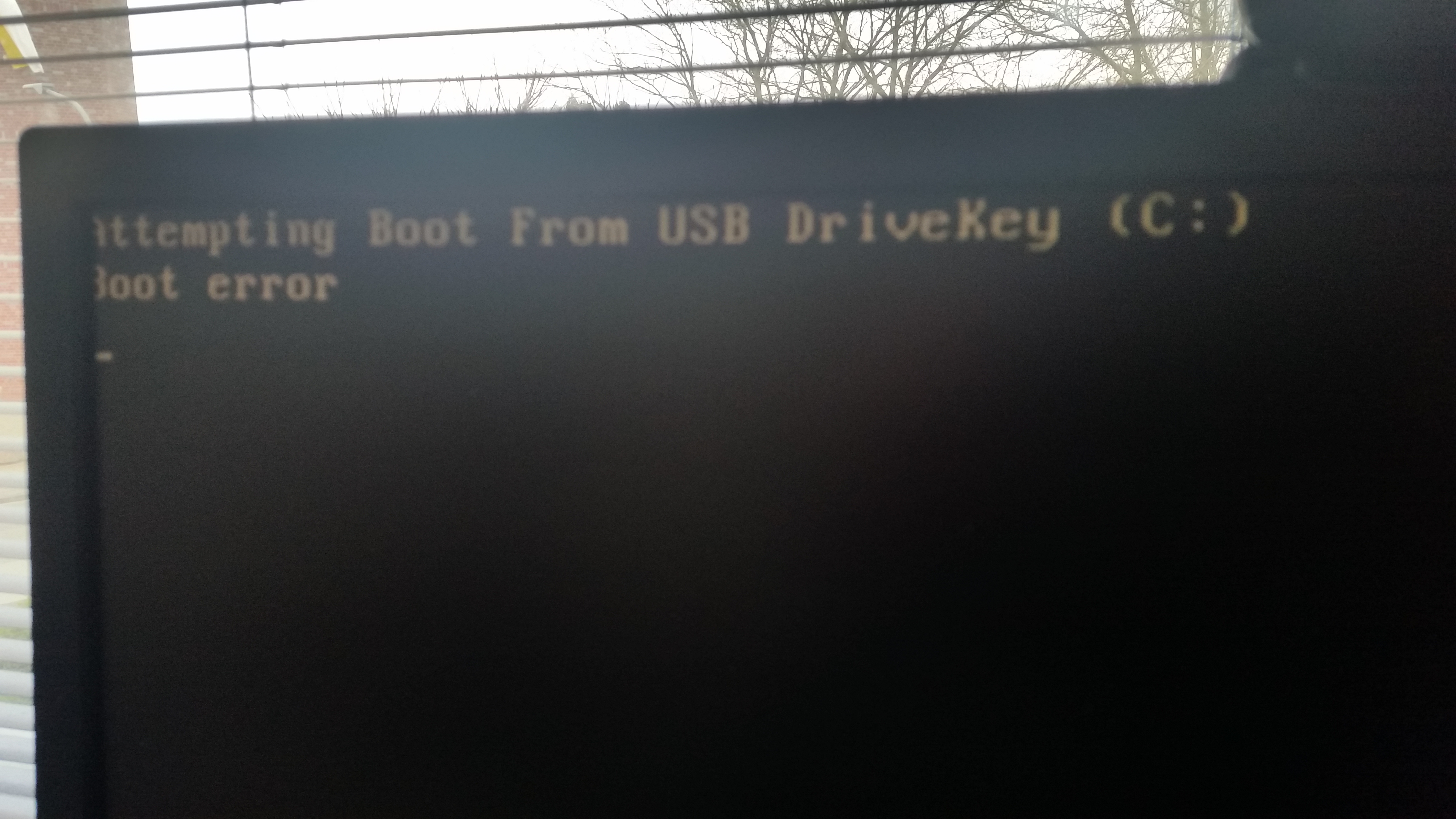

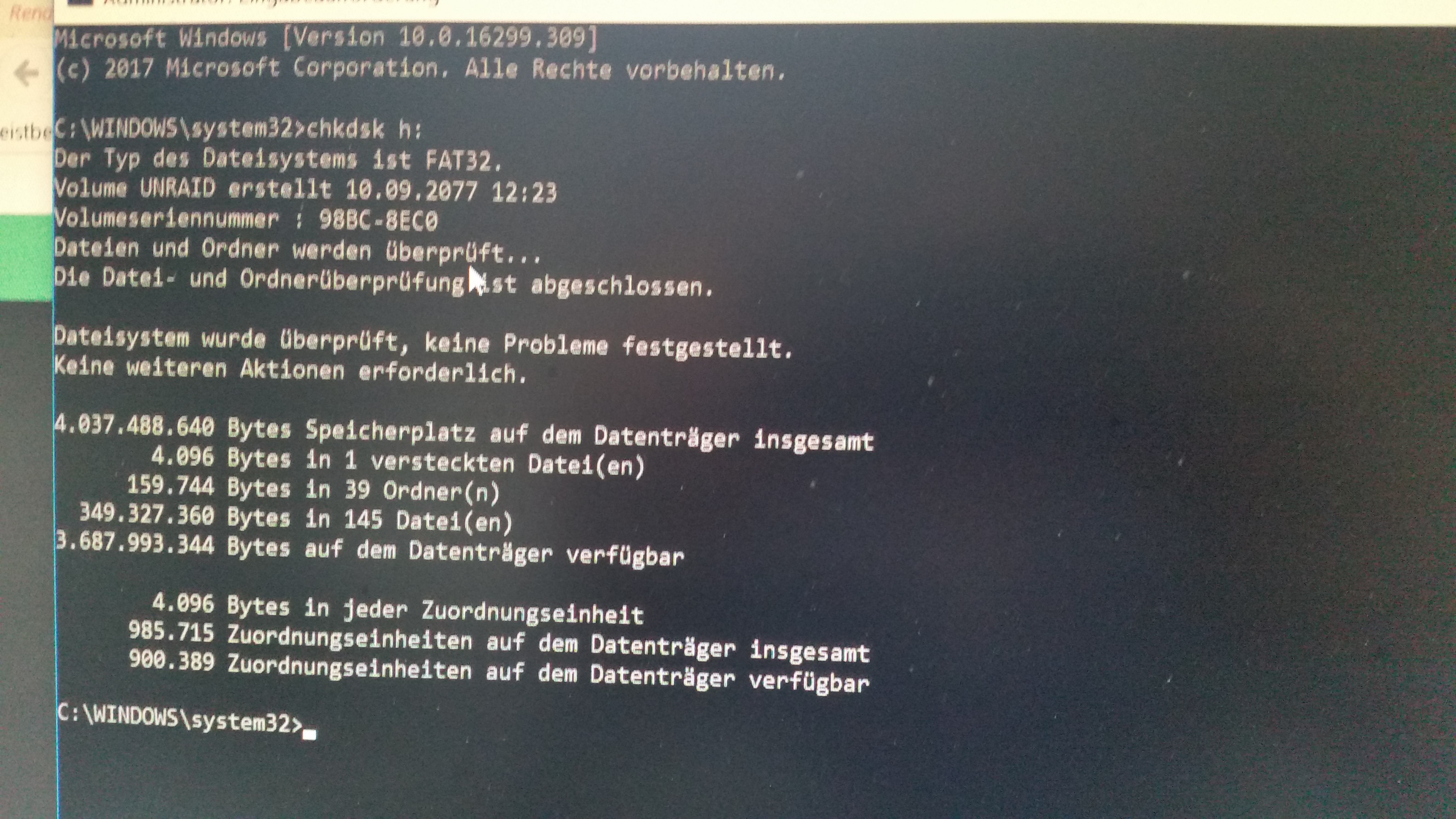

added 3 photos with results
Click on the file 'make_bootable.bat' - might have to right-click and select Run as Administrator.

What is going on with          erstellt 10.9.2077      in the second photograph.
Somehow looks to be created in about 59 years time...?

run  make_bootable.bat in windows machine as administrator ?
....don´t know why that time is shown !
Edited by doppelt
thanks again.
make_bootable solved the problem and its back to life.
