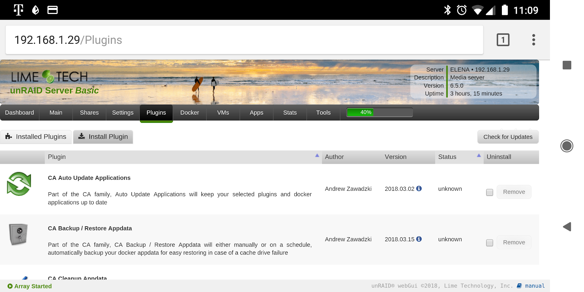

Ever since 6.5 update i'm unable to manually update plugins. When i click "check for updates" it appears to do the check but then the page reloads with "unknown" status. The plugin page also loads really slowly. I setup CA Autoupdate for now but seem like something isn't working properly. I did try reverting back to 6.4.1 and it works fine. Anyone got any ideas?
Tools - Diagnostics, post complete zip.
elena-diagnostics-20180317-2125.zip
This means your internet connection is broken. Usual suspect is your DNS settings for name resolving.
If not sure which DNS servers to use then change network settings to 8.8.8.8 and 8.8.4.4 (Google DNS servers)
@bonienl I updated my DNS settings as you suggested but the issue remains. Seems my original post wasn't very clear. CA Autoupdate works fine. it updates the plugins with out an issue. The problem is the plugin page loads slow and does appear to check for updates but then reloads the page completely with the same "unknown" status on all plugins.
Not sure which “check for updates” button you’re using. Do you have Advanced Buttons installed? Fairly sure it’s still incompatible.
This is the "Check for Updates" buttons i am referring to. If you disable the plugin update notification in settings the button will show back up. Screenshot is from my phone cause it was easy. I normally use my desktop.
