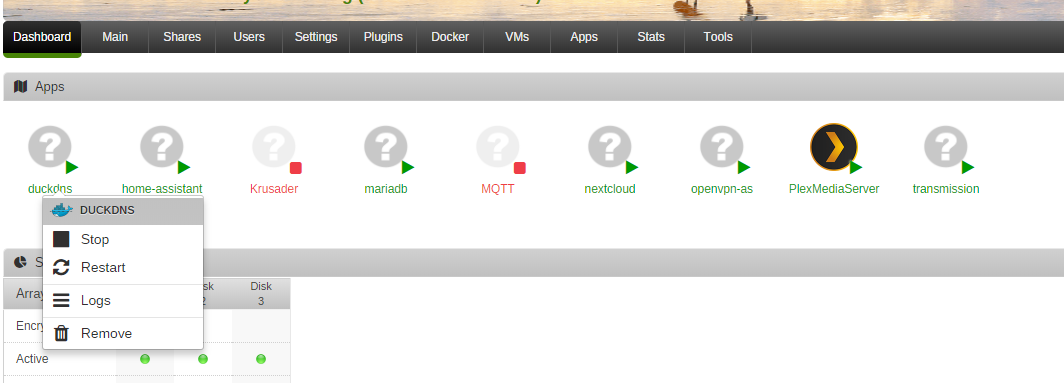

I've just intalled a new hard drive to my array. No cache, no parity yet, just data drives.
When i started my server some of my plugins disappeared from the plugins menu.
And i cant access my docker settings from the dashboard (see attached picture).
Also the docker icon images gone.
Other than this the dockers seems to function fine, but its anoying that i can't excess the configuration for them.

The reason this is happening is because the templates stored in /config/plugins/dockerMan/templates-user are either corrupt or missing.  You'll probably also notice that if updating them on the docker tab it'll complain with a message saying "Was this application created using dockerman?"
Your fix is if you have a backup of the flash drive to restore that directory.  Barring that, from the docker page, take a screenshot of all your path mappings, then remove those apps and reinstall them via Apps and adjust the templates accordingly.

I did that, all back to normal. Should i do something to avoid this in the future?
If everything appears to be working fine, all the fsck files are safe to delete.  Its recovered files from filesystem fix on the flashdrive that would've been caused most likely by an unclean shutdown at somepoint.
