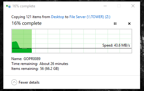

I'll include a graph of my file transfer (from computer, to server).  It started at 110 mb/s and then dropped to ~40.  I did this the other day however, and it was ALL over the place - up and down and up and down, dropping as low as 12-14 mb/s?!?!
Anyways, hoping someone can help me diagnose!

The speed of 100MBps is roughly what you get when you are using a Gigabit network as that is the maximum the network supports.
a speed of ~40MBps is not atypical for writing directly to a parity protected array (i.e. to a share that is not set up to use a cache drive).    That is because the architecture of unRAID means each ‘write’ to an array drive in unRAID actually involves 2 reads and 2 writes.    You then need to take into account the linux Level caching which can mean writes vary between these extremes.
Edited by itimpi
Ah.. ok, so do you think a cache SSD would resolve this issue?
What are your thoughts on the inconsistent (all over the place) results that happened the other day?

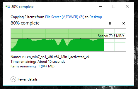

Here's a graph of the writes... a little inconsistent, but probably not an issue?
This is when I copy a 6GB file to my cache pool. It saturates my 1Gbps link.
