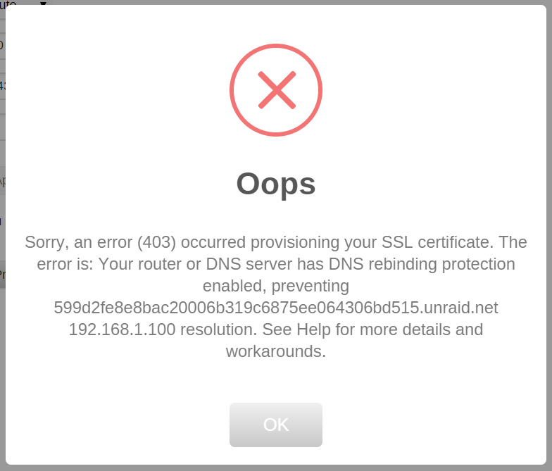

I wonder if anyone can help me get to the bottom of my problem trying to get an SSL Certificate.
I am running v.6.4.1, have an EdgeRouter-X router and cannot seem to get a certificate, I keep getting the same error screen:

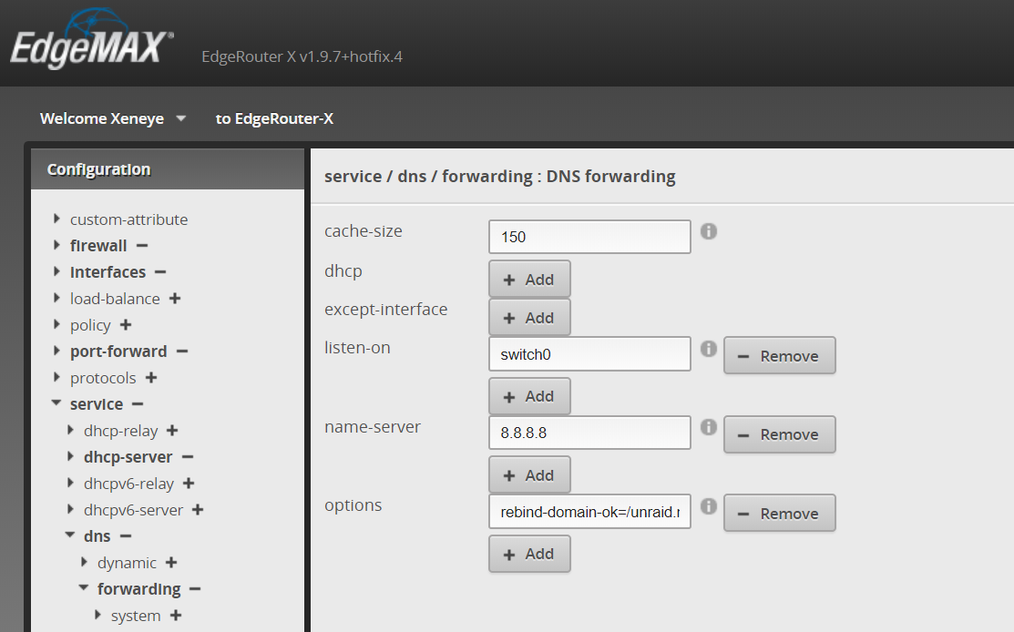

I have searched the forums and followed both the solutions for my router via both CLI and GUI, here's what my router settings are showing:

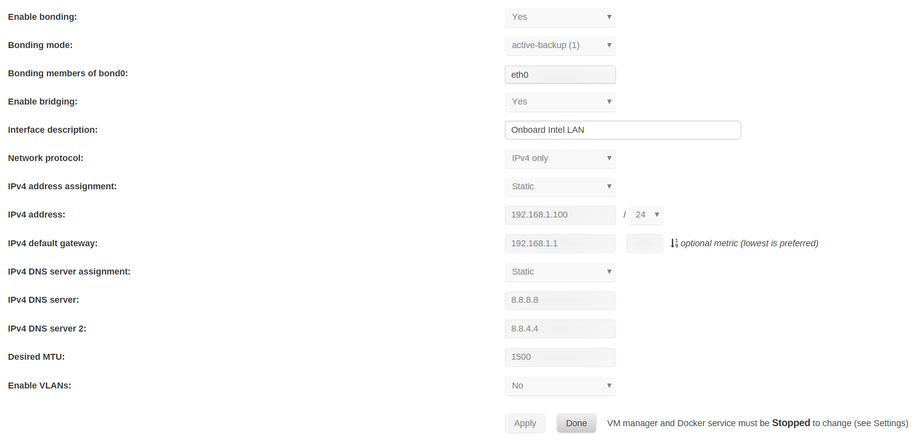

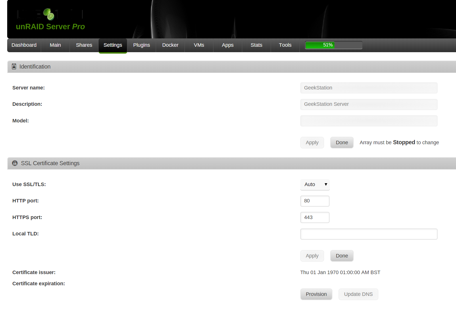

And my unRAID settings are as follows:
I have my DNS settings on both the router and unRAID set to use Google's 8.8.8.8 & 8.8.4.4.
When I get the 'Oops' error it creates a .pem file within my USB Flash drives /config/ssl/certs folder, I have tried deleting that and retrying, the same cycle occurs every time.
Can anyone spot where I am going wrong?

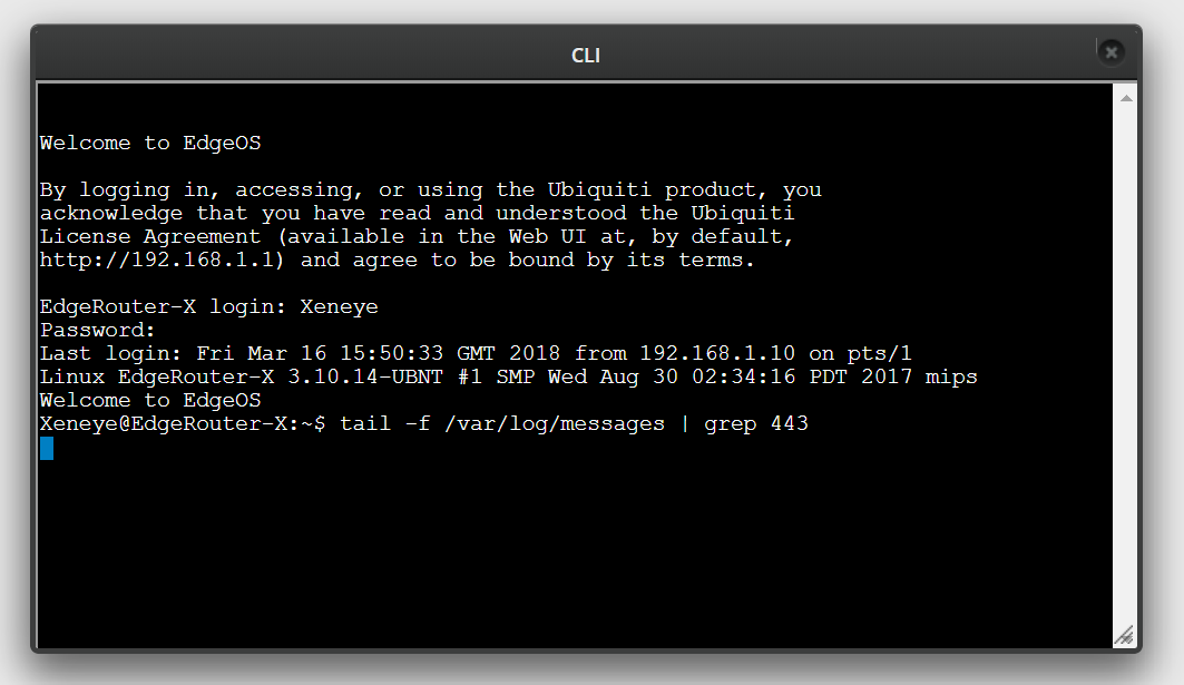

from the ubiquiti CLI try this command:
tail -f /var/log/messages | grep  443
Then try it again and post the results
Also, if you can, post your ACL's
I've typed the command into the cli, but it doesn't seem to do much, just starts the command but the cursor just sits there flashing until I close the window.
I tried to get the SSL provisioning to go while this was command was running, but am getting the same result.

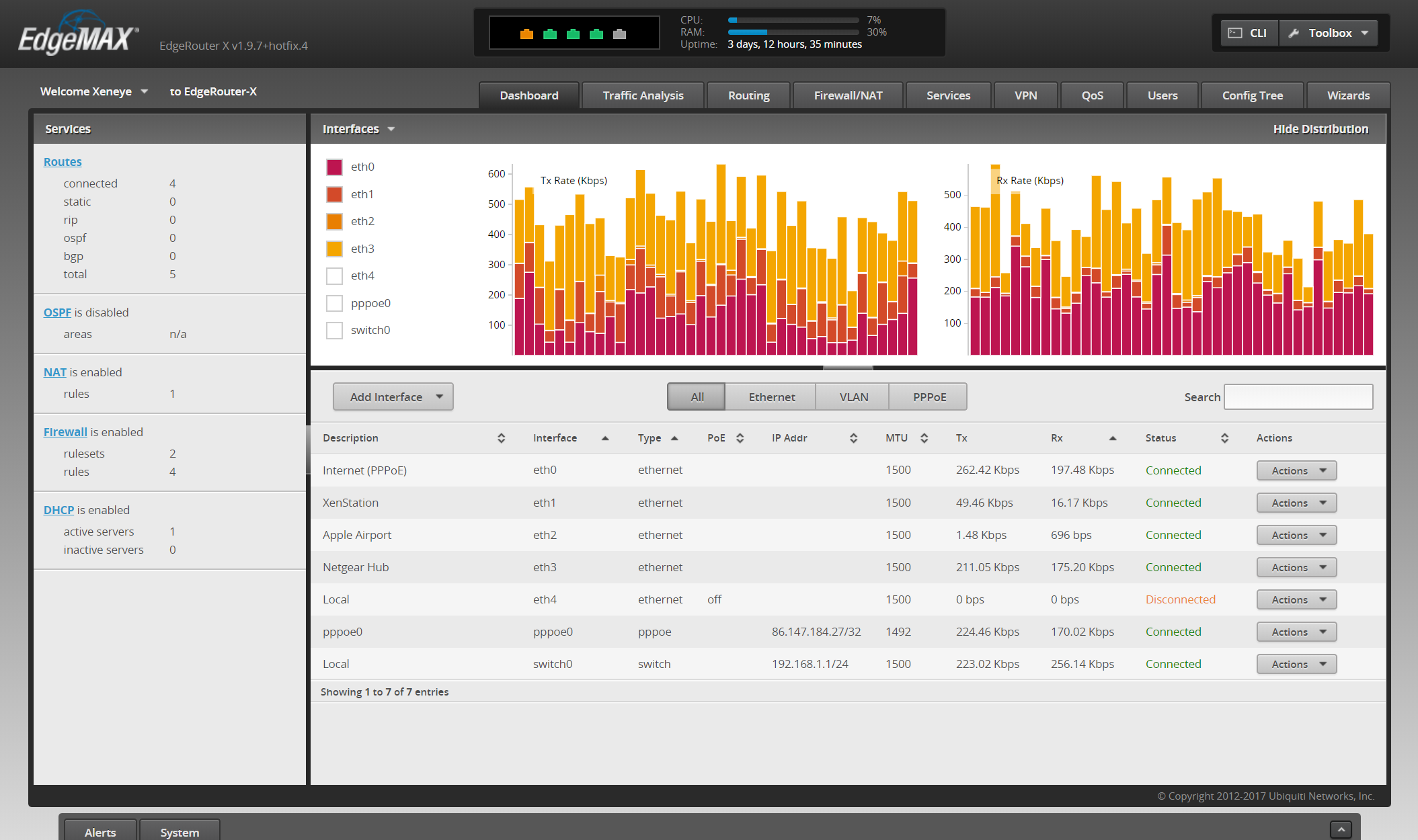

I have BT fibre connection going straight into the Edgerouter, connecting via pppoe, from there it's just LAN connections through a Netgear switch, and my Apple Airport Extreme is handling the Wi-Fi side of things.

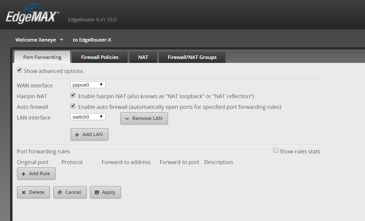

Do you have ACL's for your Local network as well? I have local firewall rules,  because I only allow certain IP's out to the internet and I separate out the guest network. But I take it the unraid server can already get out to the internet anyways. Just a thought.
While we're at it, whats in your port forwarding tab?
Okay, I've just enabled the logging on both WAN_IN & WAN_LOCAL and the log file is as follows straight after trying to get the SSL certificate:

I have no local port forwarding rules configured
I've updated the Router to the latest v1.10.0 and rebooted it, but still the same result.

Your router is using DHCP and receives not just the IP but also the DNS servers from your ISP.
Okay, thought that was it, just managed to edit the /etc/resolv.conf file and remove those DNS servers.
If you meant /etc/resolv.conf on unraid, they will return if you reboot, since changes to resolv.conf are not persistent.
No sorry, I should have been clearer, it was on the router that I changed it.

Sorry man, can you grep your messages from the router while trying to run the ssl certificate
Also, can you remove 8.8.8.8 from the name-server from the DNS forward section
No open ports are required for this - it uses a different type of Lets Encrypt authentication than the Lets Encrypt docker does
Your first screenshot shows that it is trying to configure this FQDN:
  599d2fe8e8bac20006b319c6875ee064306bd515.unraid.net
If I nslookup that address, it returns 10.0.1.100, which is odd because the screenshot shows it is trying to set it to 192.168.1.100.  Is your server still on 192.168.1.100 or did you change things around?
I'm not sure what is going on here. Are you double-nat'd? (I'm not sure that would make a difference)
I've removed the 8.8.8.8, and a weird thing, I run the grep command, looked at the messages after running the ssl provisioning, and it was a huge file, so I deleted it, created a new messages file, tried again, but there is nothing in there it's just empty?
Everytime I run the grep command I have to press ctrl-c after the ssl failure message, is this right, as it's the only thing that will get me back to a command prompt?
sudo service rsyslog restart
that should restart the logging
Now that's interesting, my server used to be 10.0.1.100 when I had my Apple Airport Extreme, but when I got the EdgeRouter-X I changed it to 192.168.1.100.
I've changed the IP address in the network settings panel, and everything else is working fine connecting to it, but somewhere there must be a setting that's still on the old IP address.
Any ideas whereabouts the old IP may be lurking that needs changing?

Don't think I am, there is a setting in the router:
Hairpin NAT, Enable hairpin NAT (also known as "NAT loopback" or "NAT reflection")
It's enabled by default, but I've tried disabling it, but have the same result.

Thank you, the results are as follows:
Mar 21 19:19:17 EdgeRouter-X rsyslogd: set SCM_CREDENTIALS failed on '/dev/log': Protocol not available
Mar 21 19:19:19 EdgeRouter-X kernel: [WAN_LOCAL-default-D]IN=pppoe0 OUT= MAC=20:31:39:3a:31:38:3a:35:30:20:73:75:64:6f:3a:20:70:61:6d:5f:75:6e SRC=86.143.107.126 DST=255.255.255.255 LEN=32 TOS=0x00 PREC=0x00 TTL=64 ID=13017 DF PROTO=UDP SPT=40451 DPT=10001 LEN=12
Mar 21 19:19:19 EdgeRouter-X kernel: [WAN_LOCAL-default-D]IN=pppoe0 OUT= MAC=00:00:00:00:08:00:45:00:00:97:25:00:40:00:40:11:92:03:c0:a8:01:01 SRC=86.143.107.126 DST=255.255.255.255 LEN=151 TOS=0x00 PREC=0x00 TTL=64 ID=13018 DF PROTO=UDP SPT=46517 DPT=45948 LEN=131
Mar 21 19:19:19 EdgeRouter-X kernel: [WAN_LOCAL-default-D]IN=pppoe0 OUT= MAC=00:00:00:00:08:00:45:00:00:97:25:01:40:00:40:11:92:02:c0:a8:01:01 SRC=86.143.107.126 DST=255.255.255.255 LEN=151 TOS=0x00 PREC=0x00 TTL=64 ID=13019 DF PROTO=UDP SPT=50671 DPT=55025 LEN=131
Mar 21 19:19:19 EdgeRouter-X kernel: [WAN_LOCAL-default-D]IN=pppoe0 OUT= MAC=00:00:00:00:08:00:45:00:00:97:25:02:40:00:40:11:92:01:c0:a8:01:01 SRC=86.143.107.126 DST=255.255.255.255 LEN=151 TOS=0x00 PREC=0x00 TTL=64 ID=13020 DF PROTO=UDP SPT=54692 DPT=59480 LEN=131
Mar 21 19:19:20 EdgeRouter-X kernel: [WAN_LOCAL-default-D]IN=pppoe0 OUT= MAC=00:00:00:00:08:00:45:00:00:97:25:03:40:00:40:11:92:00:c0:a8:01:01 SRC=86.143.107.126 DST=255.255.255.255 LEN=151 TOS=0x00 PREC=0x00 TTL=64 ID=13021 DF PROTO=UDP SPT=33693 DPT=48133 LEN=131
Mar 21 19:19:20 EdgeRouter-X kernel: [WAN_LOCAL-default-D]IN=pppoe0 OUT= MAC=00:00:00:00:08:00:45:00:00:97:25:04:40:00:40:11:91:ff:c0:a8:01:01 SRC=86.143.107.126 DST=255.255.255.255 LEN=151 TOS=0x00 PREC=0x00 TTL=64 ID=13022 DF PROTO=UDP SPT=52694 DPT=37805 LEN=131
Mar 21 19:19:20 EdgeRouter-X kernel: [WAN_LOCAL-default-D]IN=pppoe0 OUT= MAC=00:00:00:00:08:00:45:00:00:97:25:05:40:00:40:11:91:fe:c0:a8:01:01 SRC=86.143.107.126 DST=255.255.255.255 LEN=151 TOS=0x00 PREC=0x00 TTL=64 ID=13023 DF PROTO=UDP SPT=54071 DPT=52598 LEN=131
Mar 21 19:19:20 EdgeRouter-X kernel: [WAN_LOCAL-default-D]IN=pppoe0 OUT= MAC=00:00:00:00:08:00:45:00:00:97:25:06:40:00:40:11:91:fd:c0:a8:01:01 SRC=86.143.107.126 DST=255.255.255.255 LEN=151 TOS=0x00 PREC=0x00 TTL=64 ID=13024 DF PROTO=UDP SPT=59979 DPT=58830 LEN=131
Mar 21 19:19:27 EdgeRouter-X kernel: [WAN_LOCAL-default-D]IN=pppoe0 OUT= MAC=78:8a:20:bc:a4:81:10:e8:78:a7:72:bf:88:64:11:00:03:66:00:26:00:21 SRC=0.0.0.0 DST=224.0.0.1 LEN=36 TOS=0x00 PREC=0xC0 TTL=1 ID=31791 DF PROTO=2
Mar 21 19:19:35 EdgeRouter-X kernel: [WAN_LOCAL-default-D]IN=pppoe0 OUT= MAC=78:8a:20:bc:a4:81:10:e8:78:a7:72:bf:88:64:11:00:03:66:00:2a:00:21 SRC=52.174.22.252 DST=86.143.107.126 LEN=40 TOS=0x00 PREC=0x00 TTL=239 ID=53784 PROTO=TCP SPT=56006 DPT=33896 WINDOW=1024 RES=0x00 SYN URGP=0
Mar 21 19:19:50 EdgeRouter-X kernel: [WAN_LOCAL-default-D]IN=pppoe0 OUT= MAC=00:00:00:00:00:00:10:00:07:00:00:00:00:00:00:00:00:00:00:00:00:00 SRC=86.143.107.126 DST=255.255.255.255 LEN=32 TOS=0x00 PREC=0x00 TTL=64 ID=13902 DF PROTO=UDP SPT=60187 DPT=10001 LEN=12
Mar 21 19:19:50 EdgeRouter-X kernel: [WAN_LOCAL-default-D]IN=pppoe0 OUT= MAC=00:00:00:00:08:00:45:00:00:97:32:da:40:00:40:11:84:29:c0:a8:01:01 SRC=86.143.107.126 DST=255.255.255.255 LEN=151 TOS=0x00 PREC=0x00 TTL=64 ID=13903 DF PROTO=UDP SPT=56661 DPT=32950 LEN=131
Mar 21 19:19:50 EdgeRouter-X kernel: [WAN_LOCAL-default-D]IN=pppoe0 OUT= MAC=00:00:00:00:08:00:45:00:00:97:32:db:40:00:40:11:84:28:c0:a8:01:01 SRC=86.143.107.126 DST=255.255.255.255 LEN=151 TOS=0x00 PREC=0x00 TTL=64 ID=13904 DF PROTO=UDP SPT=43866 DPT=51247 LEN=131
Mar 21 19:19:50 EdgeRouter-X kernel: [WAN_LOCAL-default-D]IN=pppoe0 OUT= MAC=00:00:00:00:08:00:45:00:00:97:32:dc:40:00:40:11:84:27:c0:a8:01:01 SRC=86.143.107.126 DST=255.255.255.255 LEN=151 TOS=0x00 PREC=0x00 TTL=64 ID=13905 DF PROTO=UDP SPT=41702 DPT=59764 LEN=131
Mar 21 19:19:50 EdgeRouter-X kernel: [WAN_LOCAL-default-D]IN=pppoe0 OUT= MAC=00:00:00:00:08:00:45:00:00:97:32:dd:40:00:40:11:84:26:c0:a8:01:01 SRC=86.143.107.126 DST=255.255.255.255 LEN=151 TOS=0x00 PREC=0x00 TTL=64 ID=13906 DF PROTO=UDP SPT=35123 DPT=32859 LEN=131
Mar 21 19:19:50 EdgeRouter-X kernel: [WAN_LOCAL-default-D]IN=pppoe0 OUT= MAC=00:00:00:00:08:00:45:00:00:97:32:de:40:00:40:11:84:25:c0:a8:01:01 SRC=86.143.107.126 DST=255.255.255.255 LEN=151 TOS=0x00 PREC=0x00 TTL=64 ID=13907 DF PROTO=UDP SPT=46889 DPT=48533 LEN=131
Mar 21 19:19:50 EdgeRouter-X kernel: [WAN_LOCAL-default-D]IN=pppoe0 OUT= MAC=00:00:00:00:08:00:45:00:00:97:32:df:40:00:40:11:84:24:c0:a8:01:01 SRC=86.143.107.126 DST=255.255.255.255 LEN=151 TOS=0x00 PREC=0x00 TTL=64 ID=13908 DF PROTO=UDP SPT=58430 DPT=58669 LEN=131
Mar 21 19:19:50 EdgeRouter-X kernel: [WAN_LOCAL-default-D]IN=pppoe0 OUT= MAC=00:00:00:00:08:00:45:00:00:97:32:e0:40:00:40:11:84:23:c0:a8:01:01 SRC=86.143.107.126 DST=255.255.255.255 LEN=151 TOS=0x00 PREC=0x00 TTL=64 ID=13909 DF PROTO=UDP SPT=42752 DPT=46856 LEN=131
Cool, but your output doesn't show anything with 443
That's all that I have in the log, I ran the ssl request at 19:19, so just grabbed all the data from the messages file within that time stamp?
Time to consider what routes you have - exactly where do your machine want to route your SSL requests?
And another thing - is your router logging outgoing traffic? All your log shows is traffic arriving on the pppoe0 interface.
