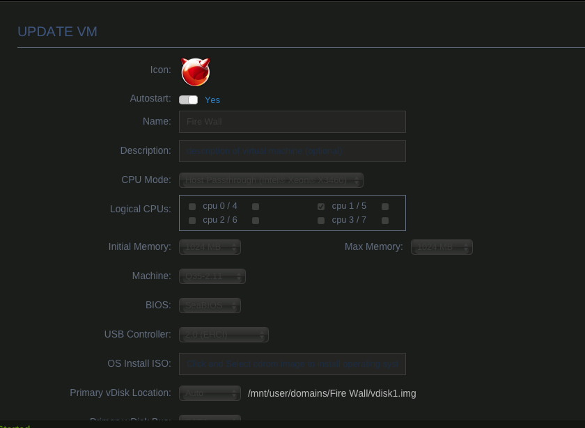

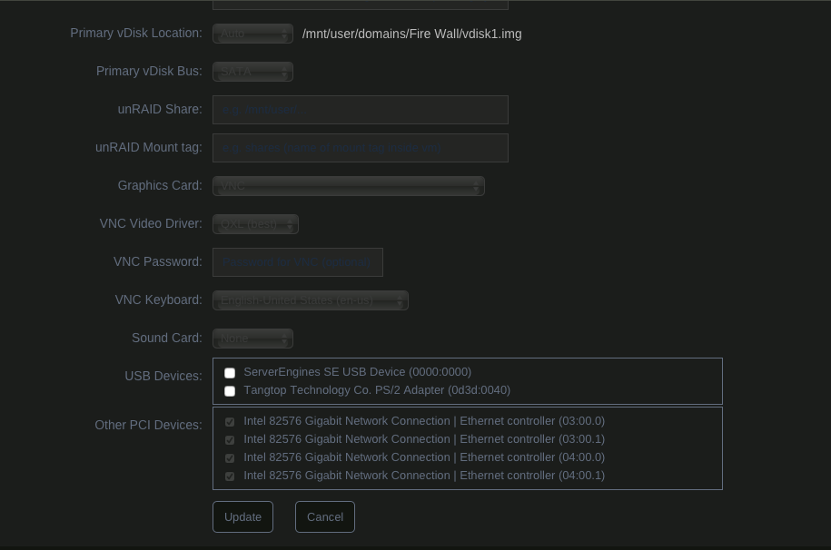

Please Take a snapshot of the gui vm editor
5aaa7063af0d6_ScreenShot2018-03-15at9_06_59AM.png.370e1fda19b511f6197ab21783a2151f.png5aaa706b9b098_ScreenShot2018-03-15at9_07_20AM.png.df88761078368ec73561d7a8ad9edf06.png

Ok, there's something odd going on here....
  1. You have SATA for your vdisk so I tried that - still wouldn't install
  2. Then I spotted you only had 1 vcpu - Eureka - that worked
  3. Then tried virtio for vdisk - didn't work - made sense
  4. Then tried adding 4 vcpus (12,26 and 13/27) like in my vm - didn't work, so I thought I was onto something maybe can't have more than one vcpu at install...
  5. so tried different combos of vcpus - some worked, some didn't initially ....and then suddenly they all worked in any combo
  6. went back to my 4 vcpus from #4 and now they worked......tried again and fine....
Turn on Advance mode and retake a screenshot
Also I suggest making a bridge between physical and pfsense vm, That's how I do it
Edited by Siwat2545
No advance mode in 6.5
and I'd rather not use the bridge in my server. I have it setup using an isolated pcie on purpose.  I'm not the one having problems in this thread.
Each time I did a fresh install.
I've going to copy across my config file to the new VM - will let you know if it stops working at any point
So what is the solution? Using sata instead VirtIO?, and what did you do with the cores to make it work, does it makes any sense?
To me it sounds like an unraid bug @limetech
Virtio is defo a no-no, for the number of vcpus there's something weird going on as the result with the same config wasn't always the same.
