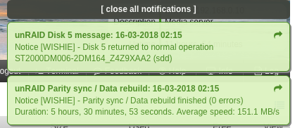

Ok, so rebuild finished, 0 errors. Does this mean I got away with it?!
DId you do the filesystem check?
11 hours ago, johnnie.black said:
run xfs_repair -v when it finishes rebuilding.
