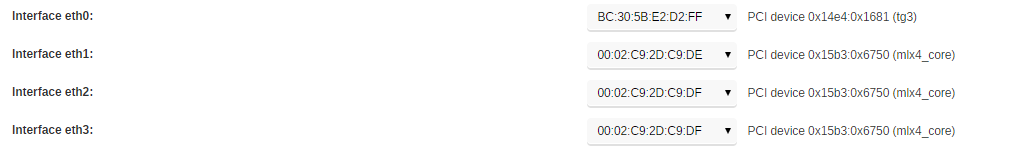

Hello, why in my network settings page the interface is duplicated as eth2 and eth3 but in the list there is no eth2?
As you can see in this screen the mac address are duplicated for eth2 and 3.

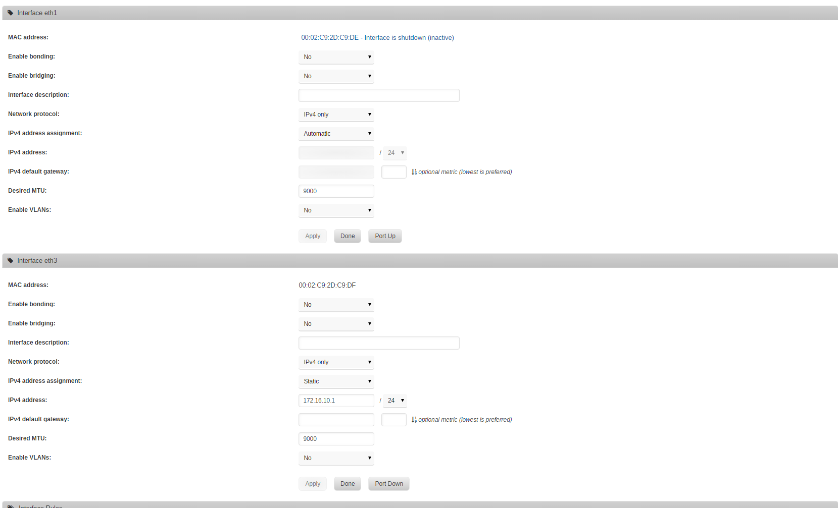

Also why i can't connect to 172.16.10.1 ?
I'm only using port eth3 but the settings looks right to me.
