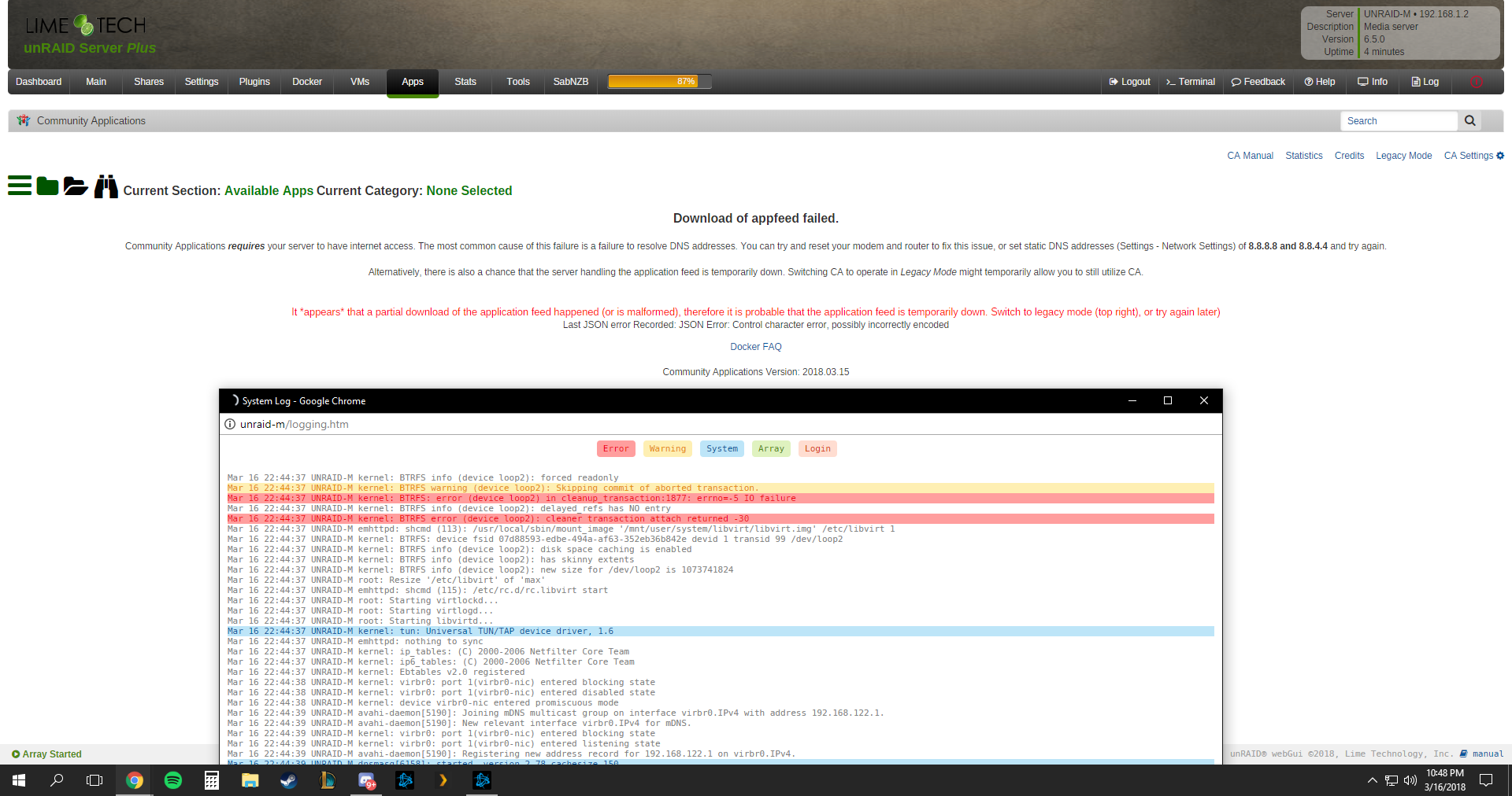

Yesterday(march 15), I was remot'ing in because I had a request to download a TV show. Get in no problem everything seems normal go to dockers and launch sonarr webui. it was having a problem load the show's data at first but its not a popular show so i thought maybe it just wasn't uploaded. click to add series and go to download s1, it's still having issues loading show info. won't dl shows. I get out and everything is weird. try to restart the docker and get a execution fail. other stuff is odd, so I run CA fix common problems, it says something is full and that's some error logging should be shut off, gives me the link to do so. and tells me to run the appdata clean up plugin. I run it and without looking (my mistake) delete my plex appdata file but haven't realized what ive done yet. thinking maybe the remote connection is why things are being wonky. and restart the server. and go home and try to do it. Find out I deleted plex, start a new one. downloads all the movie art and meta data fine. CA fix common problems. gives me a warning about having more than one key in the config, which it never has before. the CA apps page is acting weird and says it doesn't have internet connection. and several other little issues.
Finally try to start downloading the tv show and sabnzb pauses because it says the disk is full. the cache drive is sitting at 53gb of 118gb and I go into maintenance mode and run a check disk and it is on readonly mode. and the parity drive and disk 1 have a smart issue but say it could be lack of power.
Is the ssd in some sort of safe mode or did I just have 3 drives fail at the same time?  is the ssd fixable, bad or do i need to just start over with a fresh install of unraid?

I have this and I have internet access, and the server has two cables running to it. both showing activity. is there a way to fix the drive issue?

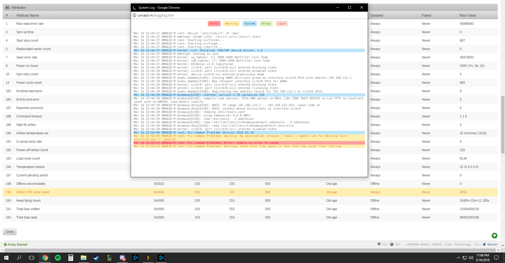

Edited by s_mason16
added second image

Mar 16 22:54:13 UNRAID-M root: Fix Common Problems: Error: Unable to write to cache
/dev/sdb1       112G   51G     0 100% /mnt/cache
Probably because of this ( @johnnie.black ) is the expert on this stuff
Overall:
    Device size:		 111.79GiB
    Device allocated:		 111.79GiB
The problems with docker may or may not be related to this (and it appears that there is an issue with the image for it), but until the cache problem gets rectified, there's no point in trying to fix the docker problems.   Incidentally, since the docker image is messed up, it doesn't look like the service is running, so when you ran cleanup appdata, it recognized that nothing was installed, therefore it offered up (and you accepted) to delete the appdata for Plex.

That's what fcp was telling me. tbh on nearly the best case im just hoping it was an ssd failure. because then just a replacement ssd and at this point ill probably just start with a fresh install either way. (poor sonarr/radarr/sabnzb settings wahh). but that doesn't exactly explain the smart test 199 crc error on drive 0 and 1. but if its not the ssd then it's a long track down the issue game. or a malfunction with a different hardware piece. or if it was just a software/os error, the fresh install will resolve it, but will my configuration just make it happen again?
The 8 CRC errors on the parity drive is nothing to worry about.  The 4000 on disk 1 (over 5300 power on hours) is.  This is a cabling / connection problem.  reseat the cables.  You never saw them before because it was only monitored starting in 6.5
