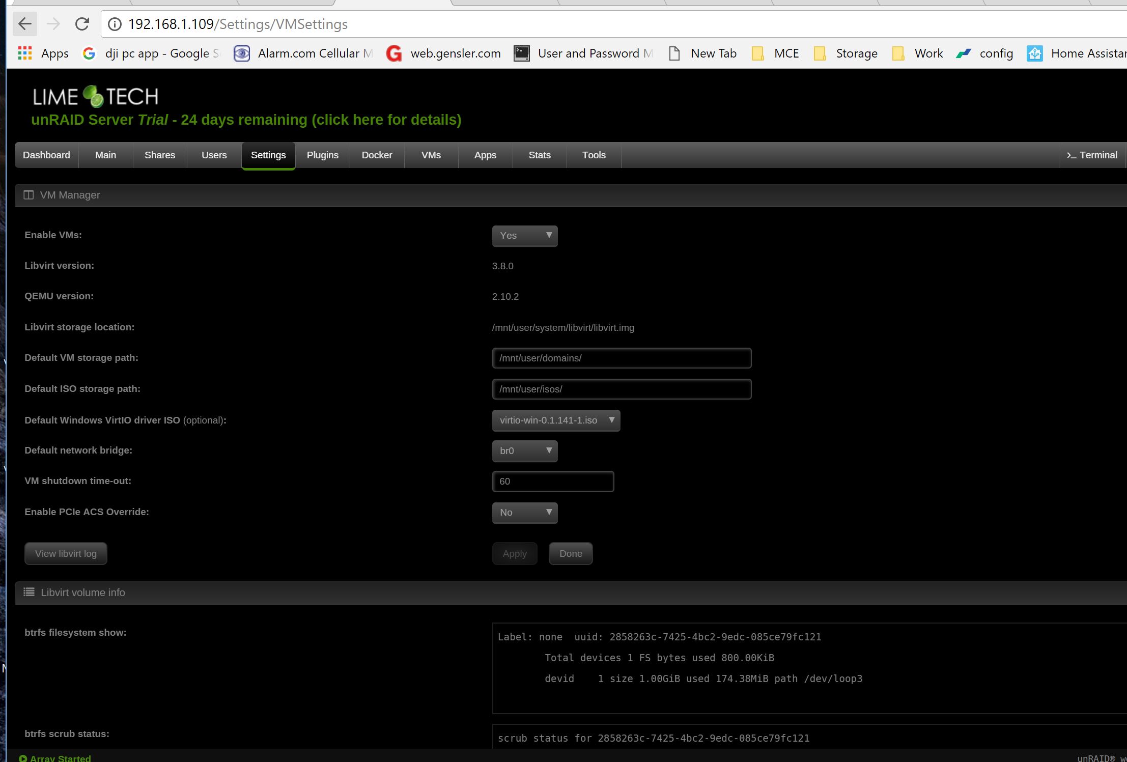

I have a single nic system that i have configured bridging mode on for my vm's.

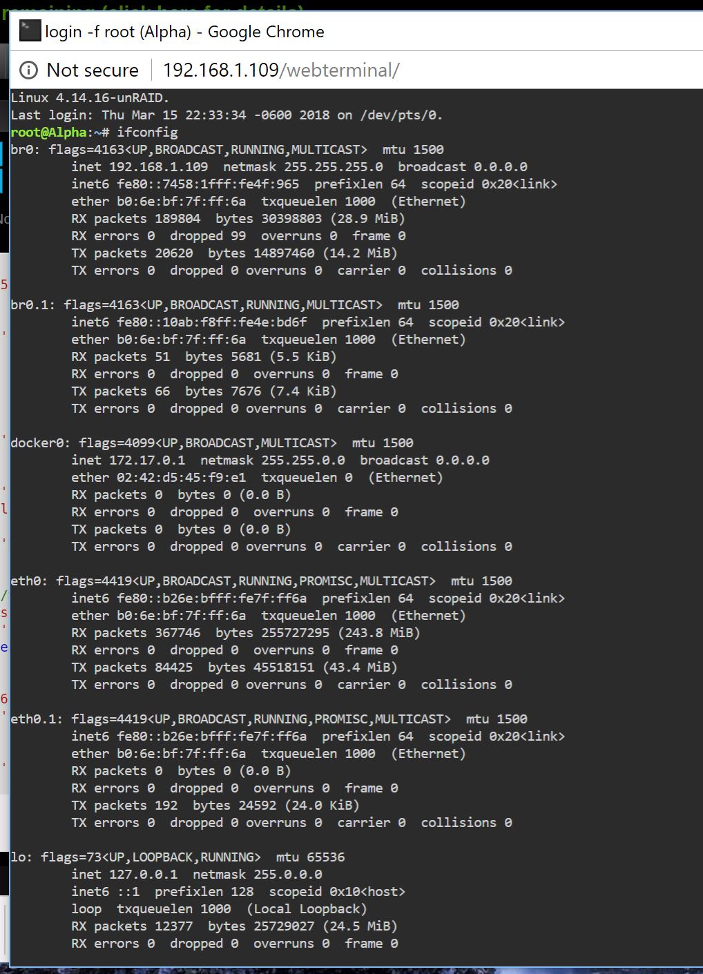

When i boot the vm i cannot get a conenction to the network. I cant get a ip from dhcp and a manual ip does no good either.  I did an ifconfig and ensured br0 was up. Rebuilt the vm a couple times, tried a linux vm same thing.

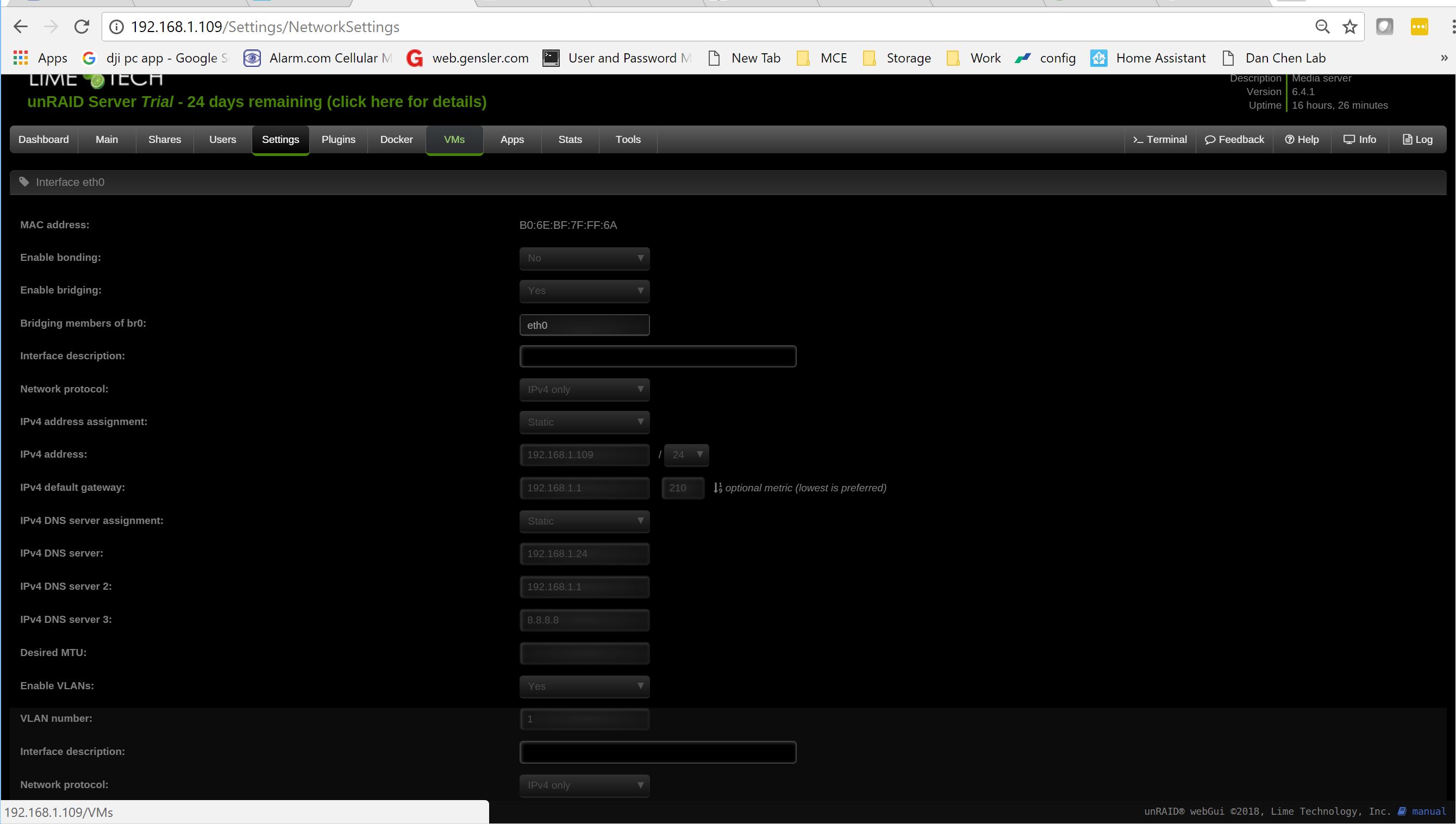

Do you need VLANs?
If no, then set "Enable VLANs" to NO.
If yes, then change the VLAN number 1 to 2 or higher (1 is considered the default VLAN and will interfere with the untagged traffic of br0).
I tried enabling vlans as a test it didnt help
