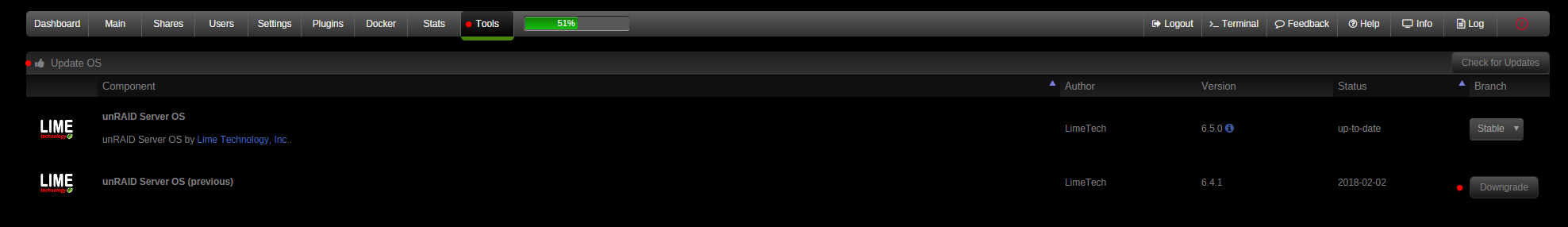

As for the downgrading when i returned to the update os selection through the GUI i noticed that there was now an option to revert to my previous version, however I am unsure if the same will result with 6.3.5 but its worth checking
