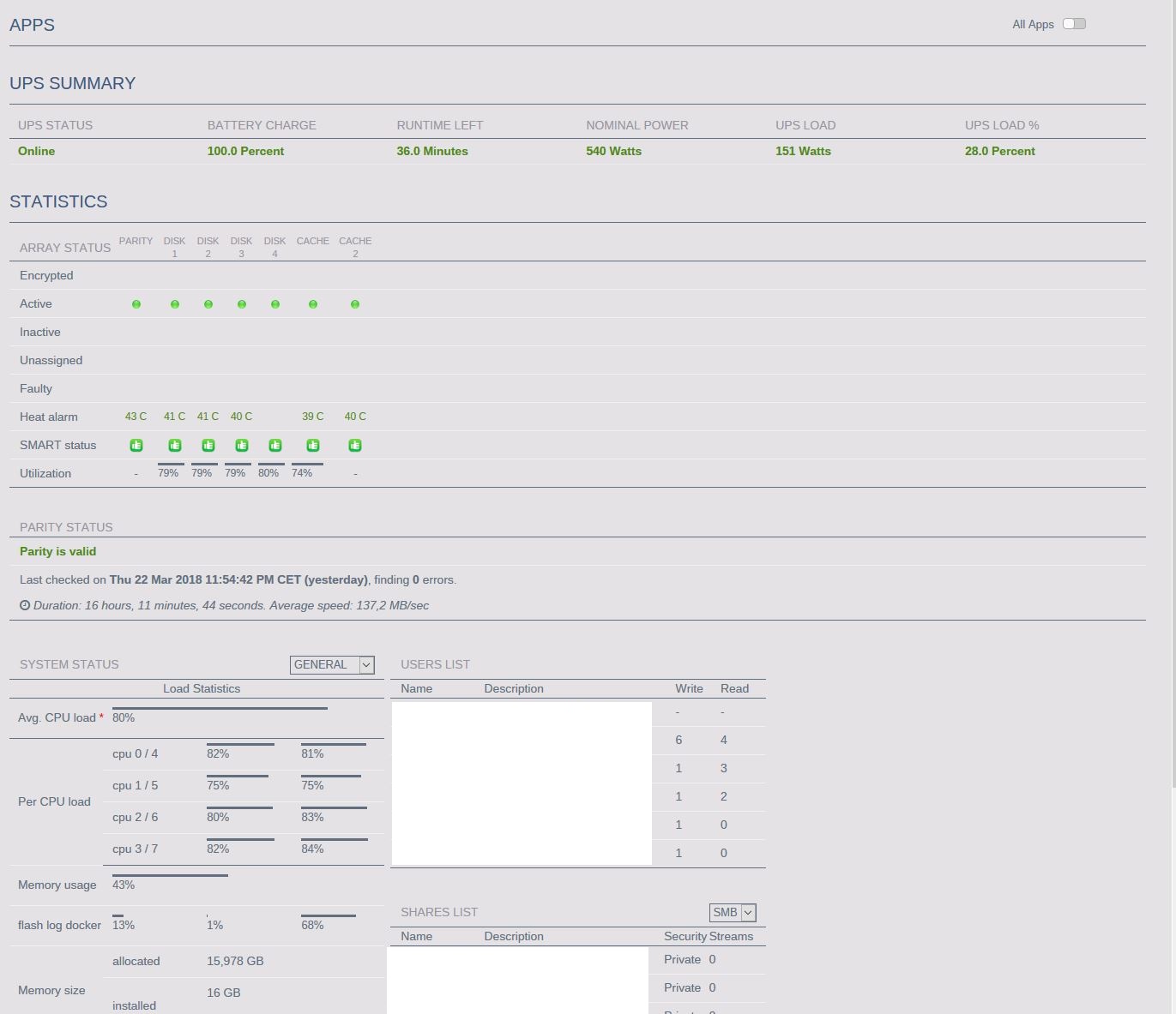

9 minutes ago, rix said:
My Dashboard still locks up (though less frequently so), so I guess some tcp-related error from any of my running docker containers is "able" to crash the whole thing.
When you stop all containers. Does the Dashboard still hangs?
8 minutes ago, rix said:
Its really all about not being displayed in the frontend.
The frontend calls the docker service to obtain status information. It seems the docker service itself gets stuck. I have no clue why, because I can't recreate this on any of my systems.
Hence my question if you stop all containers from running, do you experience still the same issue?
