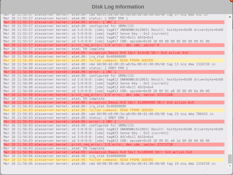

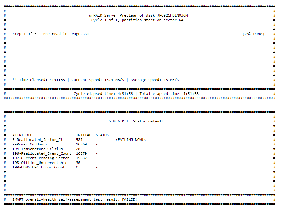

For clarity, I do have that hacked version of preclear working away on a 1tb drive, but its grinding down to a halt at 13MB/s now on only 23%, and the errors are rolling in thick and fast.  So I presume that drive is toast (things probably got tossed around way more than they should have in that move?), or the preclear script is broken, how do I know or trust?
Just after posting this, the preclear script has paused too, so maybe its the drive I guess? :)

Preclear seems to be showing the first drive i put in it to be a lemon, which might very well be the case but because its unsupported I came here to check there wasnt a better way, as i said, i dont want to waste the week to find out preclear isnt really working properly....

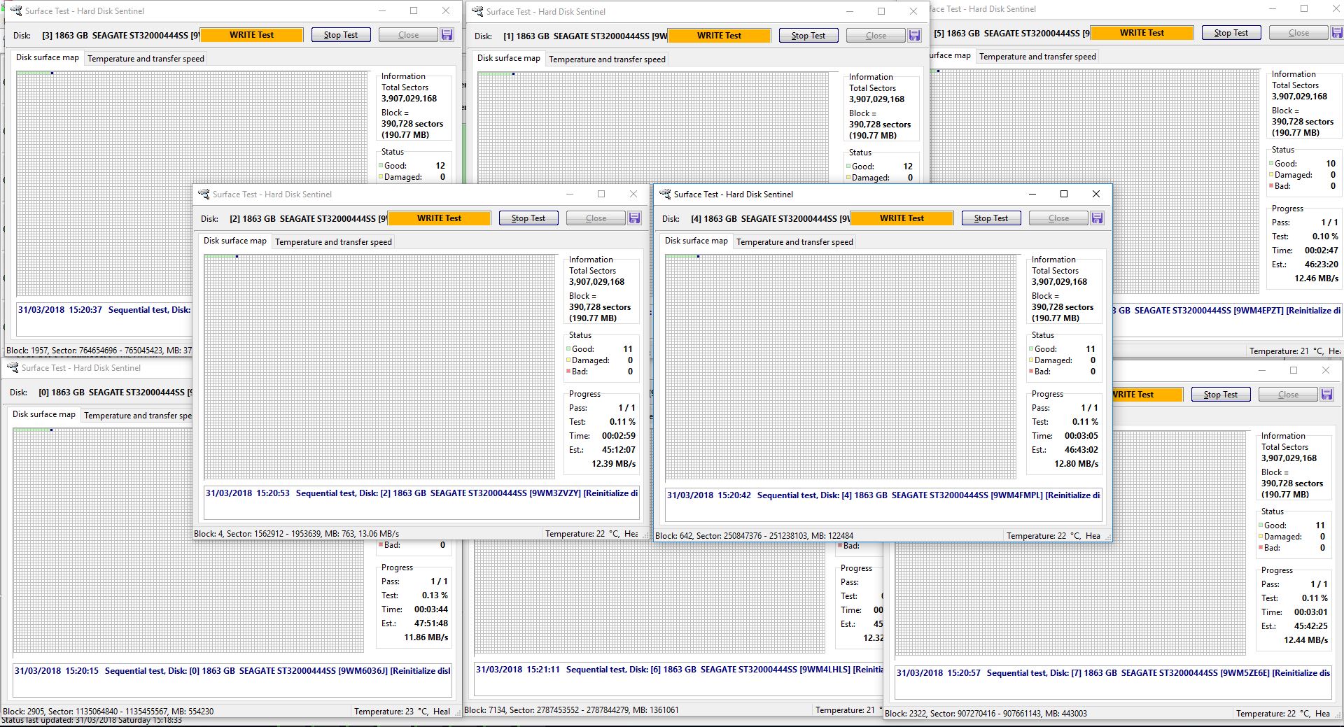

HDSentinal does exactly what i'm after, purchased, and can queue up loads of drives, give stats/data, and everything after it's finished.  In case anyone else looking for a solution to my specific problem.
Surface tests can be desructive with read - write - read etc... too, meaning I get a real overall view of everything.
This may not be for everyone but as i said, I want to set this going and leave it,and come back with results.  The software has already paid for itself in this case.  Shame preclear wasn't working quite right.

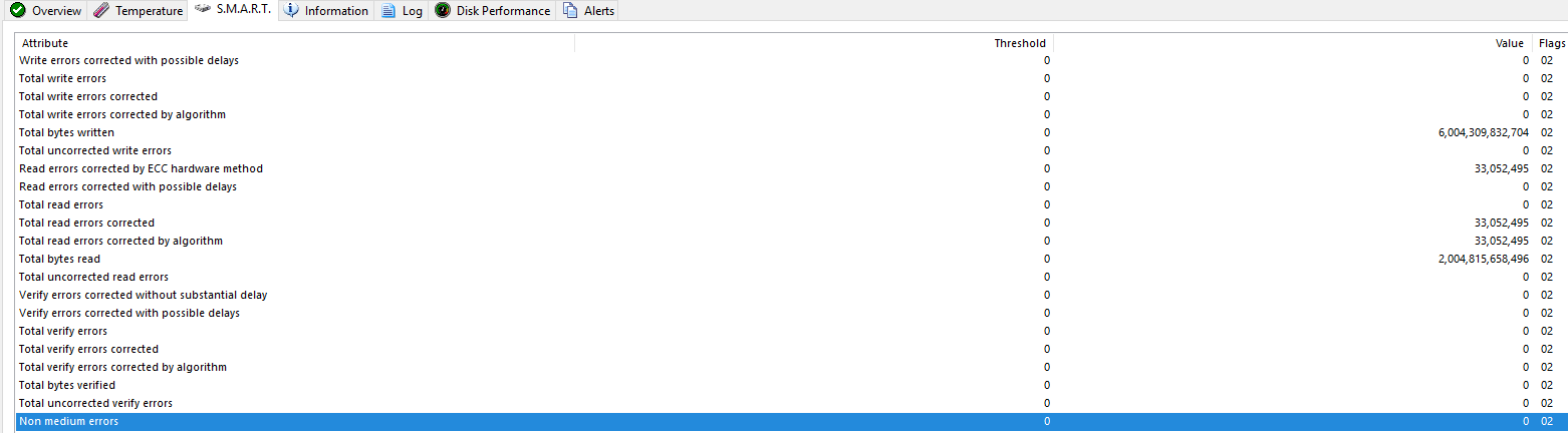

One hard disk is already looking totally paperweight worthy.  The rest seem great :)
Reports.zip In case anyone is interested, although i doubt it really.  These are some i remembered to save as i went along, every drive was reinitialised.  I still have to test 8 2tb SAS drives, but the card is being used in my server, so I'm unwilling to turn it all off right now, or play around using it to check over those.  I really like the software :).
So the real bulk are still outstanding, and as predicted, a lot just need to be thrown away.  Some golden 500gb gems though, of which I have no idea yet what I can actually do with.  But they're in perfect condition (for age) and very little spin time as predicted.

Here's the big test, I'm reinitializing and surface testing them all, I have noticed that Pre Clear got the all clear for 6.5.  but since i've tested all the other drives with HD Sentinel and since it gives a html report, and i had to mess around earlier this week to switch the SAS card around, i'm now sticking with HD sentinel.
