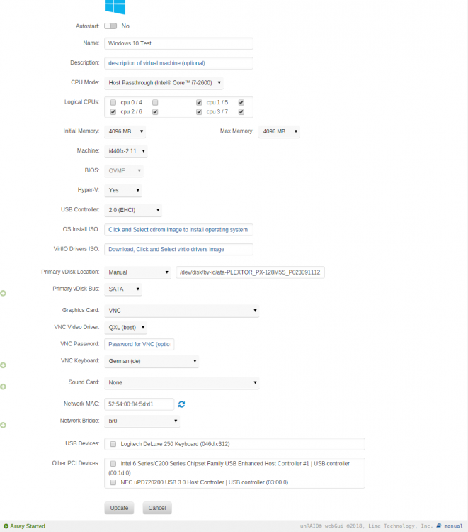

i have a problem after updating Unraid 6.3 to 6.5.
My Windows 10 VM won't start anymore from the separate SSD.

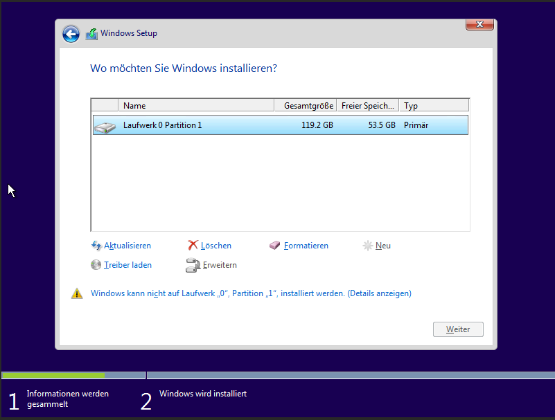

It doesn't boot. I started the VM with a Win10 Install ISO to check if the VM can see the SSD. An yes, it shows up correctly in Windows Setup. But when i restart the VM without the install ISO it shows only the black screen with white and yellow text (see attachment).
What could be the problem here?

For whatever reason, the UEFI virtual bios can't find your boot device. See this post here:
