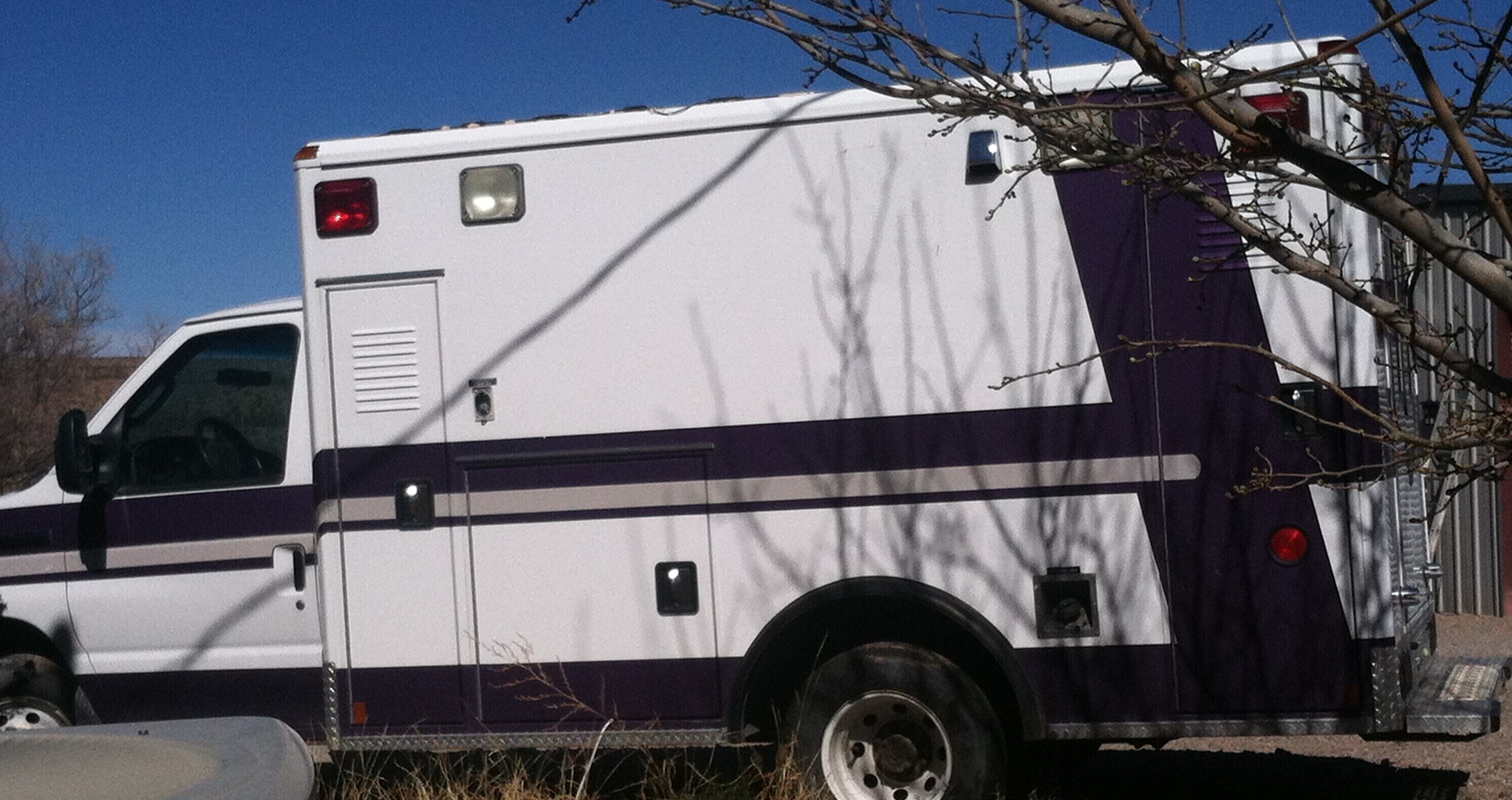

I think you hit it on the nose.  For short term (1 day maybe 2) emergency power, I'm set.  Longer than that, and I should indeed skedaddle.  I had intended  setting the ambulance up as a camper for long term, middle of nowhere camping but not long after I bought it and started the project my health took a major turn to the point where I can't even get into the darn thing now.  (I now have a van with a wheelchair lift to make me mobile again)
ITs too bad, the ambulance is nothing short of awesome.  (diesel, electrical already run, so adding the solar was easy enough, tons of storage, already has cabinets etc built in)  Perhaps it'd make sense to shift the solar to the van so that I can get back on track as far as camping goes. Not nearly as much space for panels though.  (there is room for about 6 more panels on the ambulance roof)
Time to consider a "for real" solar system now I guess. (grid tie/hybrid) so that I still have my battery bank for emergencies.
Guess its time also to think about selling the ambulance.  No sense having a vehicle I can't drive any more.

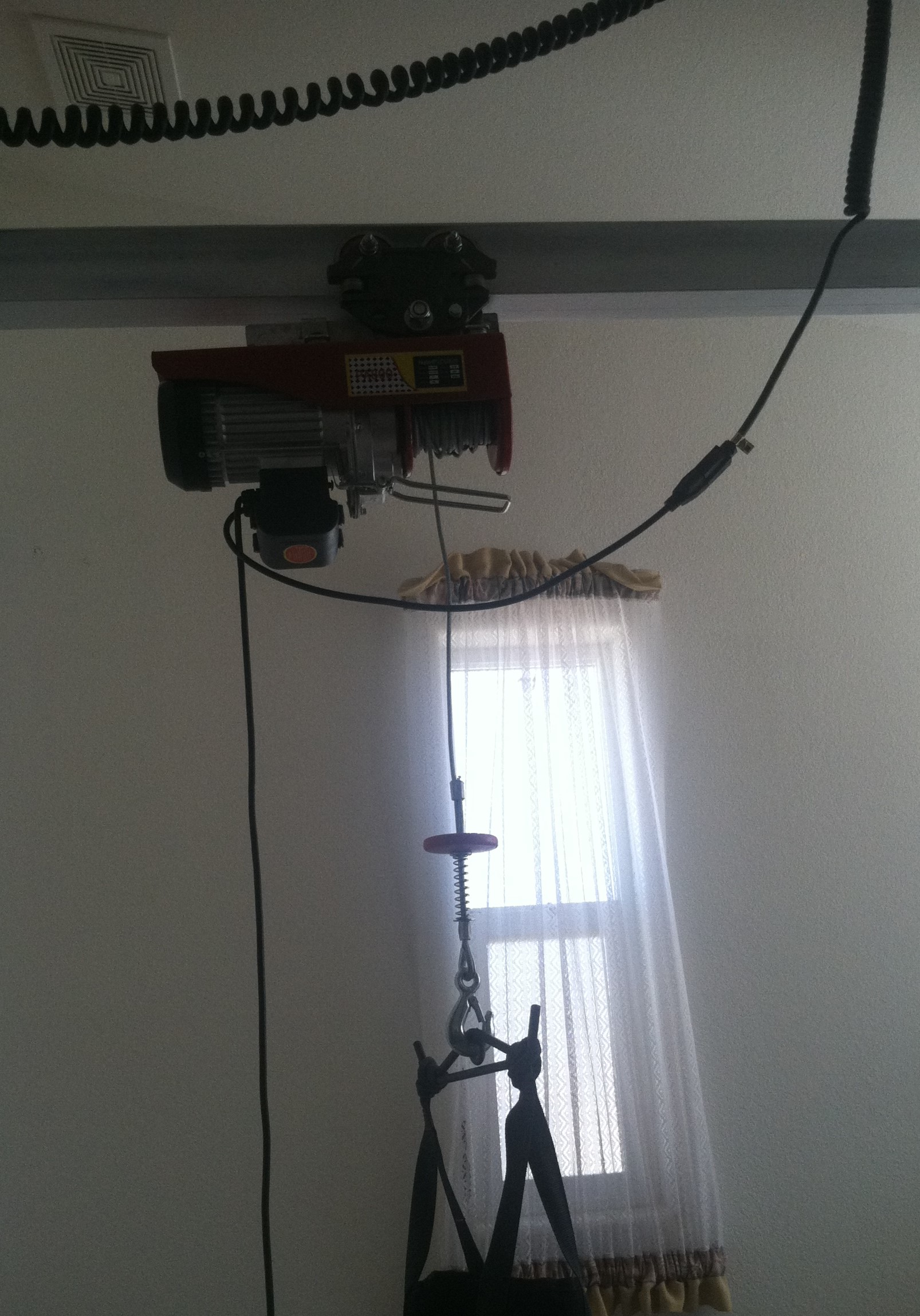

On the subject of the ambulance, cost would be prohibitive.  The pass through to the drivers side is small, so I'd have to figure out how to get to and from the drivers seat, and then I'd have to have a lift to get the chair in and out.  My f250 van has a lift and a 6 way seat making transfers easy.  Though I don't need them yet, it also has hand controls.  The van is old, but it works far better than the car I had that I could no longer use.  I had reached the point where I only got out of the house about 3 times in a 6 month period.  Not a fun situation. (thankfully I have good people in my life that help out)
We're usually pretty good at finding answers to problems. The most recent being an inability to do tub transfers. (yes we're getting WAY off the unRaid topic here..)  After researching lifts/tracks etc through medical supply shops, the answer I would need to solve the problem was going to run around 6k before install costs. (And no, they wont just sell you parts, they insist on installing.)     Instead, we rolled our own solution.  A small ibeam track, heavy duty trolly, and hoist, with a harness I made myself.  Installed the thing ended up costing around 800 for everything, with the added benefit that if I need to, I can change out a car engine in my bathroom if need be. In fact, I used the lift to get my z800 from floor level onto a spare wheeled walker, then used the walker to get the thing into its final position.
While I wouldn't call it "fun", but knowing where i'm headed as far as ability goes, it is definitely interesting to plan ahead as much as I can so that I can manage as much as possible on my own for as long as possible. (on my own, but with help to figure things out and implement solutions)
I'm attaching a picture of our home grown ceiling lift and the ambulance, in case anyone is curious.
