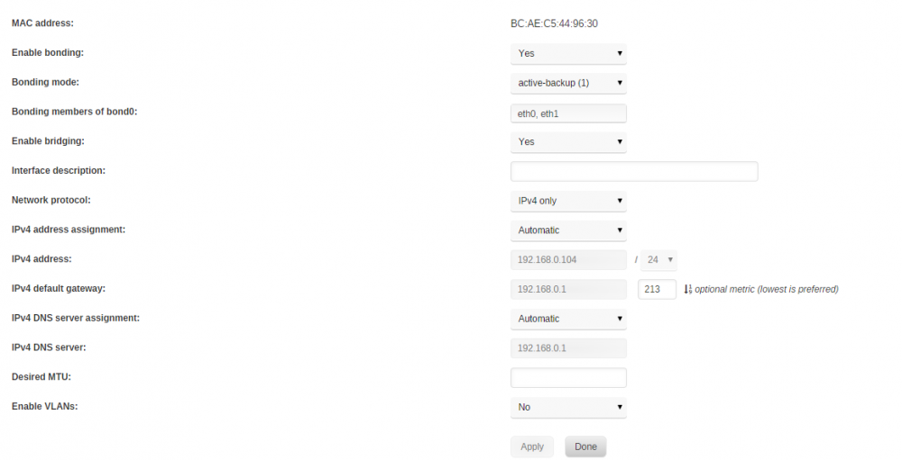

Manually mapping the drive still does not work. I believe I am a little over my head. Now it doesn't show up on the computer I didn't have issues with before. I believe the server is public on my network in my house. I am trying to find it just through file explorer or mapping it as a network location.
My PC Info:
Windows 10 Pro
Version 1709
OS Build 16299.309
nottower-diagnostics-20180402-1914.zip
