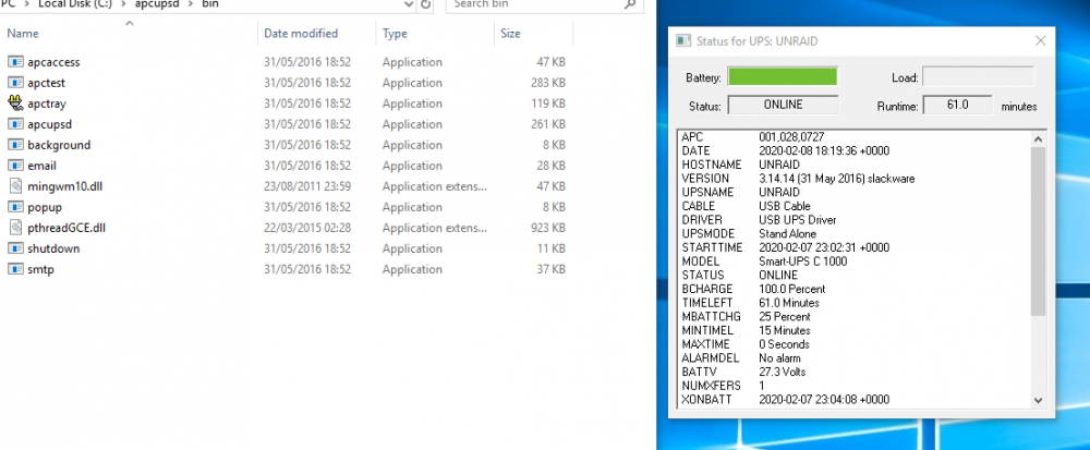

I have an APC UPS connected via USB to unraid and configured to shut down unraid in the event of a power cut but the problem i'm having is getting the W10 VM to shut down before unraid shuts it down
I have downloaded and installed Apcupsd but when i try to run the program it just quickly flashes on the screen and disappears, I can go to the program folder and run the Apctray then using the unraid ip get the ups status
What am I doing wrong as I can not see anywhere to configure the shutdown time for the VM?
In the Apcupsd start menu folder there should be an item "Edit configuration file"
ah ok yes found the file, will I get a gui after I edit the config file or does it just run in the background?
It just runs in the background, you use the status icon in the taskbar to see what it's doing.
