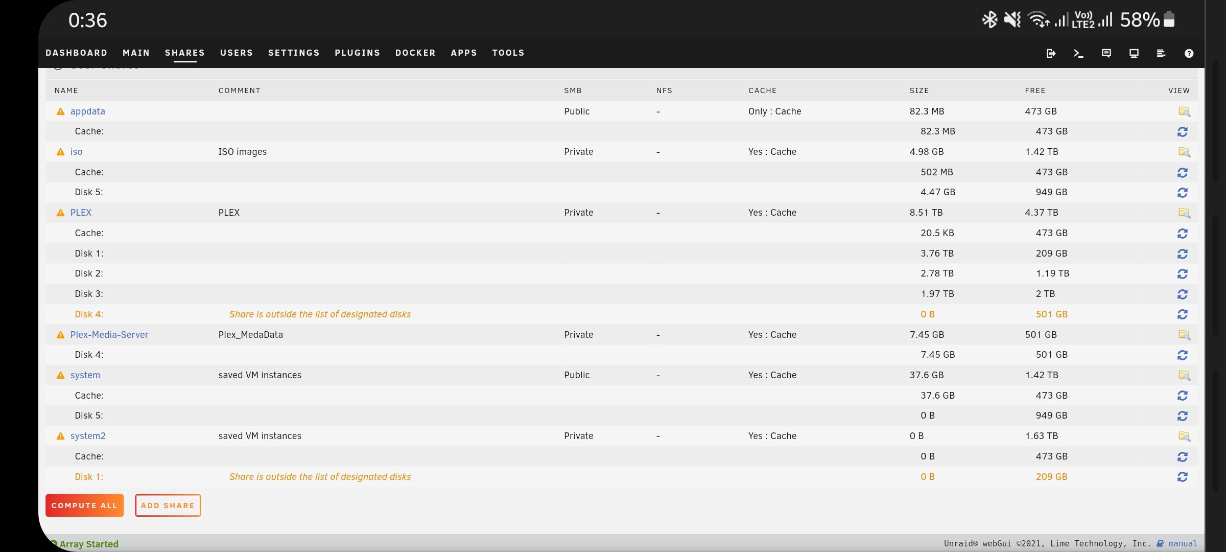

February 27, 20224 yr Community Expert NVM I see you are talking about the 0B folder. Do you know how to work directly with the disks?
February 27, 20224 yr 26 minutes ago, trurl said: Do you know how to work directly with the disks? I don't understand much about this question I don't want disk4 to be in the PLEX folder. I only want the 1,2,3 disk there. Disk4 is ssd and there is only metadata from PLEX.
February 27, 20224 yr Community Expert 1 hour ago, StefanikM said: Disk4 is ssd Do you know that SSDs in the array can't be trimmed? And can't be written any faster than parity? You can get rid of that empty PLEX folder on disk4 from the command line rmdir /mnt/disk4/PLEX
February 27, 20224 yr 8 hours ago, trurl said: Do you know that SSDs in the array can't be trimmed? And can't be written any faster than parity? Yes I know about that and that's why I wanted to go through disk4. I don't know how, but I accidentally added disk4 when creating the PLEX folder. 8 hours ago, trurl said: rmdir /mnt/disk4/PLEX Awesome. This worked perfectly. Thank you very much.
