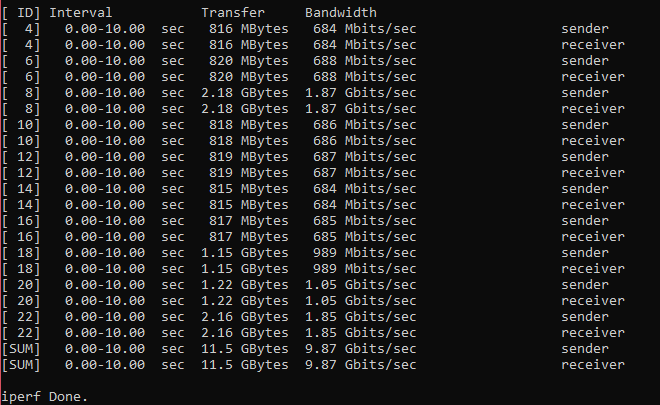

So I have 10gb NIC in unRAID server to a Dell x1052 switch connected with DAC cable.  From switch to my PC with Intel x520 NIC via fiber OM2 cable.
Here is what I got.
8 hours ago, rmilyard said:
Here is what I got.
You have plenty of network capacity :)
Here is what I got.
OK, so now I am jealous.  Looks like a fast network!
