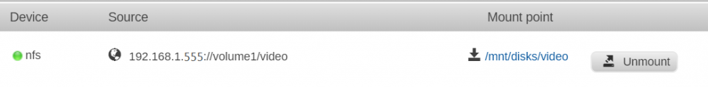

-Back to UnRaid --> mount NFS/SMB --> mounted:

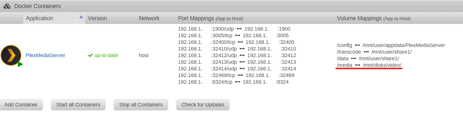

-Added new path to Docker option:
and resulting config of docker:

Looks like you have done your homework but just to make sure, post your docker run command as seen at the 1st link in Docker FAQ.
Thank you for reply, I'll post asap this evening when I go back home from work.
I did it!
It was a problem with shared folder permission in Sinology.
Work like a charme!
