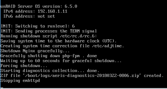

  • The next reboot will hang on "stopping emhttpd" and never reboot. SSHing in and typing reboot will force the reboot.
