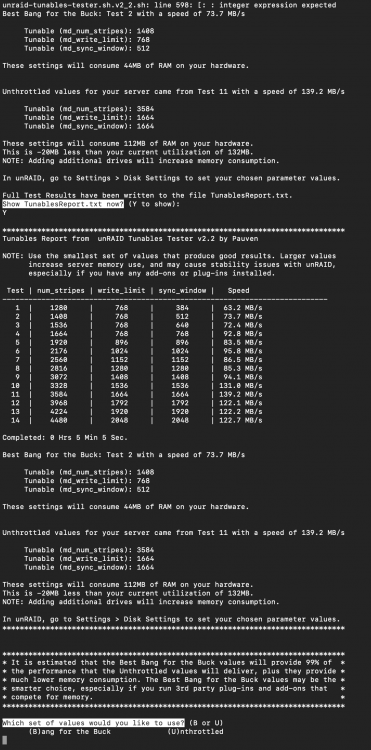

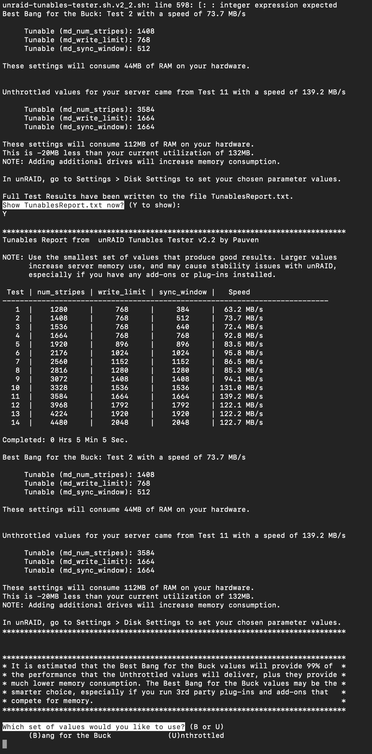

Hey unRAIDers!!

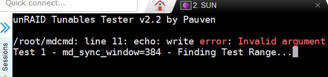

So, it's now, 2020; can anyone offer any advice as to whether or not the tunables script is to be trusted on unRAID v6.8.3? I was able to get the update from the link that @Squid provided working via cli (sort of) with errors; thanks to the post from @Marshalleq (example below):
/usr/local/sbin/mdcmd: line 11: echo: write error: Invalid argument
Test 1   - md_sync_window=384  - Completed in 601.464 seconds =  96.6 MB/s
The final "Best Bang for the Buck" results show the following...
On my production box (Supermicro [I suspect either] AOC-USAS-L8i, [or] AOC-USASLP-L8i)
          Current in disk.cfg   |      New Setting
     md_num_stripes="4096"  | md_num_stripes="1536"
     md_write_limit=""  | md_write_limit="768"
     md_sync_window=""  | md_sync_window="640"
     Not Saved. Exiting.

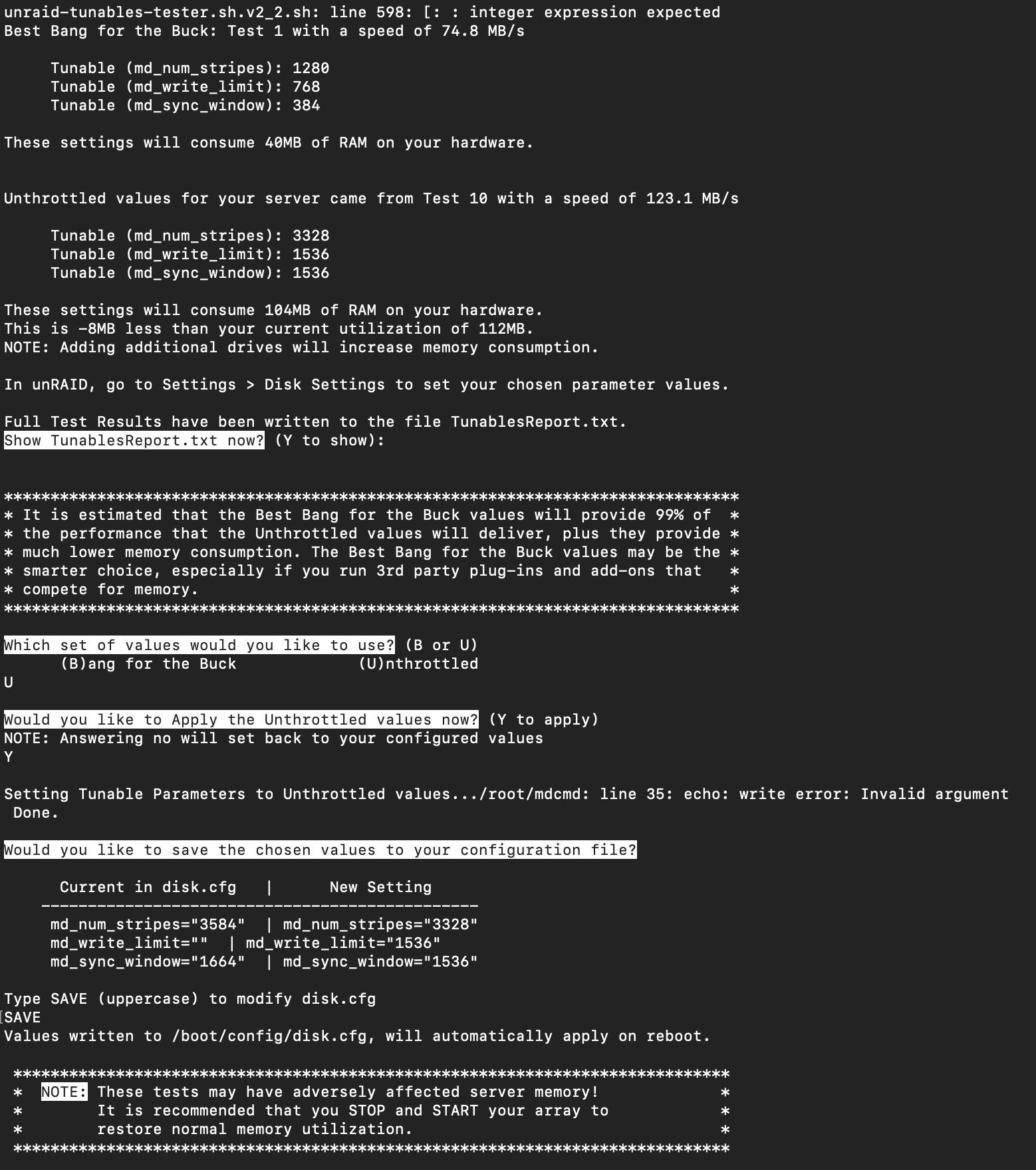

and my backup box (2 Dell H310s):
     md_num_stripes="4096"  | md_num_stripes="1280"
     md_sync_window=""  | md_sync_window="384"
Type SAVE (uppercase) to modify disk.cfg
Not Saved. Exiting.
Any input, thoughts, etc. are much appreciated!! I feel like this is a message in a bottle, but I hope someone will respond soon. :) Thanks in advance!
No, v6.8.x uses a different engine, and it should mostly auto-tune, though there are some known issues for very large arrays, usually with 24+ devices.
@johnnie.black Thanks for the quick reply! I'll set all values to default then... fwiw, I'm running 20 drives in the array (incl. dual parity), also raid 1 cache on my production box and a few devices outside the array, so it sounds like I might be pushing it? Lemmie know. Thanks!!
