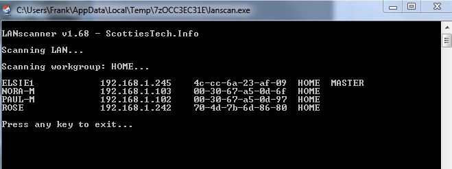

 are puzzling me as you should have gotten an output that looked like this:
Did you run it from a computer where you can see the other computers on the network?

Yeah that's what's so bizarre. On another forum I found a command "net view [ip address or hostname]" and I get error 53 when trying my unraid server, but I'll get a list of SMB shares if I try it with my windows machine IP. I also just reverted to 6.4.1 and it didn't fix the problem.

That LAN Scanner utility does say this on their site:
UPDATE (30 Jan 2018): ** LAN Scanner no longer works on Windows 10 1709 and above. **
That is an important clue!!!!!   Read this:
