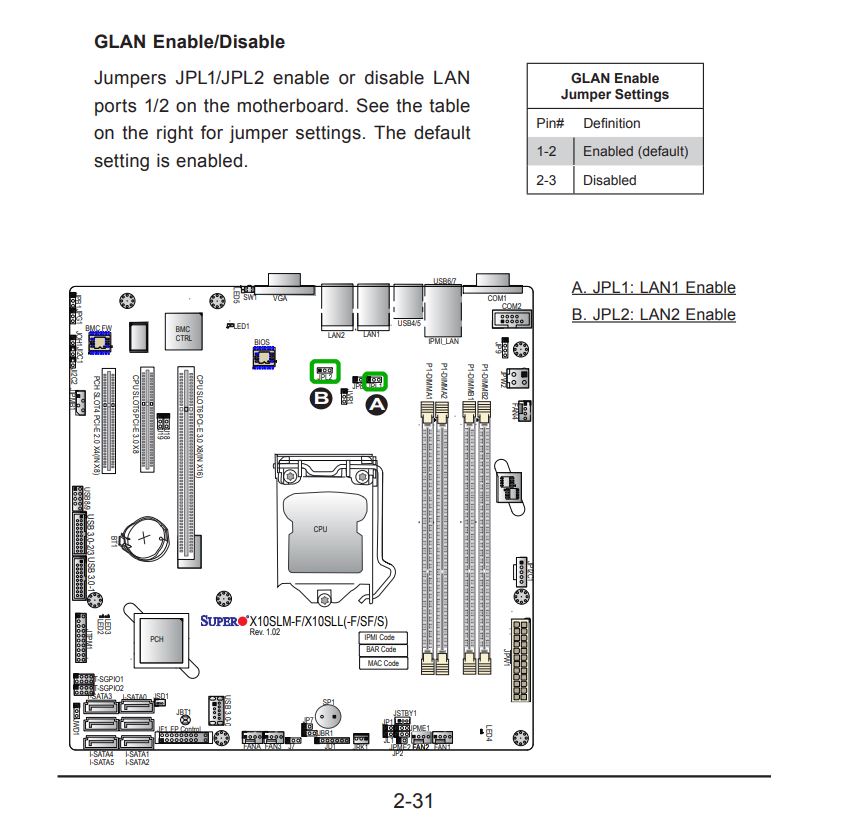

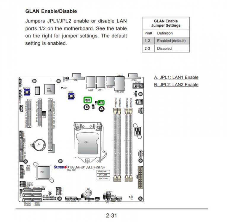

Now if you are saying your LAN ports are not working you will need to check your Jumper settings.
https://www.supermicro.com/manuals/motherboard/C222/MNL-1428.pdf

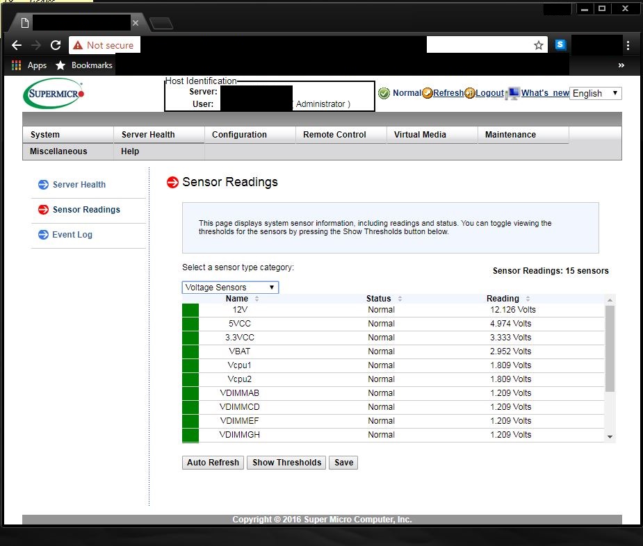

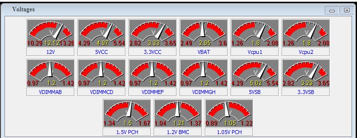

If you log into the IPMI via the IPMIView20 OR the website. It will tell you your Voltages and will say if its out of tolerance. Please see pictures for reference.
