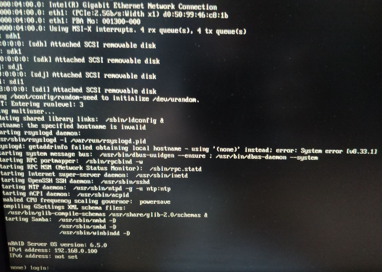

Boot log picture can be found in the attachment. (Along with a quick Putty screenshot)

Your hostname contains invalid characters for NETBIOS. This has worked in the past even though it was invalid, but it causes problems in 6.5.0.
More info here:
It has a single underscore (_) in it, other than that, just letters. (Unimatrix_Zero)
If the underscore is an invalid character, how can/should I change it?

Since the webgui isn't available, you'll have to edit a file directly.  See the "Solutions to Common Problems" section of that post for details.
Thanks! That fixed the issue.
Too bad we can't use a underscore anymore, but it's probably for good reasons. (NETBIOS wise)
